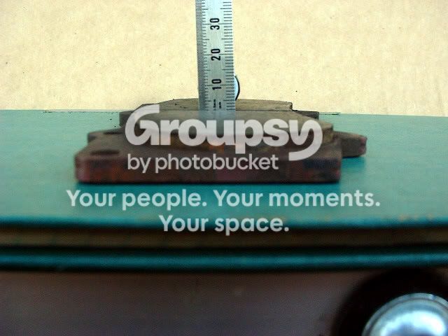

I replaced mine at 2mm as you can see from below.
