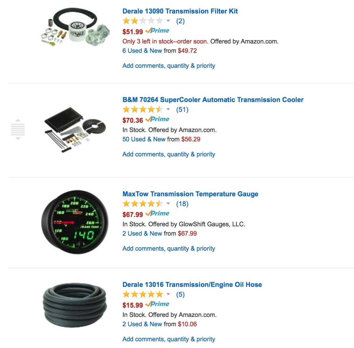

Thanks everyone! Here is my plan with one more question.
1. B&M 70264 SuperCooler Automatic Transmission
2. "mount it up against the condenser in front of the fan."
3. ? I like the look of this Filter + Guage kit. Thoughts ?
Derale 13091 Transmission Filter Kit
http://www.amazon.com/gp/product/B004XONO2A/ref=ox_sc_act_title_2?ie=UTF8&psc=1&smid=ATVPDKIKX0DER
4. And this sounds great but maybe a next year thing...
"Tundra 199mm brakes"
I think this will do it....
Hey, again, thanks to the community for all the advice. Attached is what I think I'm going to go with unless you see some glaring mistake.
I'll take it all to my brothers shop along with a lot of SCOTCH. :thumb3:
I would buy a Scanguage ll (pretty sure it has trans temp readings for your '02 but double check) and just run a Magnefine trans filter. Go with the Tru cool 4544, my B&M 70268 is NOT up to task here in Denver. I can't even run in 4Hi when it is below zero! Will be swapping for a 4544 very soon.
