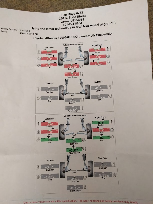

I took my 2005 4runner to Pep Boys to get an alignment after my lift and they weren't able to fully adjust my camber in the front because the bolts are too rusty apparently. They said that could adjust them if I got the four bolts replaced.
This is the alignment paper they gave me after showing the results.
It looks like front passenger tire got even worse after they touched it.

Rock auto for the greasable Moog replacements or OEM options at the local dealer or online.
no the moogs are not a good choice for the LCA. the rear bolt causes slop in the bushing and frame allowing the arm to move around and clank. the best bet is to get a new set of OEM.
First off, good luck on the replacement of the bolts, this is going to be a full weekend activity if yours are anything like mine were. The Caster and camber bolts are seized to the bushings. The bushings have an inner steel sleeve and your bolts have literally 'welded' themselves with rust to the bushing. If I had to guess you will want to purchase all the OEM bushings as well. I was not able to salvage them. Had to use a cut off wheel on the caster and camber bolts to get the LCA to drop. Mind you, you may be lucky and they could come out with ease...doubtful though.
