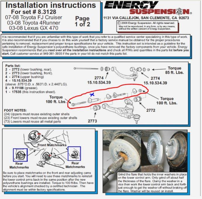

Am I missing something, or is the bolt/sleeve that I labeled with the blue X only on one side of the LCA?
I'm going be installing new cam bolts since they seized and decided to do new LCAs as well. So I need to verify if the cam bolts are all that I need since the control arms come with the bushings installed.

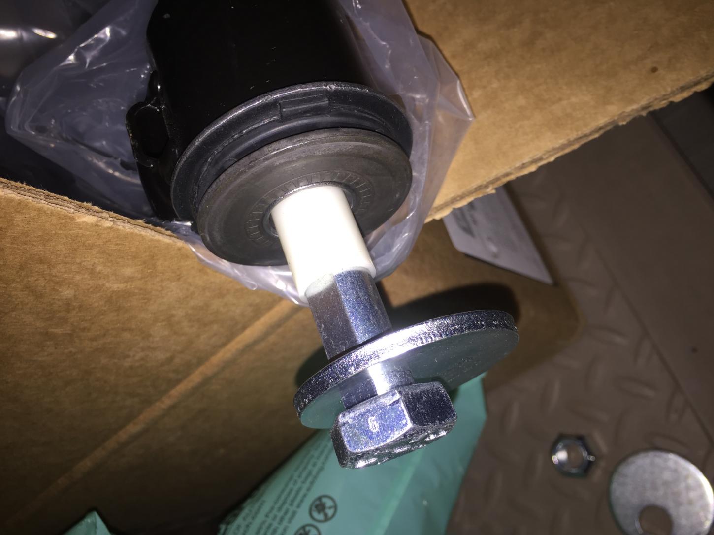

So can you tell me what the part is that I marked with a blue X in my picture above is? I just got my replacement SPC cam bolts and there's no sleeve looking part like that. Here's a pic of them in the new LCAs that are getting installed. There's no way in hell that white plastic tube they came in is supposed to be installed. But it does show how much space there is in the control arm end.
That's the cam portion of the cam bolt assembly;probably the most important piece of everything in that image. The bolt is used to guarantee the clamp load... to hold the control arm to the frame, the cam (marked with the X) is the part that allows one to change the position on the control arm relative to the frame for alignment.
There are two of them, one for each frame mounting point.
Thanks...turns out the set I got was Fake News and incorrectly listed. I got a new set from the dealer for all parts involved. Here's the other thread where I explained.
