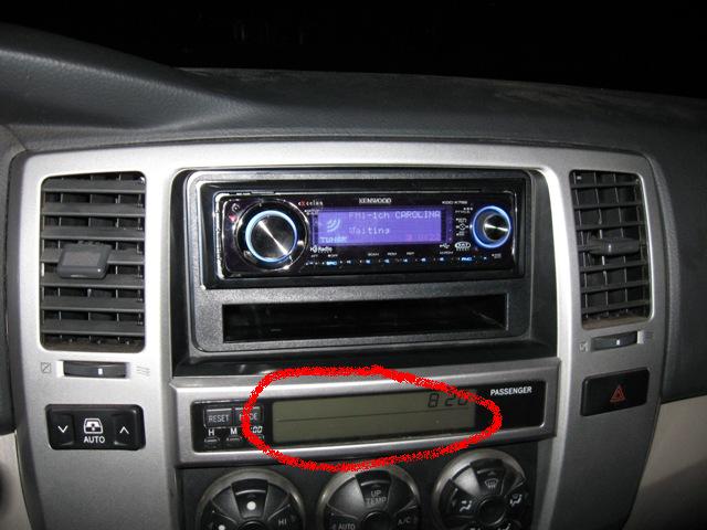

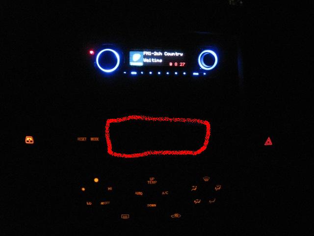

where can i get the led's that light up the clock on my dash??
4Runner8
mine burned out and i need to replace. where besides toyota could i get some new ones and possibly blue ones? :)
help please! Thanks, will.

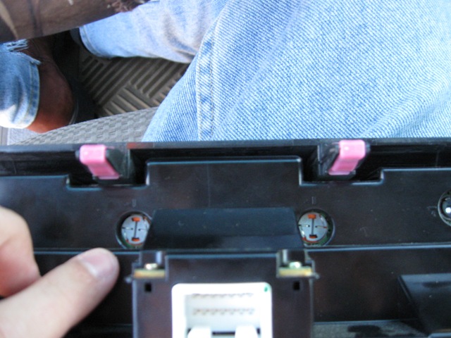

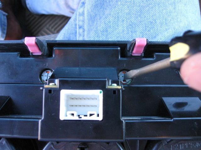

well someone needs to find that forum. and i think all you have to do to replace is take a flat head and screw out the olds and srew in the news?? not sure thought but i took a look and thats what ppl say to do

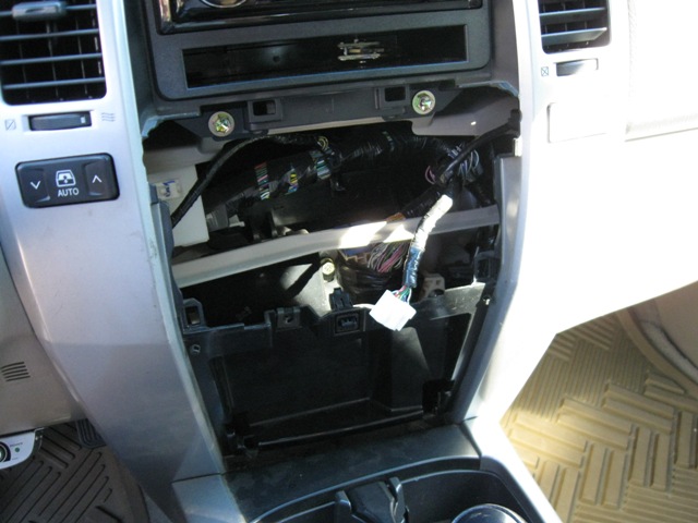

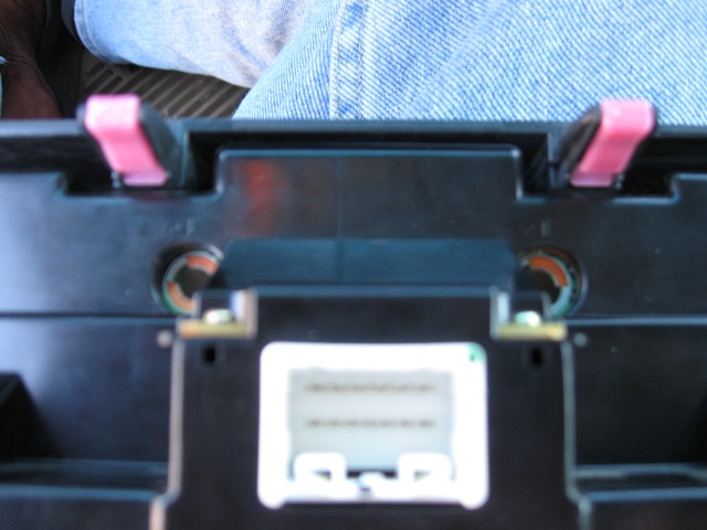

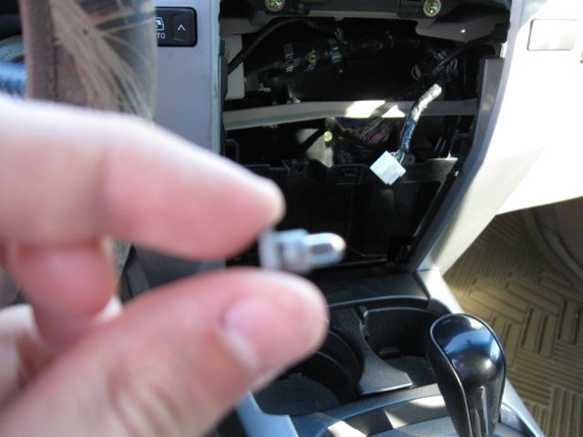

so i just ordered the lights for it. i got em in blue. not bad for a buck 29 each here are pics of how to do it i was just fiddling with it... hope this helps ill out pics of final product when i get em...
