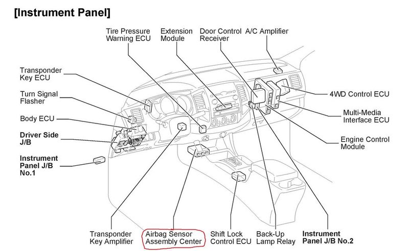

The SRS ECU is located ontop of the transmission tunnel under in front of the center console (basically tucked under your center stack area where you have HVAC controls and such.
I bought it wrecked and fixing it. The air bag module is behind the a/c heat controls? I had a guy said he thought it was under center console. If I hook battery back up before module is reset will it deploy the new bags?
airbag-sensor-assemble-center-jpg.224865
That's roughly where it's located on the 4Runners.
It shouldn't set the airbags off, but it won't work because the unit will have fault codes in it (at least it should).
