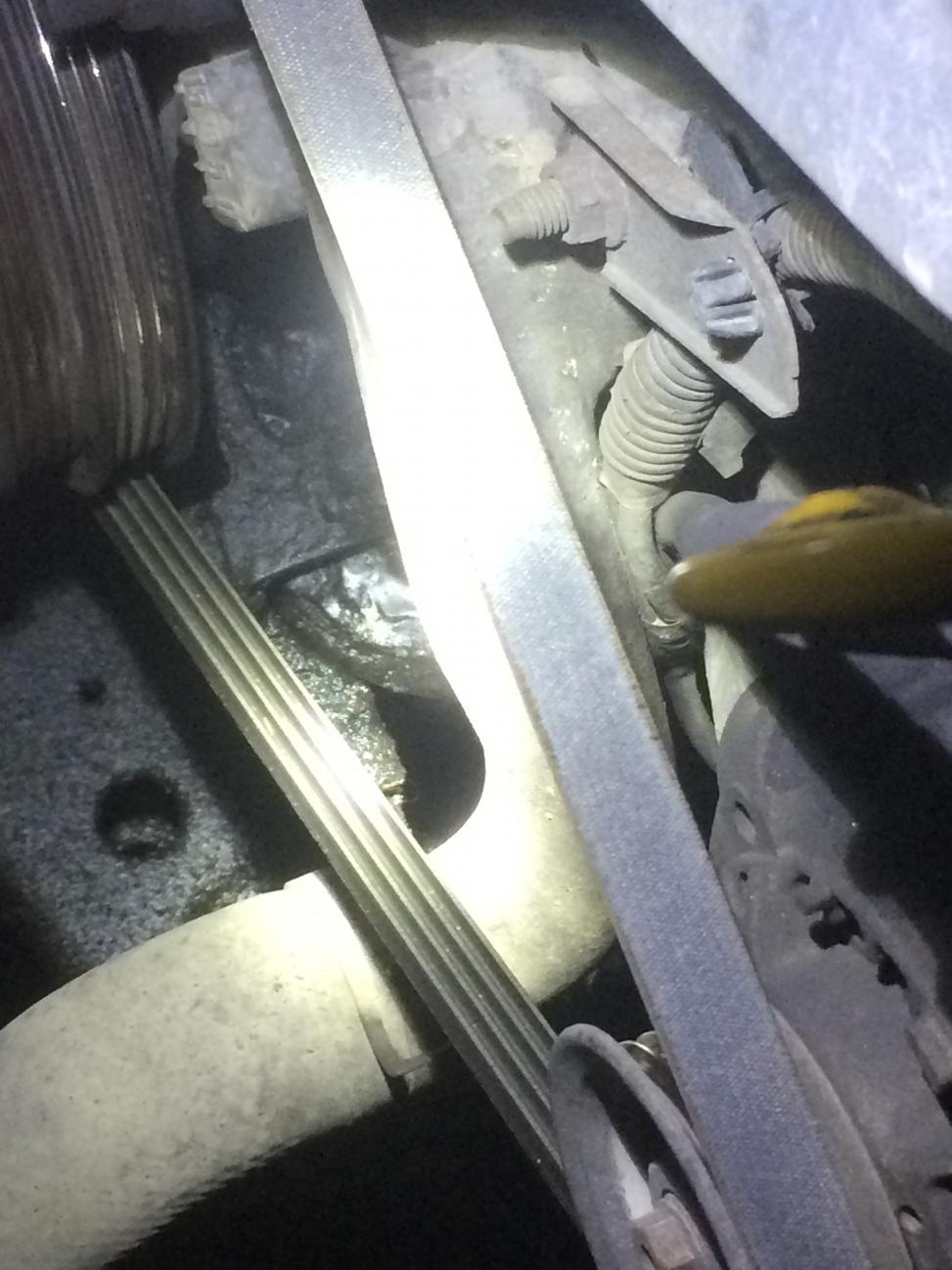

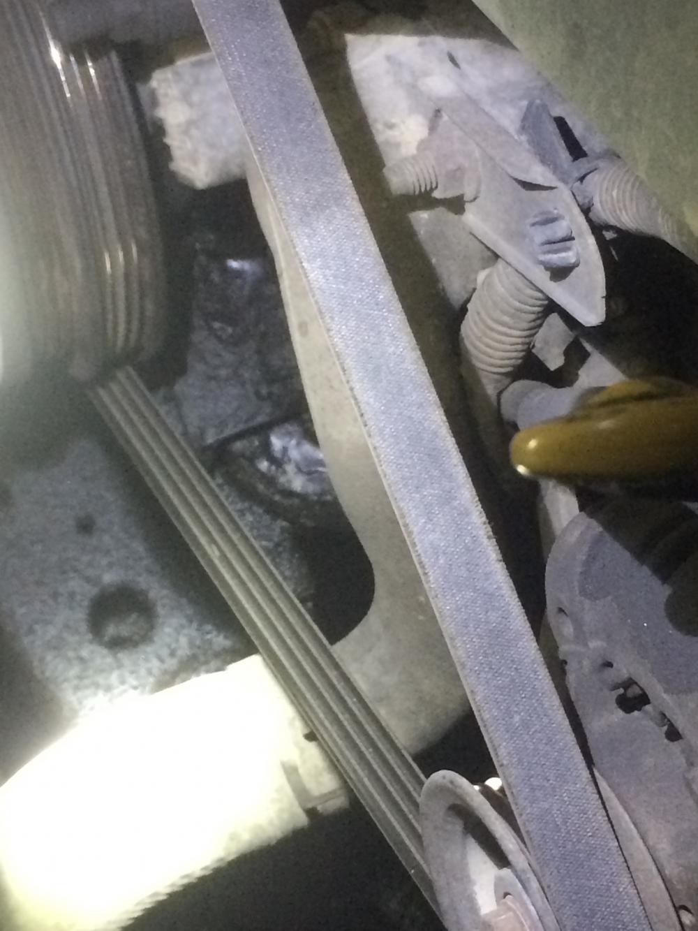

I just bought a 96 sr5 200k I love it but its needs a lot of work. I am very curious to know where this oil is coming from. it is everywhere. that little silver bit you see is from me wiping it off with my fingers it was thick sludge.

If it seems to be concentrated around that harmonic balancer it may be the front crank seal in there. If it’s not coming from higher up that is.
Valve cover gaskets? Common on the V6.

yeah my valve covers are leaking I just tightened up all the bolts its much better for now.
I'm gonna do a timing job soon so Ill find out if its the crank seal.

That lip around the bottom of the block/oil pan will collect oil from a valve cover leak, could also be the dip stick tube oring.

I have the same issue right around the crank. I have new OEM Crank and Cam seals done 35K miles ago and OEM vale cover gaskets done about 10K ago. I didn't do the dip stick O-ring, may be that is an issue.
The oil you see could be the residue after the filter change.
I would pull the skid pans then take it to a coin op car wash that allows engine cleaning blast off all the years of crud then drive it around for a bit and see where the leak is coming from. You will be much happier when you go to work on it after doing this. Bring a creeper some eye protection I start by looking at the underside before I start spraying. When I start spraying I start at the bottom work my way to the top avoid the alternator, exhaust and the radiator. After the money runs out let it drip for a few minutes recheck to see any areas you missed. Don't forget the skid pans they will need a good hosing too. From the looks of the lower radiator hose you may want to consider doing all the coolant hoses and thermostat while your there I am also wondering how the timing belt is ? :reddance:
It is my valve cover gaskets they are original after 200k and have probably been leaking for the last 100k+. its weird that part I wiped off with my finger is no longer visible after just a bit of driving but I never notice it on my dipstick. it seems like a pretty bad leak.
I would get a new o ring for the dipstick tube. Mine is doing the same, and noticed it when I did my timing belt. I forgot to change it, but, it’s a fairly easy job.
Do the easy fixes, dipstick o-ring (it's literally one 10mm bolt and the whole thing wiggles out) tighten down the valve covers if they are leaking or replace.
Changing the crankshaft seal is not a simple job. Also, that oil leak is not hurting anything at all and does not affect the reliability or drivability of the vehicle and is a common leak point. Some even leak from the oil pan, which requires either the engine to be pulled or the entire front end taken off just to drop the pan. If you want another opinion, do the easy stuff and things you were going to change anyway and leave that leak alone.
another small part, if replacing valve cover gaskets, is the oil fill cap has a rubber gasket as well. When I did my last vc gaskets, I replaced that gasket as well as the dipstick o ring. Both are not major leak makers, but figured Id replace them anyway while I was in it. The old oil fill one was hard as a rock and at first I thought it was plastic and part of the molded plastic cap. I dont have the part # handy.
I have to change the timing belt soon and am debating if I should do the extra work to change the crankshaft/cam seals since I will be in there, plus it will come with the timing belt kit......
Old engines leak. It's probably the crank seal and dipstick o-ring. The o-ring can be done now, but the crank seal will need to wait until your next timing belt job. Once you get in there then I highly recommend doing the cam seals too.
I agree with above. I know a lot of people dont change them till they leak. My rig uses no oil yet its hard for me to imagine they are not seeping a little right now. My next belt is due in about 20k miles, which is also at 295k. It will get it done sooner. It will get new seals Will also do oil cooler and the hoses related, as the parts are now 20+ years old and nearly 300k miles.
Similar, when doing upcoming vc gasket job and all that is opened up, any water hose under intake etc, ( hard to get to) is getting replaced, as those too are very old.
