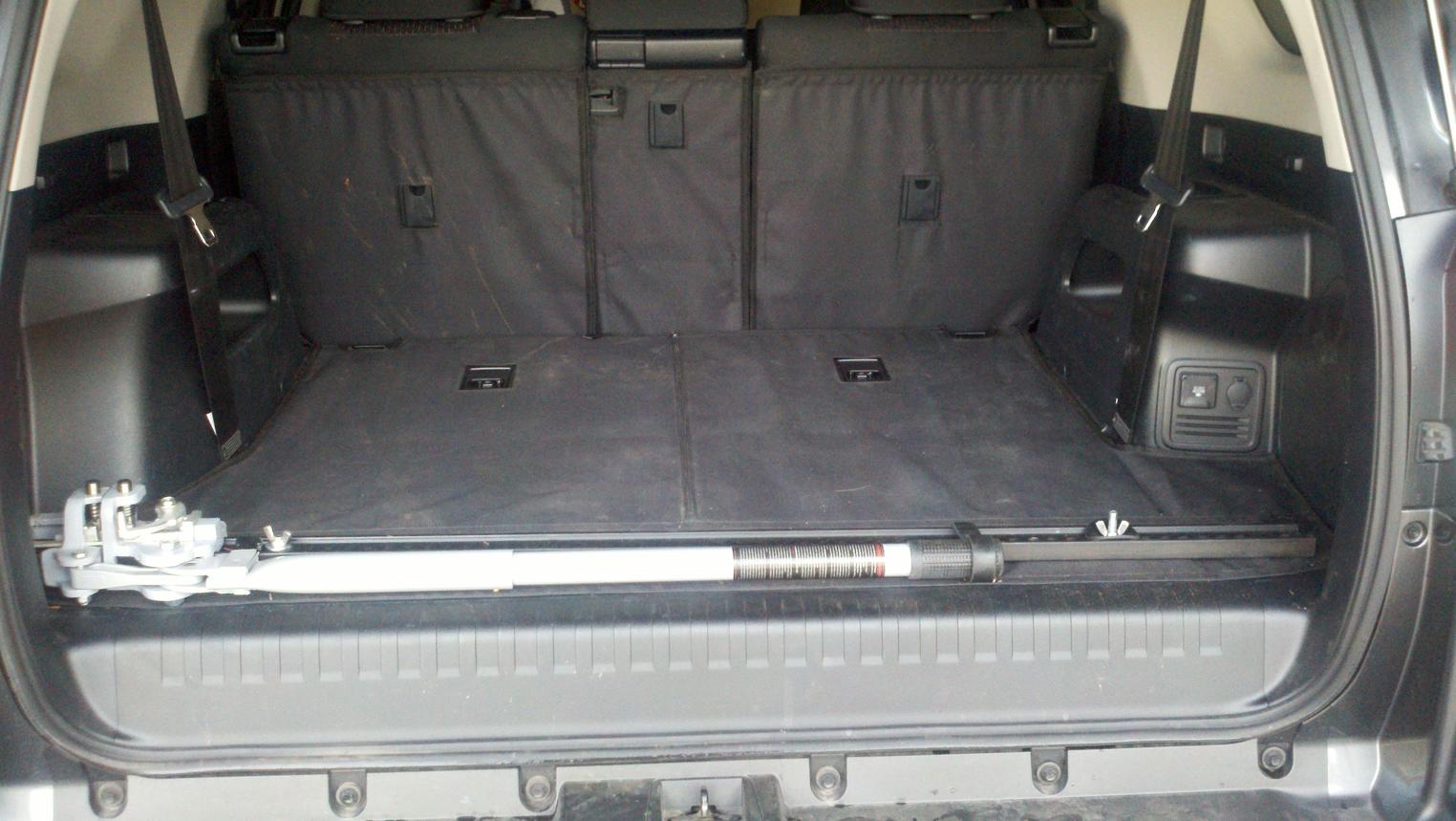

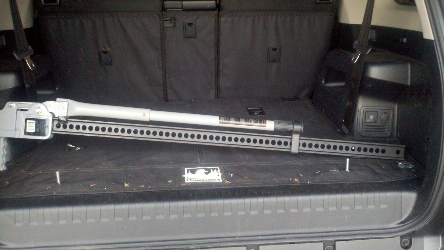

I know I'm reviving an old thread, but thought people with 3rd row seats like me might benefit from a quick/cheap mod.
Cost was about $5 in parts:
2 3/8in bolts
2 3/8in lock nuts
couple of washers and wingnuts

It looks like its in there pretty tight which is good. I keep mine on the Gobi rack now, do not want to risk that thing flying around inside the cabin in the event of an accident.

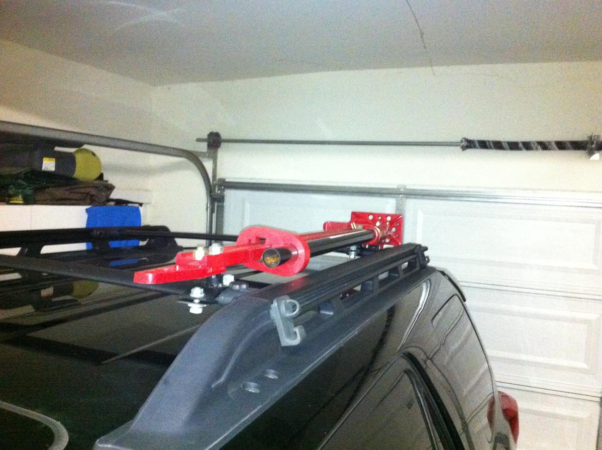

I took some 2" flat stock and cut it to 4 equal lengths. Drilled out two holes in each piece. In two of pieces I drilled a hole in the center and welded in a u bolt (from the Tacoma after I installed the Dakar eat springs). I bent them slightly to form around the crossbars and have the Hi Lift mounted securely on the roof rack.

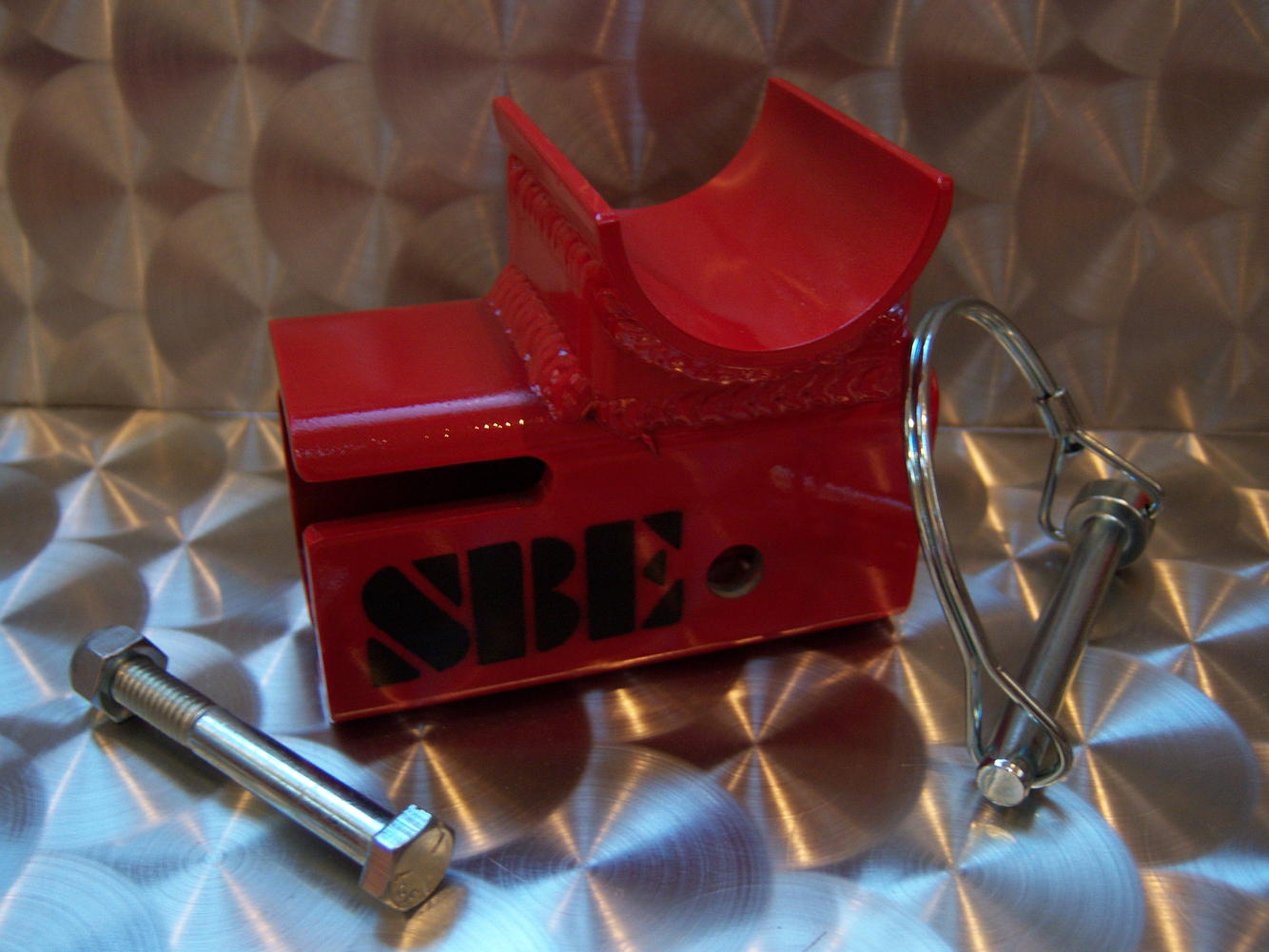

I use this on my sliders
I would recommend making a lift with the jack in a nice safe place to make sure you know how things work.
