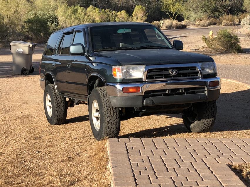

I picked up a 96 4Runner a few months ago that has 99 springs. I really like the way it sits. It has recently started squeaking a bit from the front end. I think I need to start replacing some bushings.
