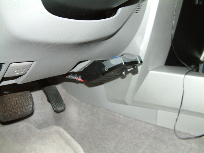

Yep, I have an 04 and mounted it below the dash on the right as far as it would go toward the center console. Do you want a pic? I can go out and take one if you want. I like it, not in the way and easy to reach.
Here ya be.... I bought the Odyssey but I think they are very similar in size.

Some have mounted it on the fuse cover to the left of the steering wheel. This way they just swap covers when the controller is not in use.
Here is my Prodigy. In two years and 56,000 miles it has never been in the way.

Right Side Location
I have my Prodigy unit mounted in the same right side location as the previous photos indicate. I leave it there at all times and it doesn't interfer or get in the way.
I contemplated installing it on the fuse box cover but was worried that the weight would cause it to come loose over time.
I bought an extra fuse cover (located on the lower left side of dash) and mounted the controller right on the cover. Since the OEM plug is located right there I can just unplug it when not in use, and pop the original cover on in seconds. In addition, you have excellent access to the controller when you need to manually apply the brakes and it is never in the way.

Pop the cover off and you will see that it can not pop off from the extra weight because there are two long tabs at the top that must be inserted first and then you have to pivot the cover down to lock it in. The cover never comes off because of the controller. It is a very nice set-up.
