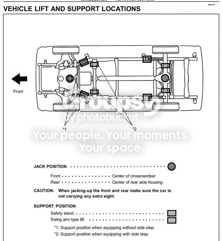

where to put jack stands?
Here ya go.
Jackpositions_zps78d353da.jpg~original

haha i sure as hell didnt get under that thing, i was putting in 9wrap lc coils (not easy) i need a lift
i should prob take that picture down since some people might just try it:faint:
thank god!
yes I suggest taking it down because there are plenty of people < 18 here, some know about proper jack stand safety and well some might think that is ok ...
Personally I NEVER trust a jackstand alone,no way,I have the 6 ton stands and after jacking it up 8x8 beams go under it 2ft long, to stack under the vehicle so even if jackstand failed the wood stops it,it may be overkill but its not unusual to have jack,jackstand,timber all under it before my ass crawls under it! NEVER trust hydrualics alone people.
ok someone please post it back up, just make sure you label it "NOT HOW TO USE JACK STANDS" or something... i think the rest of us want to see this conTRAPtion
yes please on orig photo,thread kinda lost itself because of the unknown,it would show the DANGER and how not to do it to those who might try it otherwise.
Wood is a lifesaver... I also usu. put the wheel I took off underneath on its side.
