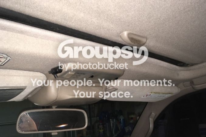

I have mine up by the map light. It's held on with a small peice of heavy duty (5lb) 3M double stick tape. It's held on for 2 Vegas summers so I don't think it's going anywhere.

I would put it up high. I have mine on the steering column on my other car and I get complaints about not hearing me. I don't look down when I drive so it wasn't the best place for it. A pillar or up by the map lights is where it's going to end up.
