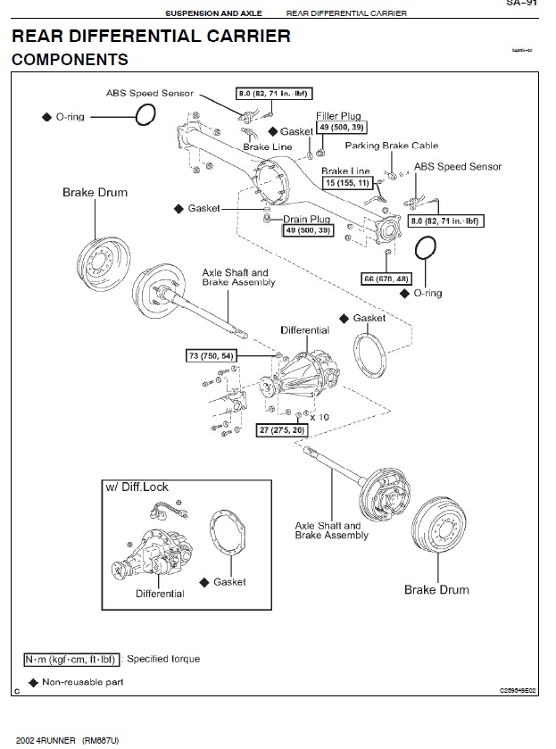

Take a look at the very bottom of the picture. I searched for a 2002 4Runner rear axle parts diagram in the system and this is the same picture that popped up. Perhaps they just carried over existing files?
