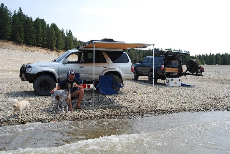

I personally have the CVT and I like it. However, the ARB has more attachment points for the poles that extend horizontally from the vehicle. [MENTION=105773]busmup808[/MENTION] has the TJM and could perhaps comment on it.
The CVT has one at both ends, and one in the middle while the ARB has one like every foot or so which allows the awning to be pulled more taut and not sag as much.
Here's my CVT... you can see the velcro straps I am talking about.
DSC_0012 by Alex Wilson, on Flickr

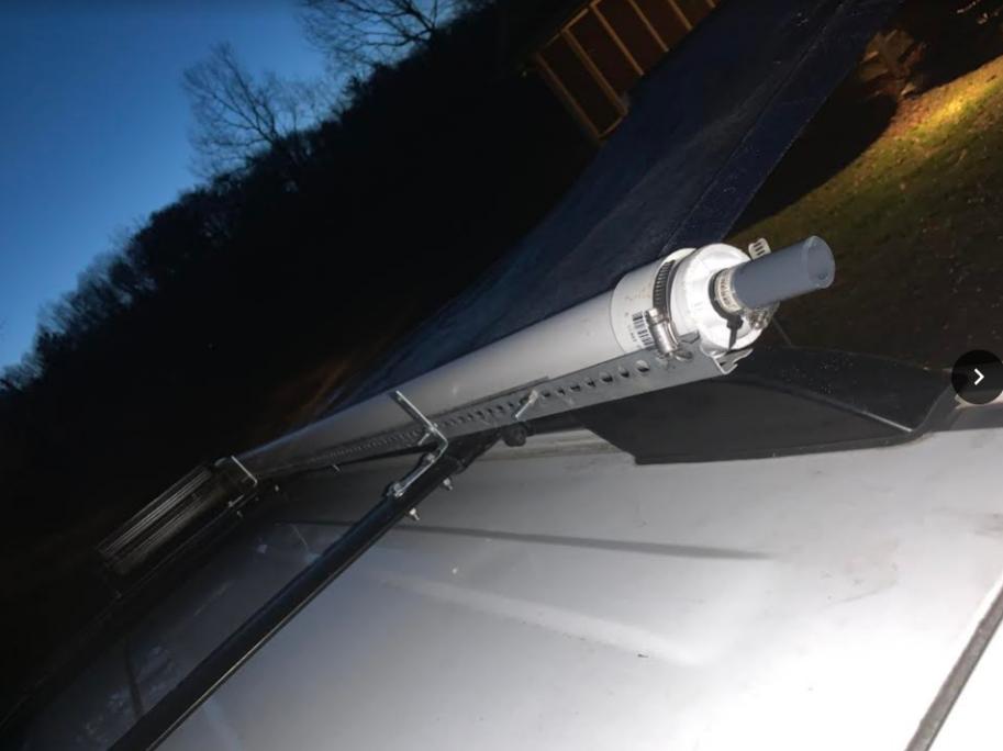

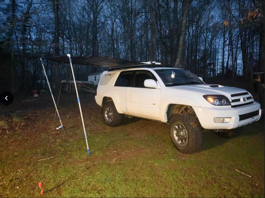

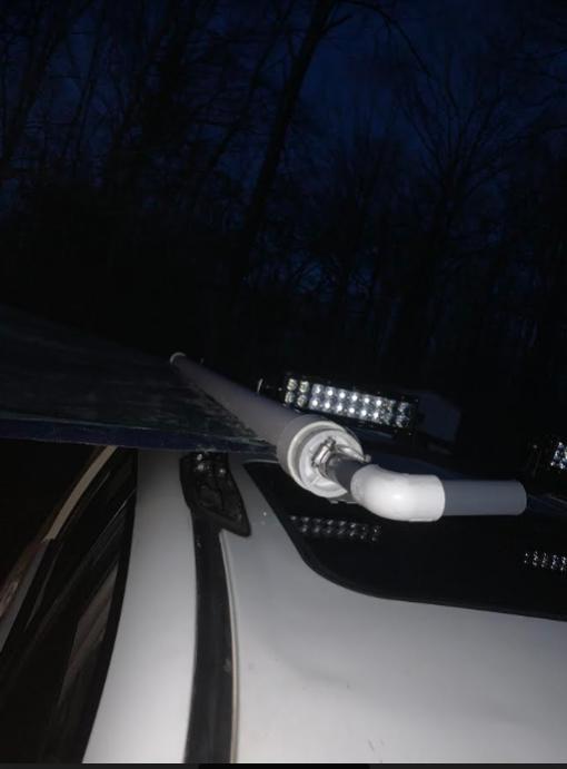

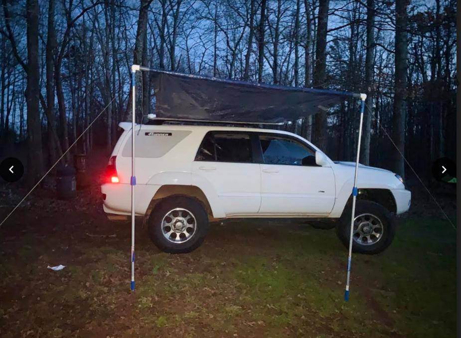

I took inspiration from this and also built my own awning in a similar fashion. I'll attach some photos. I used a 6x8 ft tarp with a 2" outer shell pvc. I used 3/4" for the inside pvc pipe that the tarp is fastened to. The tarp fits perfectly so that when completely rolled up, it is tightly fit enough that it will not come out due to wind from driving. I may post a more detailed build thread at some point.
