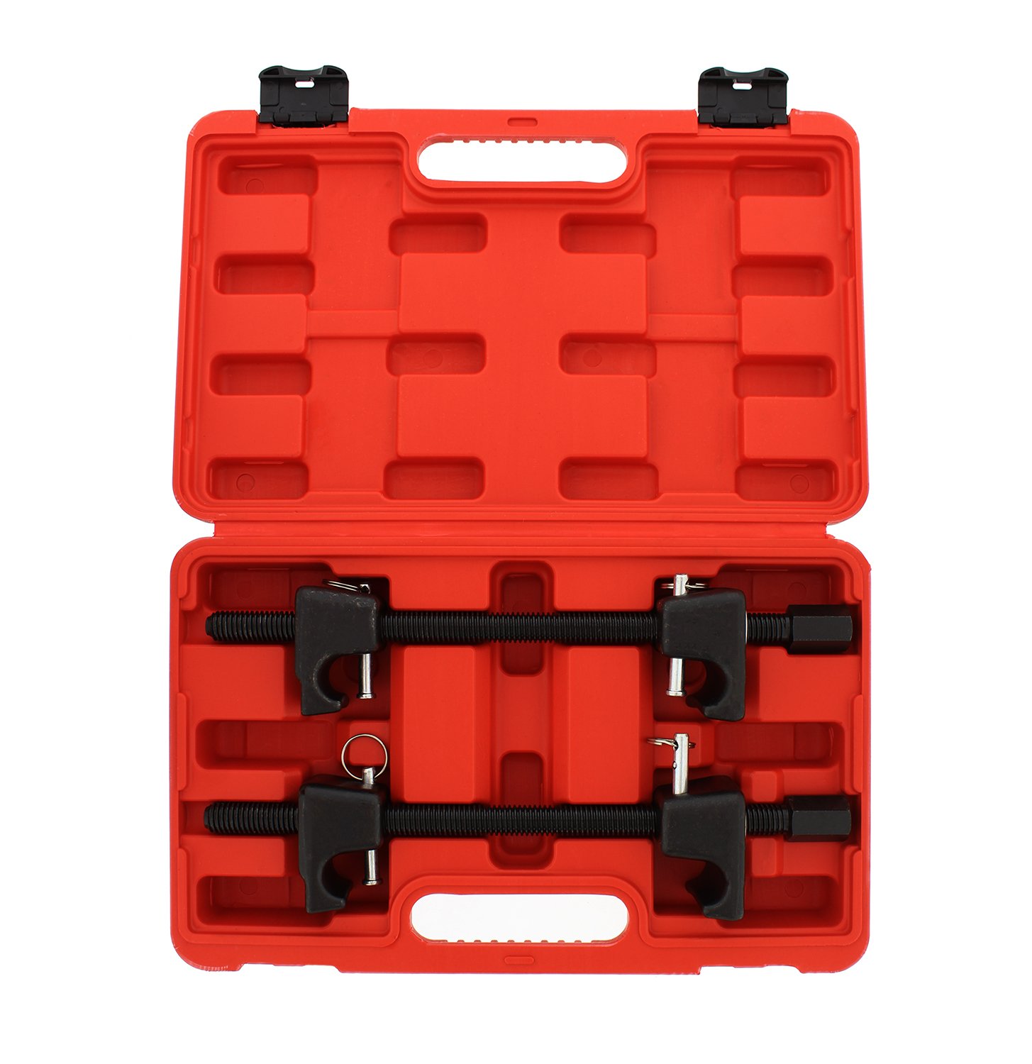

Ummm, or get a spring compressor for 70 bucks and do it in your garage in 30 minutes.
Man, if I ever do them again, I will take them somewhere or buy a 1/2" impact. 30 minutes is accurate...per side...but it is 30 minutes of cranking on a socket and then backing it off just as hard. I am not the biggest guy in the world, but using the spring compressors with just hand tools was WORK. Not to mention the was shaving a lot of metal off the threads of the compressor to get it tight enough to get the top nut on...I wouldn't trust those compressors to have a real long life.
HAHAHA, agreed
I will can get spring compressors from autozone and use my impact, I've done it before, but even with that you need to stagger and go slow to not heat up the compressors up - they can bind and even fail
I might just buy a pair of these to be able to do both sides at once, working between each side
HAHAHA, agreed
This guy gets it. VVVVVV
Those are the ones I have, I'm surprised how good they are. I use a Dewalt corded 1/2" impact.
There's a vid that someone(forget the username or I'd tag them) posted in the DIY videos thread that has one of the best lines ever.
"Anyone who tells you not to use an impact with a spring compressor is just trying to slow you down."
I laughed so hard it hurt. llol
Grease those threads and go for it!
I've used my set a few times, always with the impact! :biggrin2:
-Charlie
