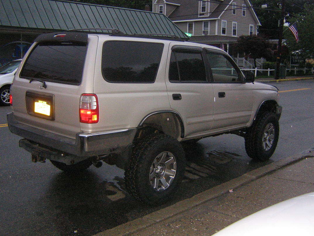

That is tall, I have about a 1.5" rake with the 8 wraps.
You said this is for the wife right? She's not going to like the ride.
it's just her crawler but yes I have to soften it up. they are going to have to go down a notch. She doesn't mind it how it is now but as Ive drove it it has to get softer and she will like it even more. and I knew I should have gotten the lifetime alignment dang it. LOL
