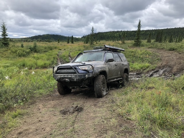

Have had my OME Nitro Charged since 2017, 50k on them, they get used hard… a lot, still performing great! Looking to upgrade to the OME BP51 when all this back order madness ends… and I even have someone who wants my old suspension when I upgrade.
truck looks great, which rear springs do you have?
