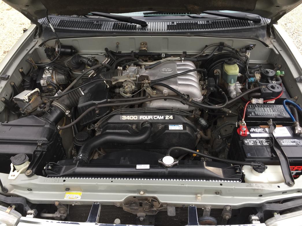

ALL ALUMINUM!! LOL....I have been around radiators from small single piston engines to heavy equipment. Never seen a radiator blown up like the Toyota cheap plastic. I know lots and lots of plastic radiators in use...does not make them better...makes them cheaper. Another reason...show me a professional race team...any pro race team....that runs OEM radiators on their water cooled engines. Now...will OEM work...absolutely...is there better I believe so. I am a poster child for the get it down quick crowd...hense I put a Denso in from Amazon a couple months ago. Why??? because I was freaked out and not thinking clearly....worried I needed a entire new motor and was running around like an idiot.
I went the Amazon.com Denso route.....not great packing but arrived in good shape. I feel like I remember that many years ago Koyo was a cheap alternative to a quality radiator? I've since learned that Koyorad has a great rep and would not hesitate buying one in the future. The Denso was a few bucks cheaper and Amazon is easy to return if needed.
