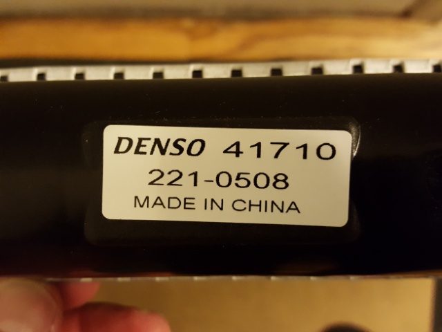

Denso radiatos now = Made in China

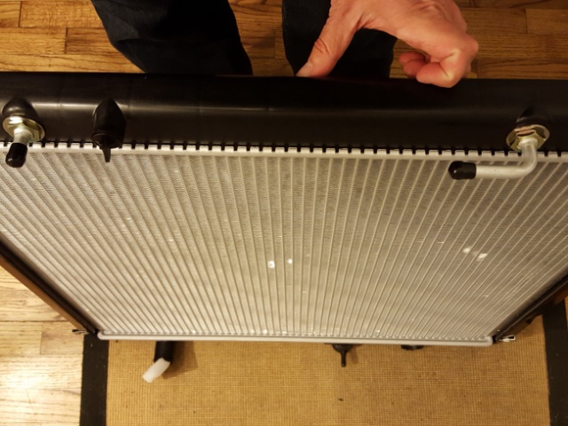

So I had been looking at a few radiator options to catch up on some preventative maintenance. I researched current radiator options and none have impressed me that much.
The Champion all aluminum radiator looked interesting. But some of the people who installed it mentioned it was not as "direct fit" as it was advertised. A few were not impressed with the press-in nutcerts mounting. Some simply removed the nutcerts and used nuts and bolts for more predictable longevity. Also some mention that the radiator itself sits on a support member and it made them a bit nervous that it would rub a bit off-road. And most seem to get around any mounting drama by using a combination of longer bolts for mounting hardware, as well as different types of spacers to get the radiator and fan shroud to play nice. Even then, it is not guaranteed that all the holes will line up.
This made me want to give Denso a try. Denso part number 41710 221-0508 is what I ordered from Rock Auto. Someone said they got a non-China made radiator with the same part number... LOL. Guess where mine is made? Hahaha.
Cost: Radiator = $87.79 . Shipping= ($26.99ground). Total = $114.78.
Radiator ships with no cap.

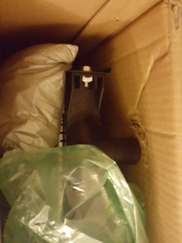

The packaging was probably a bit better than Amazon, but not very impressive. It was mostly loose in a large box with a few long runs of air bladder packaging with a couple corner expanda-foam corner pieces.

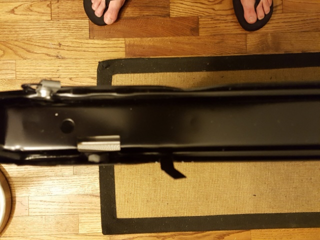

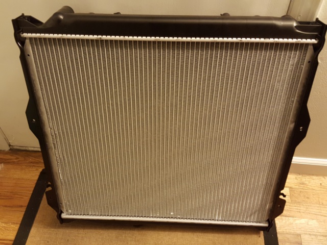

No major pieces seem to be broken. Some cooling fins are bent. One side of the sliding frame rails is a bit bent as well. Oh! And the drain valve is just a simple plastic screw piece with a flat rubber gasket. This means that if you drain it, it will simply shoot out towards the rear of the vehicle instead of the downward option that original OEM offers. I have to say that I am not really impressed. I mean, it is probably fine, and none if these things are major issues, but it just seems to be difficult to get a drop-in replacement without drama.
This is my only vehicle, so when I drop the old radiator, it is a pain to discover that I might have to go to the store to overcome some goofy mounting issue. That's what steered me away from the Champion. Now I am coming to the realization that they all have their issues now and we are in China's hands for many of our future replacement parts.

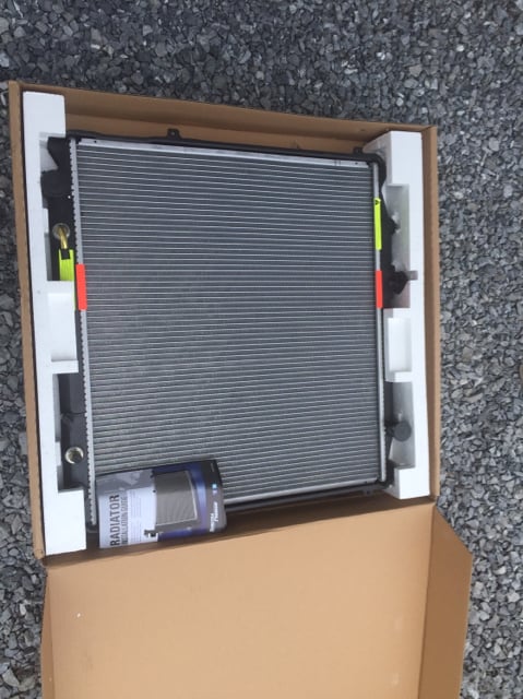

Got a Spectra rad from them.
This is for the 97 Puppy Hauler. It was packaged much better then the Denso I got from Amazon for my 97 SR5 Project.

Could you post a pic of one of the radiators when you get a chance?
