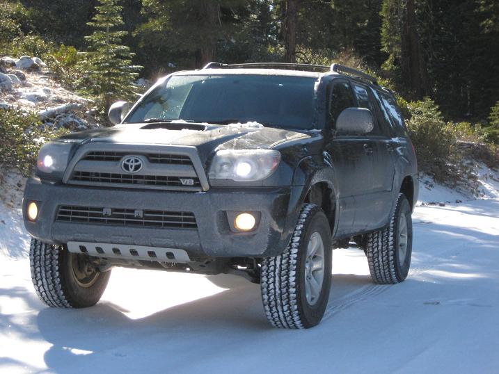

I got 3.5/2.25 from that setup. 5100's are at normal ride hight(lowest).

Casper (I believe) has the 1/4" spacer. I ran the same setup, only difference was that I used my stock air bags to lift the rear 2" instead of the Superflex coils. Also have a 1/2" body lift. I got 3.5" out of the OME fronts with 1/4" spacer.

You my friend are correct! It yields about 1/2" of lift. I’m very happy with the setup. It rides more "truck" like on the straights but it kept the cornering stiffness that the XREAS had. Minimal body roll and nose dive. I believe its the best setup for a DD!

I do have a little rake but it's perfect to me. The 885's and spacer were too much with the v6, I wouldve kept it like that with a v8 but the v6 is lighter.
