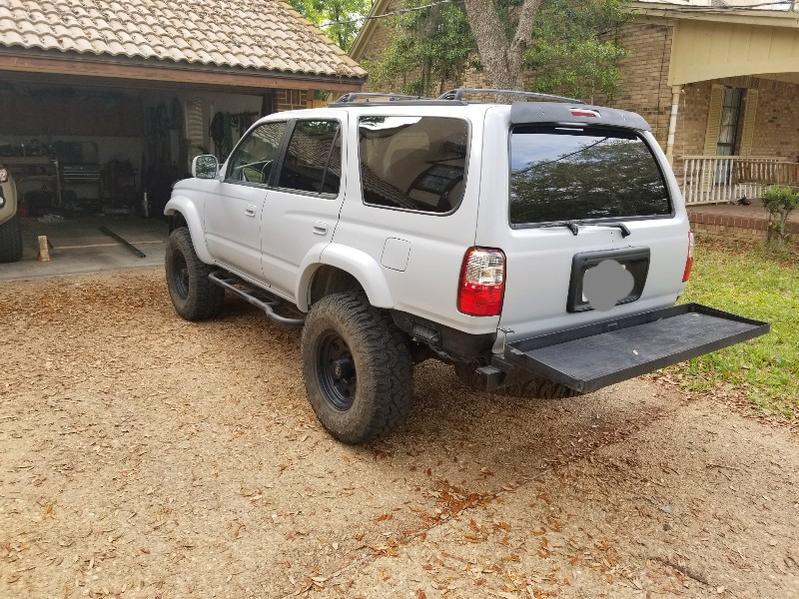

The install went about as well as you'd expect for a Northern car lol. I ended up cutting off all 4 shocks...
But, overall I am super happy with it. I am in the middle of a move right now so I havent had a chance to build any of the armor I was hoping to start. But, I still have a good 150lb of gear, cargo box, and additional spare tire weight in the back and it is still a hair above level and rides much more smoothly than it did with no weight (still not as smooth as stock, but I didnt expect that).
Overall, I am definitely happy with it. I do wish there were more options to lift less that are still designed to support a good amount of weight. But, I am still happy with this choice and think the height will drop a bit and the ride will improve with more weight.

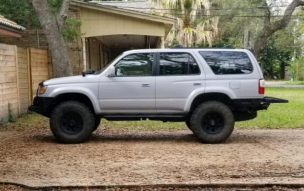

It looks AWESOME! Now I'm even more excited to get mine done. What size tires do you have on it? I didn't see if you mentioned that above. They look a little bigger than mine, though.
Thanks!
I am definitely happy with how they came out. They are 285/75r16s, but they did measure right at 33" if not a hair over. My wife's 285s are actually much closer to 32", for example (should be 32.8"). Also being on 8" wheels helps them appear just a little wider than if they were on 7" wheels.

Out back, I have added a drawer / sleeping platform (+100#), a custom bumper (+35#), a full-sized spare (+25#), and roughly 70lb in gear and tools (maybe more; I'll have weigh it), for an additional 240# over stock that will go up to about 250 once I finish my bumper.
