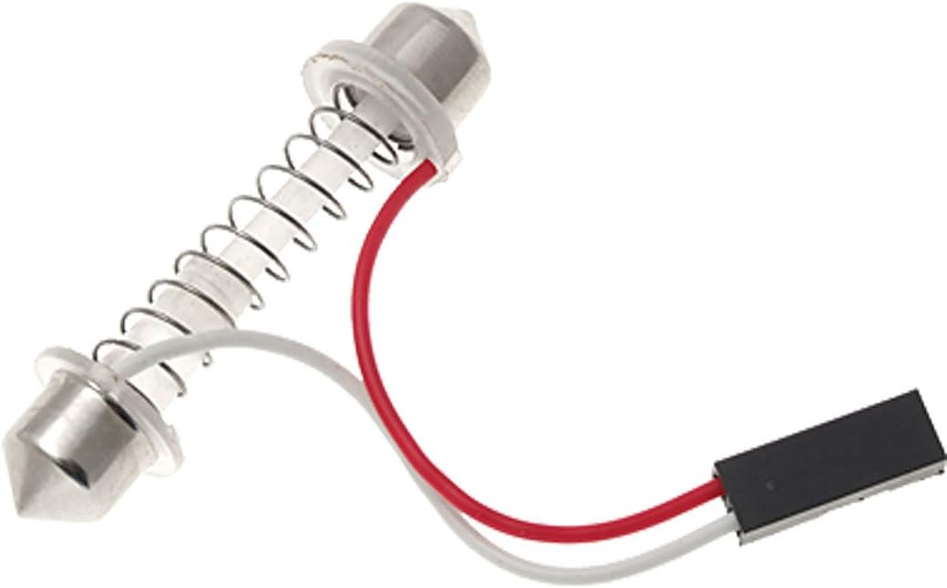

Center Dome & Hatch Lights
I went all out on these.. In hind sight.. I probably shouldn't have as it got kinda hot when I left it on while working on the car at night. Like maybe close to melting plastic hot. But... it was on for like an hour.
I used these Festoon adapters
uxcell Rectractable Festoon adapter
then wired them to these G4 Sockets: gz4-g4-socket-wired-bi-pin adapter
timthumb.php
so I can use these:
g4-led-boat-and-rv-light-bulb-40-watt-equivalent-bi-pin-led-disc-390-lumens
timthumb.php
At 390 Lumens they are super bright almost too bright and too hot so I might have to downgrade a bit.

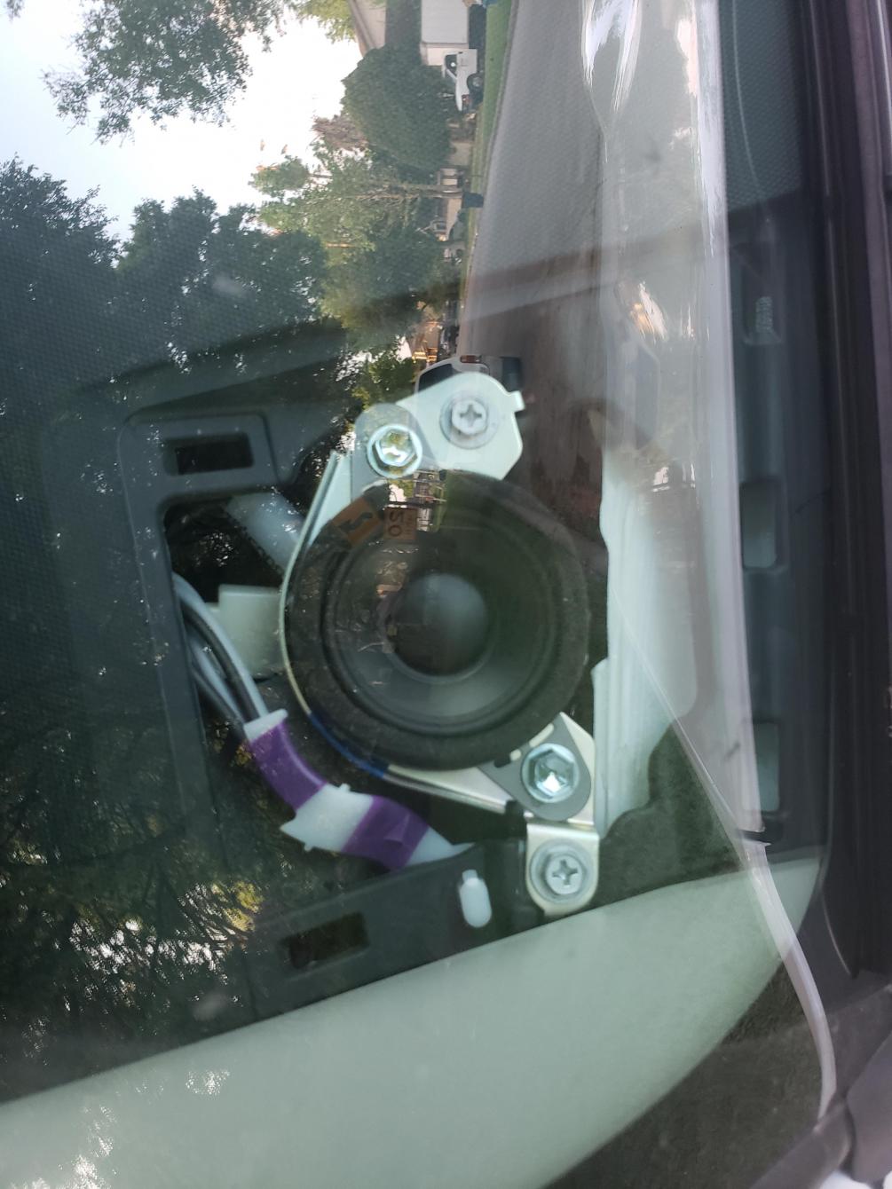

So my first upgrade was to put in a wideband in the flavor of Audio Frog GS25.
I purchased the frogs, some dash wire harness on the bay, and they drop right in the dash spot.
AF GS25 are 100x more clear, better sounding, better output than stock. It brought the sound stage up and no more muddiness.
