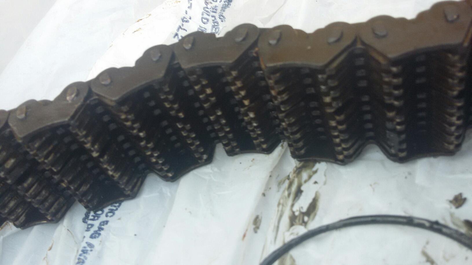

Yep, thats the chain!

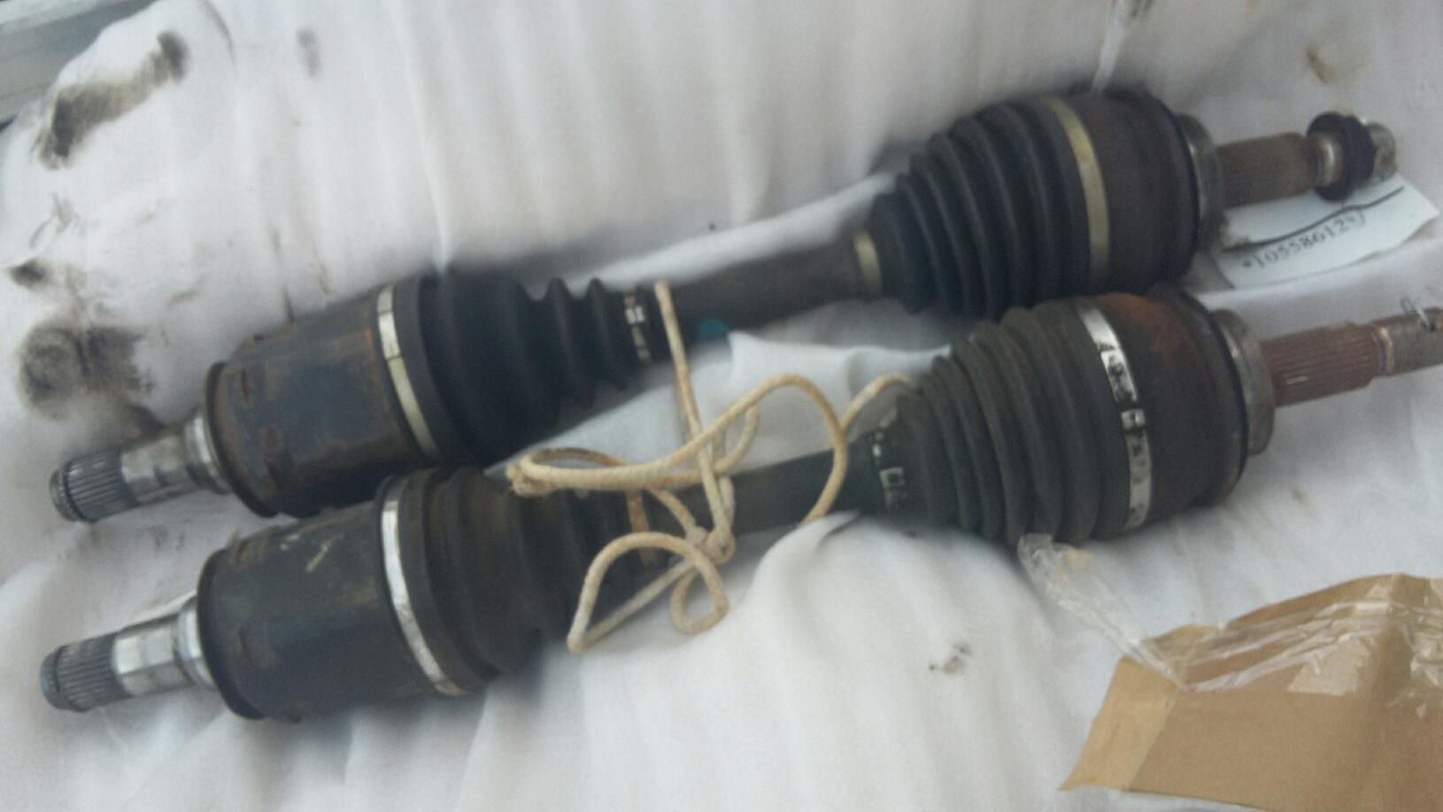

Today after work i will check with the workshop. I also have my doubts about the chain of transfer the case being the culprit! I actually purchased CV axles and new rubber boots and brought them with me to the mechanic. I would have fixed it myself but just don't have the time!

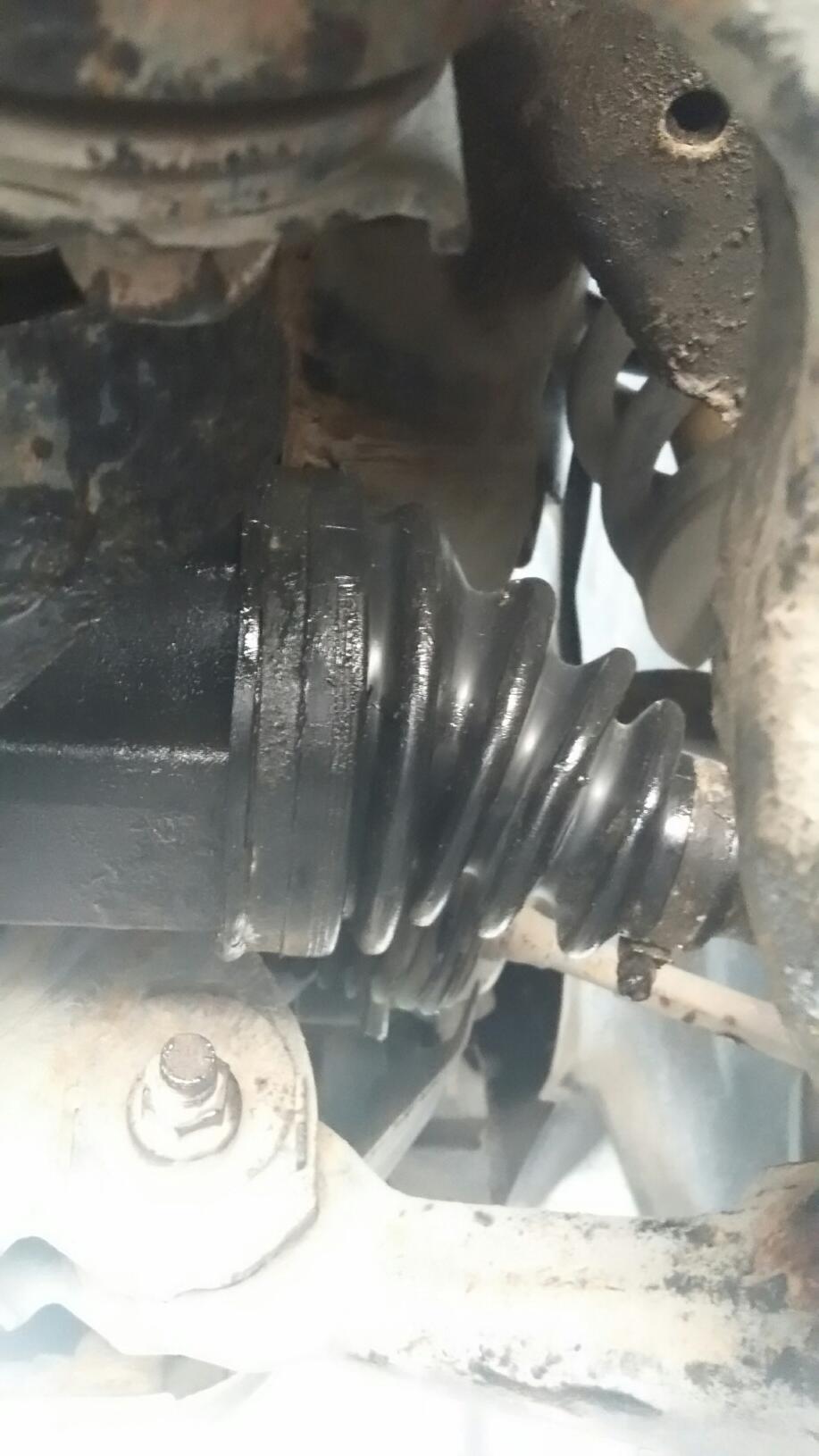

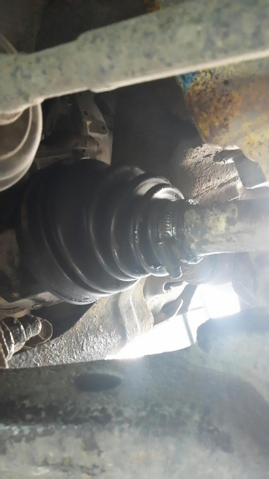

We also did the outer boots on both sides. The joints on the CV axles are O.K.

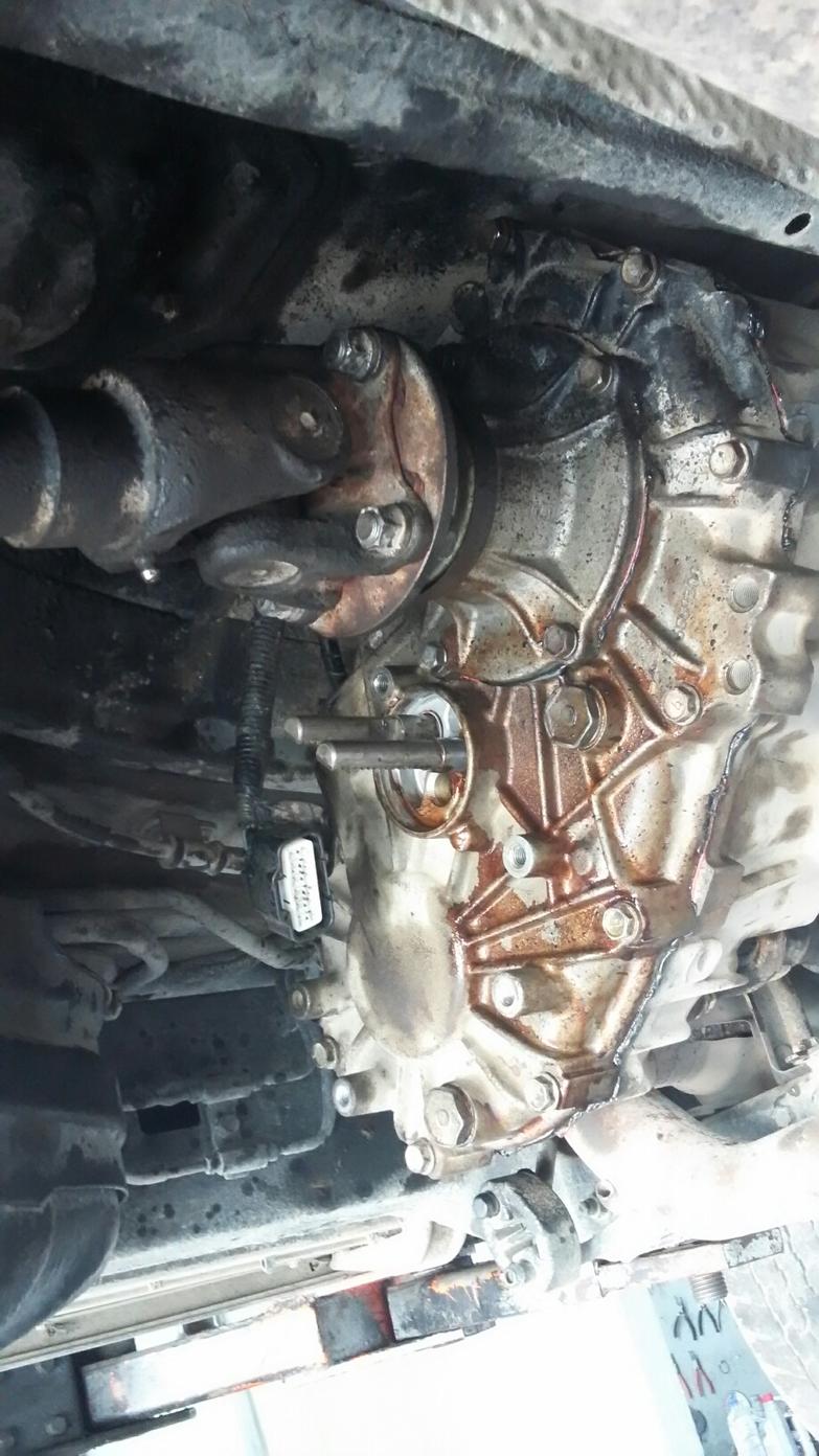

Pics attached:

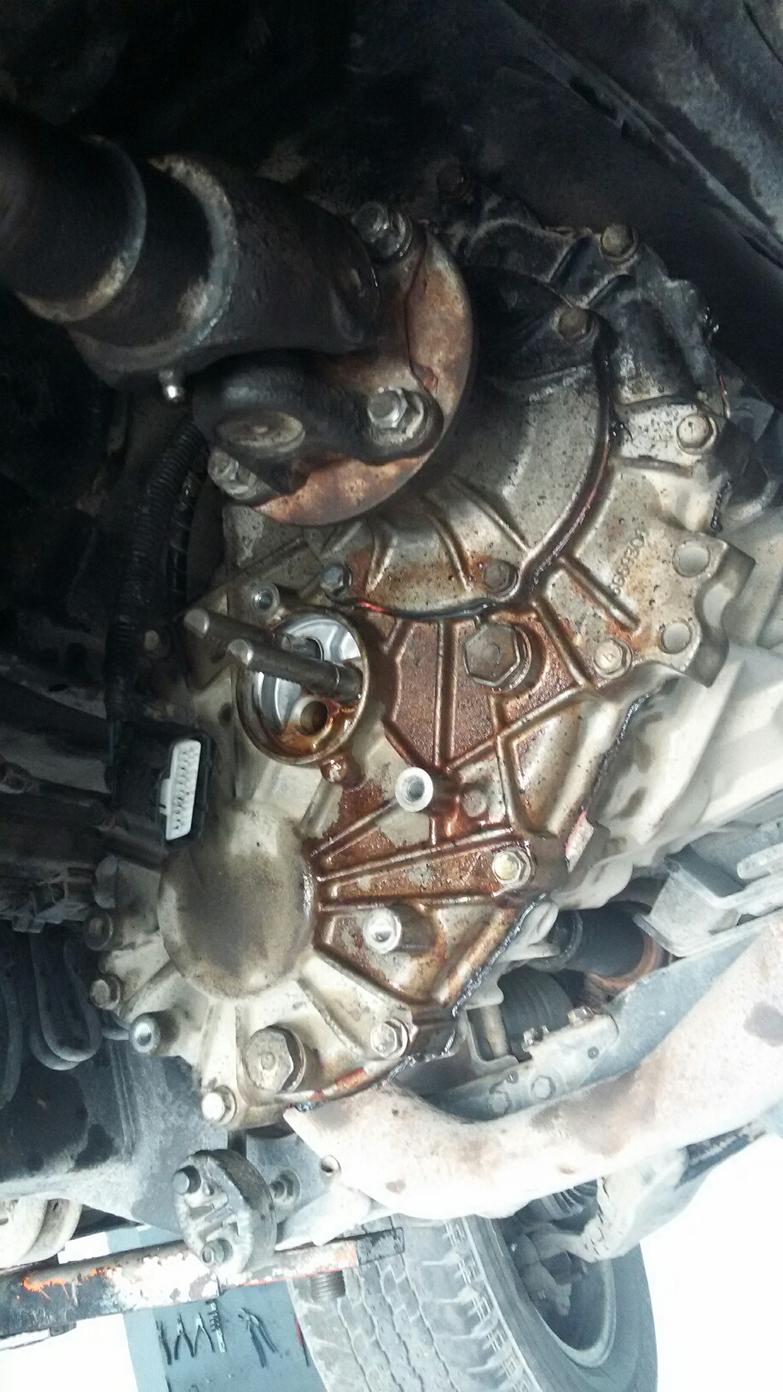

Actuator??
Ok, I have to ask.....where is your t-case actuator?? I ended up in the same boat (truck stuck in 4-low, had a 10 hour drive home) when I ended up dismantling the actuator so I could shift into high range manually. It took me a month of Sundays reading this forum and a $500 actuator off Amazon to get my truck back on the road.
Maybe it's just the photos but all that spilled fluid on the outside of the t-case looks red. Any idea what kind of fluid they put in the t-case?? It should be 75-90W gear oil, not ATF (which is normally red). Maybe the wrong fluid and very little of it are both contributors to the problem. Glad to hear you're getting your rig back together. At least you're not driving a Ford/Chevy/Dodge. I spent 4 years in Germany and the folks that brought over US spec/brand vehicles were totally screwed when they needed service.
I haven't heard of a chain failing on a Toyota transfer case made in the last 20yrs, at least not that I know of. Maybe if you're really abusing the **** out of the vehicle, but usually you'll blow a diff or a CV axle before that happens.
Good luck re timing the actuator. Should not have taken that off from the outside. In fact, I did not even know it was possible.

Also interested in more details about the current state of the t-case and actuator.

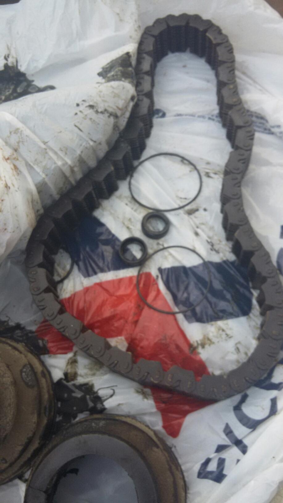

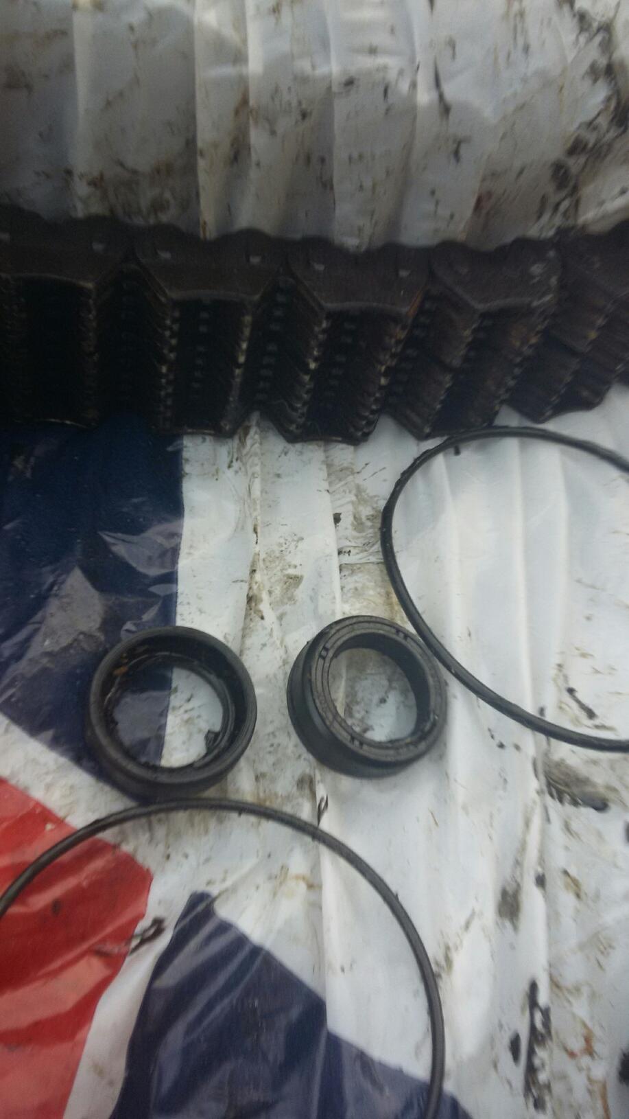

Yep. the sealing rings on the transfer case/actuator were gone, which caused the loss of oil. We got that replaced also.
The previous pics were taken during the works, with the actuator off. It's now on and works fine.
To those who have never seen a chain go bad: yes it happens! Particularly when you don't have any oil in the case! The chain got stretched and started skipping the teeth on the gear. A fraction of a millimeter is enough to get the chain out of sync!

One thing I learned: NEVER diagnose on first view. As you can see on the pics I ordered two CV axles, being sure the problem were the axles! I just saw the rubber broken on one of the boots, but did not lift the car to check all other parts. Paid ridiculous costs for shipping two axles from the U.S. to Europe and waited three weeks - just to find out that I don't need them! Well, at least I got some spares now. The good news: 3rd gen chains fit on 4th gen! So I got it all fixed (replaced the chain with a used one), sealed and filled with fresh oil, for all together only 500 euro (that's about 580 USD). THAT's again the advantage of working/living in an underdeveloped country, prices of labor are low!
Pics: the chain of the transfer case, the sealing rings we changed, the outer boots of the CV axle

That chain looks like something Chuck Norris would wear around his neck.
Or maybe the chain is wearing Chuck Norris.

Ok wait a minute. The actuator is supposed to be removed and reinstalled when the TC is apart. In the photo the actuator is removed while the TC is still on the tranny. I know some have attempted to remove the actuator to replace those seals with the TC still on the tranny to get around not having to remove the TC (not recommended by Toyota!), but if you had to take the TC apart anyway to replace the chain then why not do the actuator repair the proper way.
If the mechanic got it back together ok and the actuator still works fine (shifts 4Hi/Lo and CDL lock/unlock) then consider yourself lucky. The plastic gears in the actuator that mesh with the teeth on the metal shift rods in the photo probably got slightly damaged when it was removed and reinstalled, but obviously not enough to mess up the functionality of it.
The TC was taken off, the chain replaced, the actuator removed, TC without actuator and new chain put back to check parts fit well, than TC was taken off again, actuator installed with new seals, all together re-assembled. No worries, the shifter works fine. Just drove to Greece and back, 500 miles.
OK thanks for clarifying. Sounds like it was all done properly. Seeing the TC on there without an actuator didn't look right.
