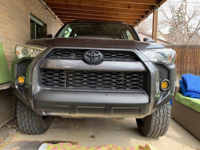

I spend months researching every post and looking at every possible photo prior to deciding to use SEM Black paint. The price for TRD Pro valances, wrapping, or LineX in the Denver area was way to high in my mind. More than likely will replace bumper in the future as well. Used a lot of green frog painters tape, took my time prepping, and sprayed both the front and back without removing the bumpers. Very pleased with the results and happy I didn't remove bumpers. I often have issues and screw things up, so one less thing to worry about.
SEM is definitely the best rattle can paint I have ever used.
