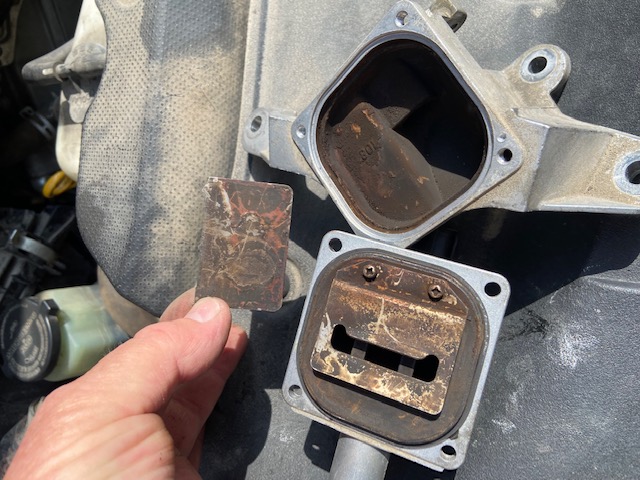

Had the driver's side air valve break a vane inside of it when removing it to replace spark plugs at 240K miles (see pic below). Could hear rattling inside so I tore it apart. They don't repair these and only sell new units which are about $300. I did find a good used one online for $85, which sits on the shelf.

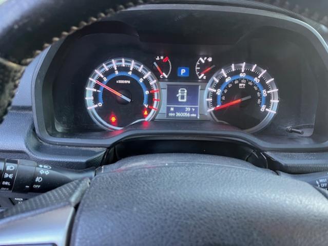

360K miles.

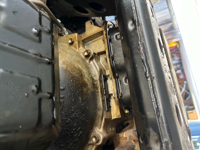

Rear main seal just started leaking. Given that the transmission is showing no sign of issues, I poured a bottle of Blue Devil Rear Main Seal stop leak in it. Hopefully it works and I can put off seal replacement until/when the transmission does need to be pulled for a rebuild. I am game for pulling the transmission and transfer case, just not now as I have too much on my plate.
Engine showing no issues. Not burning oil. Runs very tight. May need to replace brake rotors soon.

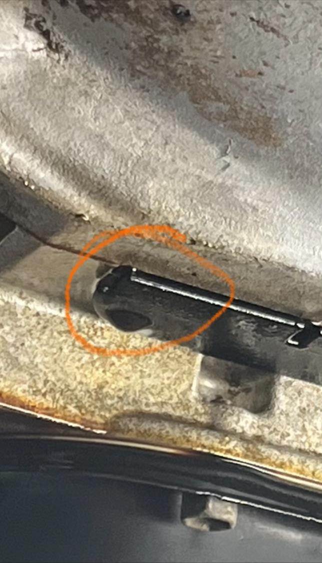

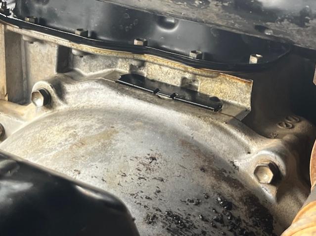

Before and after I cleaned it up to confirm the source of leak after driving it around. Look closely on the left side of the plastic plug to the bell housing and you can see a drip. It is not spotting on the driveway, but it’s dripping onto the rear skid plate where it blows off at highway speed. Can see a plume of oil back on the fuel tank skid plate cover.
P.S. don’t know why the second pic is getting flipped upside down. Tried twice with the same result.
