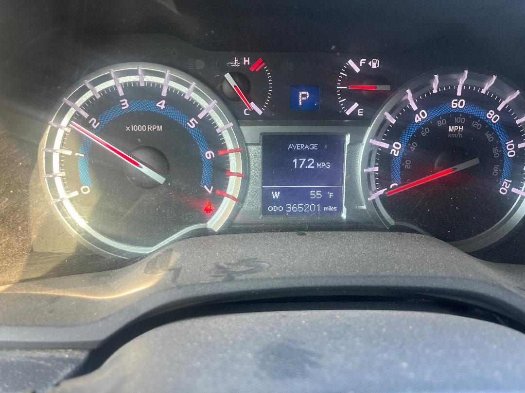

My 13 limited is around 288,000 miles and running strong. I do need to do some suspension work in the front. I know there are even higher milage 5th gens out there. Just curious how high. I do not plan on selling. Its super nice driving a paid off vehicle.
As of this morning of August 26, 2024:

1) Shocks
2) brake rotors and pads (multiple times)
3) Tie rods (1x)
4) Alternator (319K)
5) Fan clutch (332K). Should replace as preventative at 250K
6) Transfer case input seal (342K)
As far as the transmission, on harder stops from a couple gears up, if you stomp the go pedal it has a delay finding 1st gear. Otherwise normal acceleration from a stop all gear shifts are fine. I will try to look for a low mileage takeout and swap it in myself somewhere around 400K to 450K. Rear main seal started to leak, but a bottle of Blue Devil rear main seal stop leak fixed it. Still, when I pull the transmission, I will replace that seal. Otherwise, the engine runs as good as new and still gets the same fuel mileage.

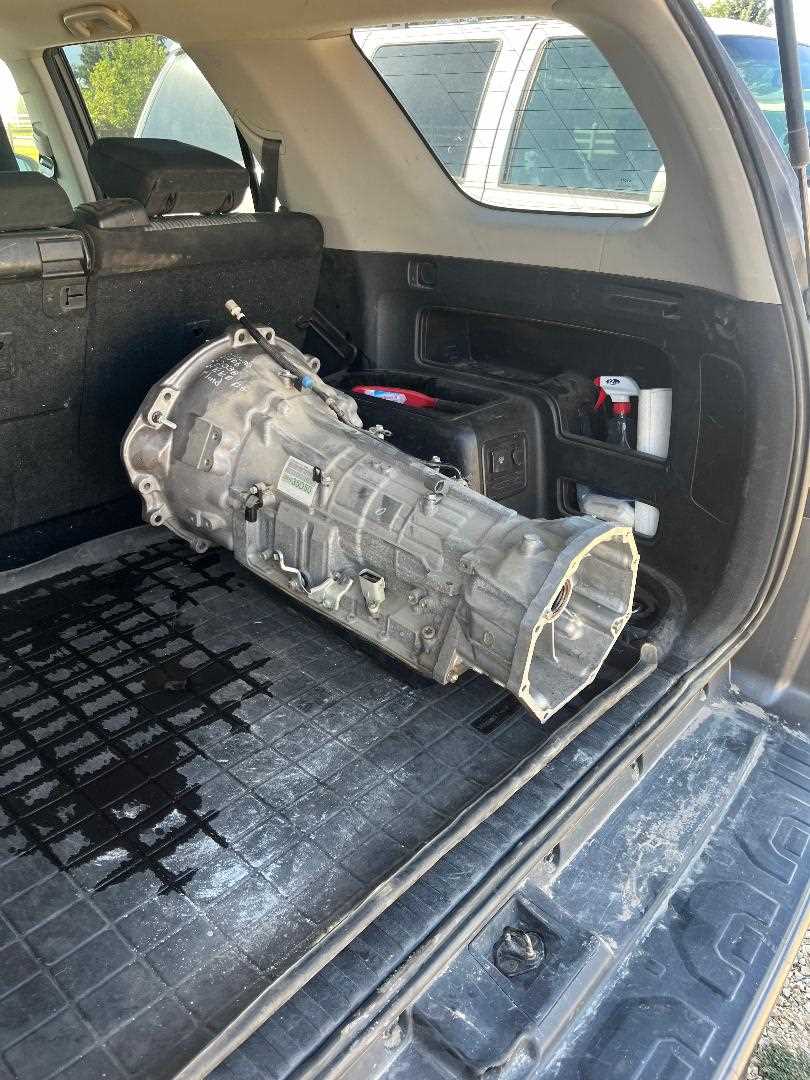

The engine in the 2014 is showing no issues. I fully expect it to easily go 500K. As noted the transmission is showing signs of going out. Confirmed this with my local mechanic. Today I picked up a takeout A750F transmission with 43K miles for $800. Seller had it listed for $942 on eBay and accepted my offer of $800. Also a provided free shipping from Spokane to Missoula.
Transmission was salvaged from a wrecked 2016 4Runner. Figured they couldn’t F up a trans that hadn’t even reached its first fluid change. I have new pan seal and filter/strainer and new rear engine seal, plus front pump and rear output seals are on order.
I threw the transmission in the back of the 2014 and drove it straight to my local mechanic for install. I would do this job, but I’m out of time on this segment at the Montana home and head back down to SoCal starting Friday afternoon and back in the LA office Monday.

As long as we have the ability to harvest organs like they do from Chinese prisoners, I have the ability to keep this 4Runner going for cheap. With this $800 transmission, I just avoided a $5K to $6K job at a dealer.
