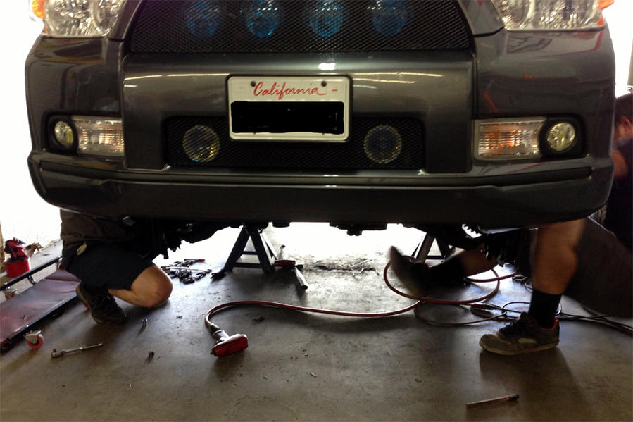

Here's the front of what the grill craft setup looks like (ignore the two guys working underneath :rolleyes: ) This also gives you a good idea on the mounting of four visionx cannons behind the grill and two PIAA 510 ion yellow fogs in the lower grill... might be time for some LED cubes down there
JC! I knew you put some lights on but holy $h1T!
