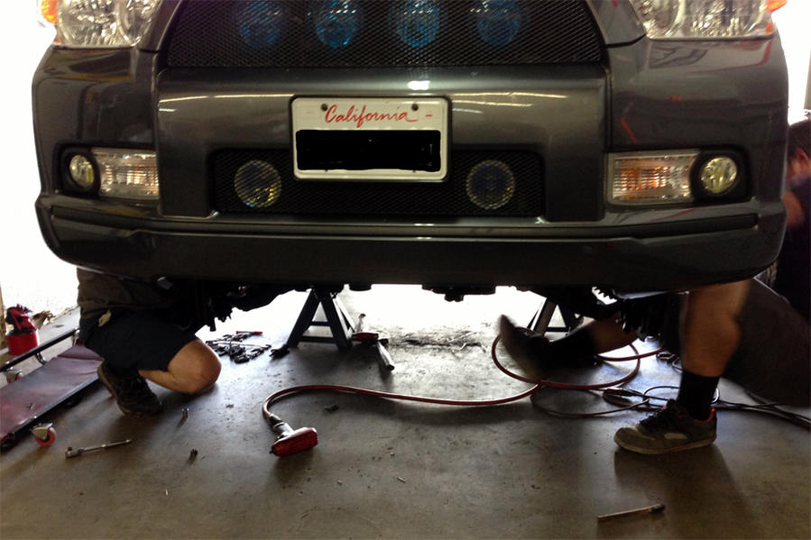

Here's the front of what the grill craft setup looks like (ignore the two guys working underneath :rolleyes: ) This also gives you a good idea on the mounting of four visionx cannons behind the grill and two PIAA 510 ion yellow fogs in the lower grill... might be time for some LED cubes down there
That is Awesome [MENTION=50210]KVA[/MENTION]
Too much getting blocked...totally get the grill or make your own...it will make a HUGE difference with that light, wiring, and bracket investment. Not to mention it will make SOcalTRAIL proud.
