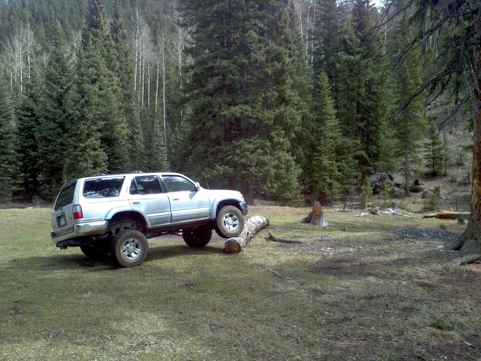

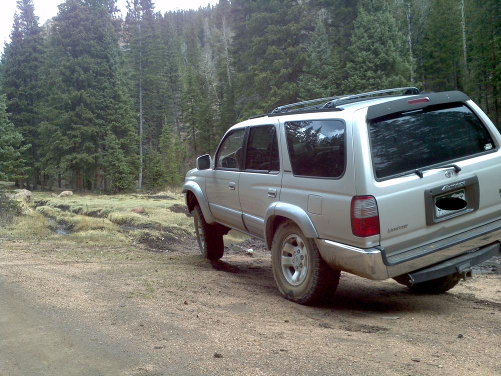

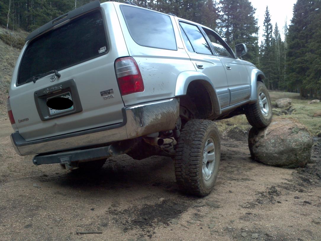

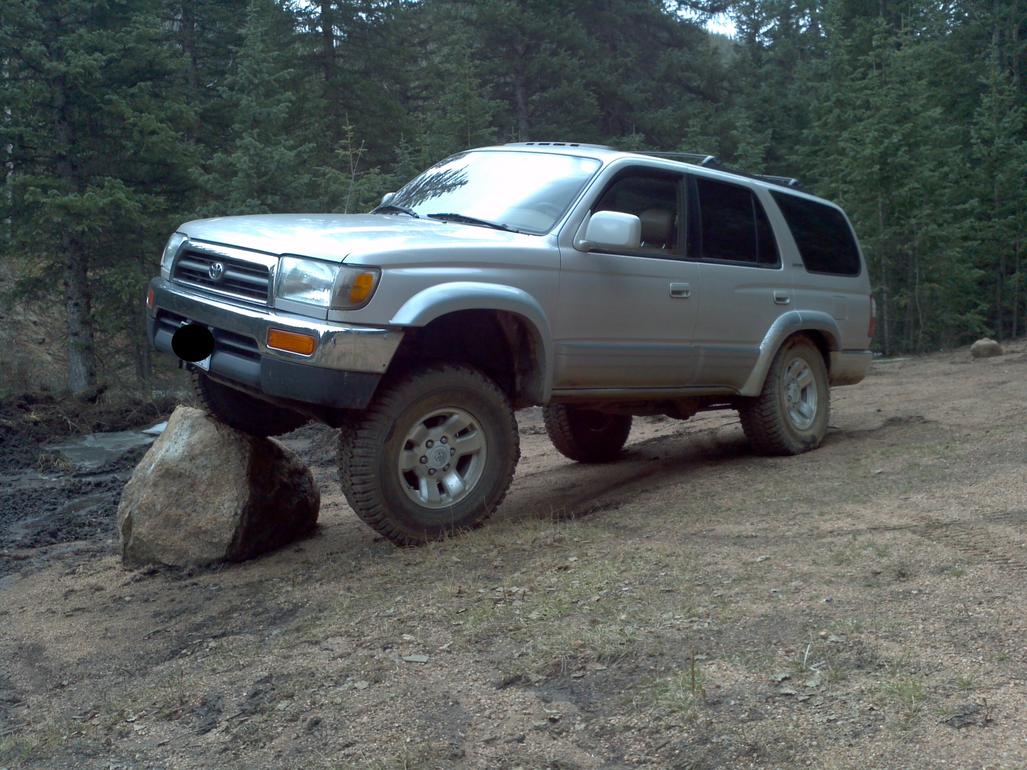

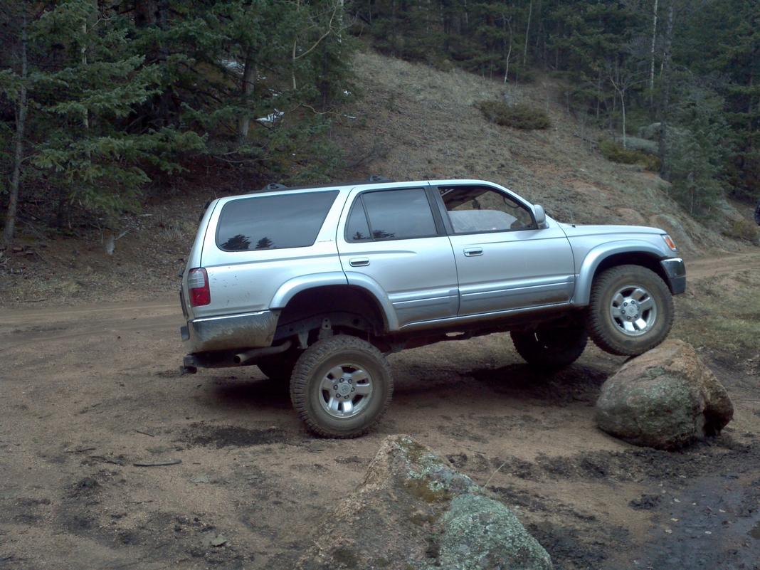

I dont see how its limiting my flex. They say if you leave it connected it limits rear flex but my axle is pushed againts my SS Daystar bump stops and can maybe flex 1-2"'s more. Im just leaving the rear connected. The SS Rear sway bar extended brackets work really well too!
Ohh and on the trail I found a rock that was bigger, that I tried too park on. It was a little too big and I almost put the 4runner on its side. LOL. Couldnt get a picture because I just backed down it. I had it on two tires. It was a little scary.
