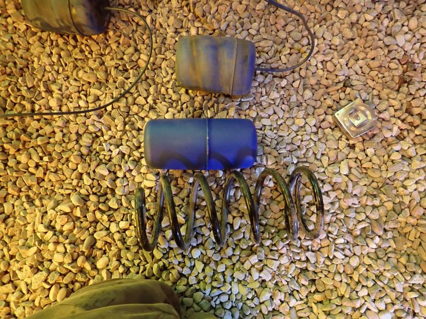

Installed the F4108 kit and it's perfect so far. Bags are ~3" taller and seem to be the same diameter (I think they expand a bit over time). Here's a picture next to OME 895 coils.
