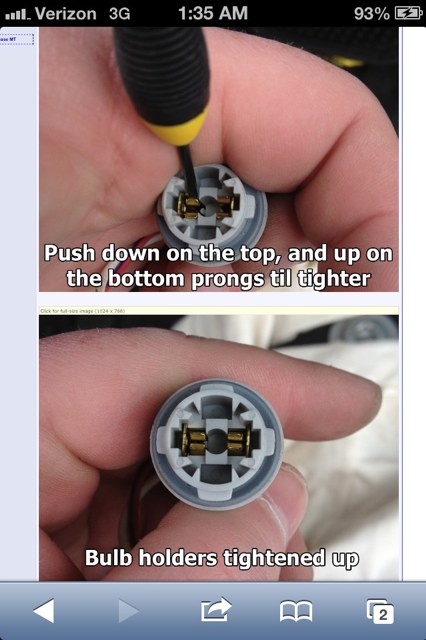

It's available through Home Depot. MAKE SURE IT'S FOR 12V APPLICATIONS. The reason for using this bulb is because it's basically plug and play. There is no need to cut off the connector like you would on the 886 bulb so there is no risk of breaking the filament or the bulb itself. All you have to do is bend the connectors in the socket of your reverse light and they plug right in.
( the pic is from the tw thread link above)

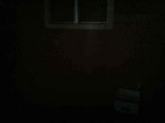

I'm sure ill get flamed for doing this but I searched and I didn't see any negative effects of doing this mod and I was willing to give it a try. My runner didn't burn to the ground when I went into reverse and the lights are super bright so I call this a success lol. Here are some pics.

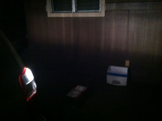

Led bulbs

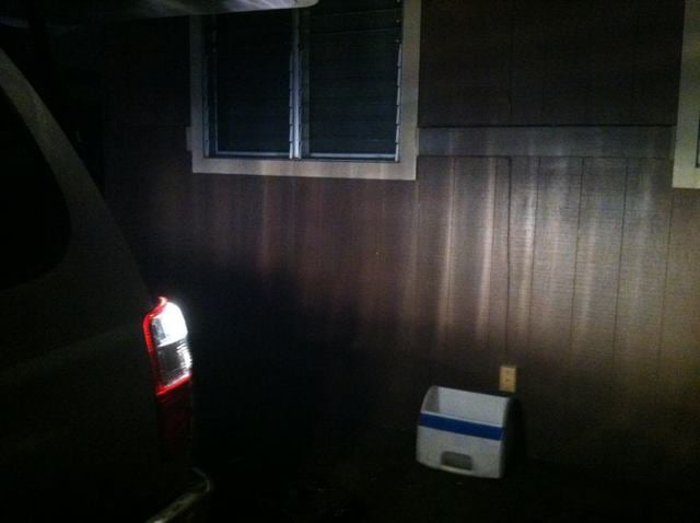

Led bulb on passenger and silverstar on driver side

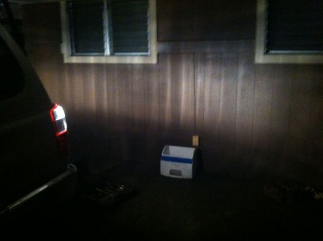

Silverstars in both sides

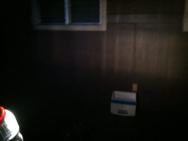

Silverstar in passenger and the upgraded Philips t4 bulb on driver side
T4 bulb in both sides
As you can see the Philips t4 bulbs are way brighter but If you're not willing to chance it then the silverstars are the way to go.

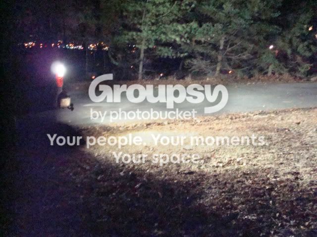

Nobody flame me,but has anyone tried real HID bulbs in their tails' reverse lights?
I used a $30 ebay kit on my old Tundra,powered the ballasts through a lead direct from the battery and a relay triggered by the factory reverse light wiring. I had the lights on for minutes to test and nothing burnt or melted. It did take several seconds to achieve full brightness,but damn were they bright!

[MENTION=88576]smkd13[/MENTION] I had to run a relay since the reverse lights get power from the 10amp gauge circuit,ballasts consume more current than that at startup. Until I can get my hands on a spare taillight,I will not try this mod. Anyone have a broken taillight to send me? As long as the reverse light area is ok.
what is the reverse light fuse rated at? 60 watts is only a 5amp max draw anyway.

Only thing about HID's is that for whoever offroads at all (even if its minor stuff), make sure that ballast is SECURE. Its harder to find spacer in the back thats nice and secure, yet easy to access in case of ballast replacement. The Jeep had a lot of room, a lot more than the runner. Vibration caused 2 ballasts in a 3 year period to cut, and heat from my exhaust cause the 3rd ballast to act up now and then.

Cougar428 what kind of LED bulbs were used in the first picture? Were they just a single LED, I am amazed to see how dim they are.

[MENTION=82289]Yoter[/MENTION] The type of lights that came with it only had 8 tiny LEDs. I ended up just putting them in my front marker lights. I also have the same set for my license plate lights. Those LEDs look like they could work well especially since they are so big. If they aren't that expensive I would say go ahead and give them a try. I'm kinda curious myself to see how well they work.
