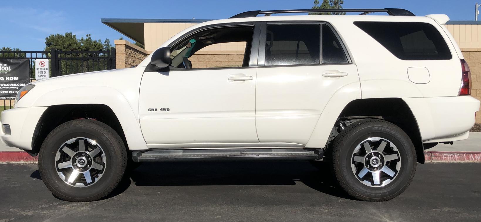

Here’s a link to a post I made with an image of my lift.
https://www.toyota-4runner.org/3120847-post6460.html
I’m around 21” front and 24” rear center hub straight up to fender. Now that I’m giving this a critical look, I think going to .85” will actually be perfect. Running boards will be nearly level and there will still be a nice subtle front rake.

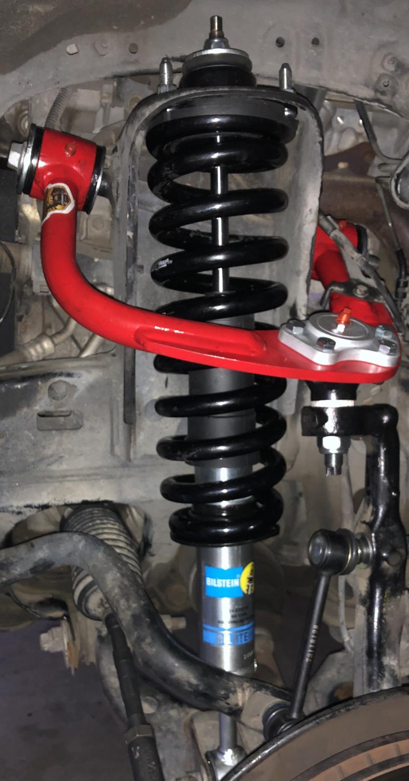

Ok, got it in on 2nd perch of the 5100 and drove about 20 miles and measured. Currently front is about 22” center hub to fender. Rear is about 24” center hub to fender. I do have that lean on driver side about 1/4” but more noticeable on the driver rear. There is a slight rake but i think it looks ok. Gained 2.5” up front and 3” in the rear from old oem shocks/springs, pretty sure they were sagged.
At first I was just going to do the springs and shocks but noticed bad ball joints so I decided to get jba uca (wasn’t able to press the oem ubj out and thought the jba uca was a good future investment) and moog Lbj. Also installed new moog tie rods.
Just need to get it aligned. Also no more clunk when slowing/breaking to a stop.
2004 4unner v6 sr5
