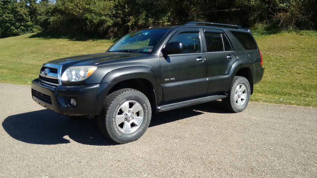

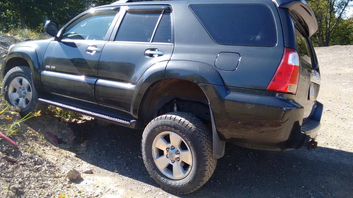

I have T12s with OME883 up front. My rear height measurement is 24.5 from hub center to wheel arch trim. You can compare that to your current measurements for an idea of what to expect. I have 10,000 miles on mine and am pleased with their performance, a bit of lift with a stock like feel.
Thanks for providing the measurement, I am thinking about getting these as well. Now we can have a hard number to compare.
Do you have a pic you could share? And what size tire are you running? Thanks
265/70/17
