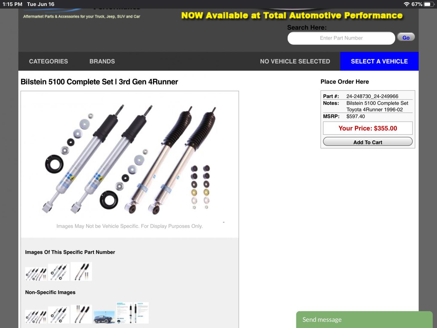

TotalAutomotive is having a sale on Bilsteins, see what they can do for you. I just looked at this on his site.
