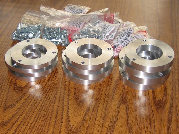

I could have saved you some money with my spacers! They are made to the same exact dimensions as the Cornfed spacers, but they are made out of a more expensive aluminum with a higher resistance to corrosion.

No, I had a total of three sets of the 1/2 spacers. I used one set, so now I have two sets left. My buddy made sets of extras for for all three sizes. He said that it\'s easy to pop out multiple sets after he sets up his lathe, so he made a few sets of each!
Here is a pic of exactly what I have left:
2 sets of 1/2 in spacers
2 sets of 5/8 in spacers
2 sets of 3/4 in spacers
Sorry I miss read your post.
