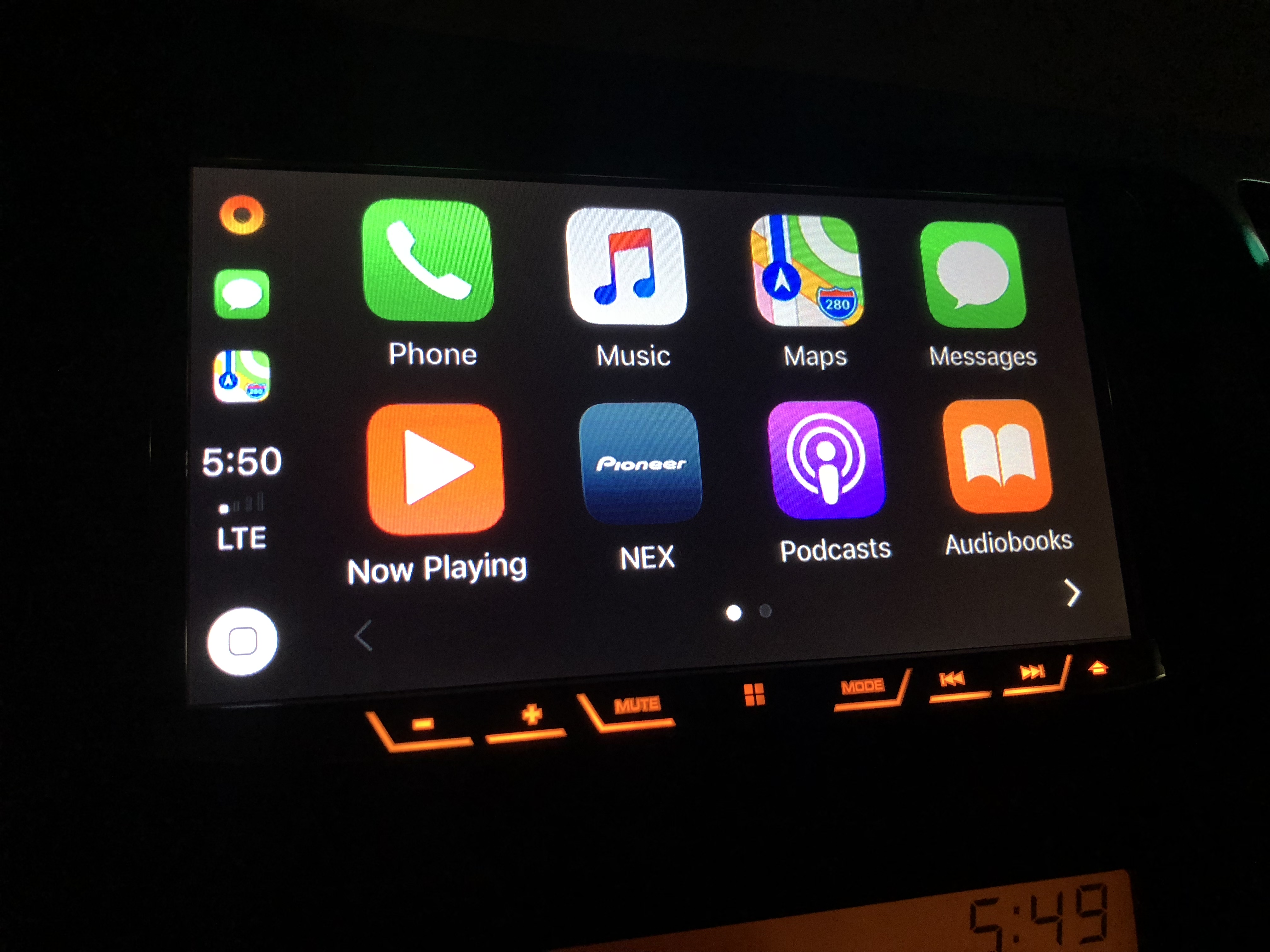

After finding a used Pioneer 4100nex head unit for cheap I finally got around to installing it. Ordered up the extra parts from Crutchfield and the install was pretty straightforward. I have some extra parts coming to join the two antennas into one. I also purchased a Pioneer backup camera that I will install at a later date. Thinking once I install a spoiler I might be able to mount it either into the spoiler or where the original 3rd brake light is. That will give me a good view and judge of distance.

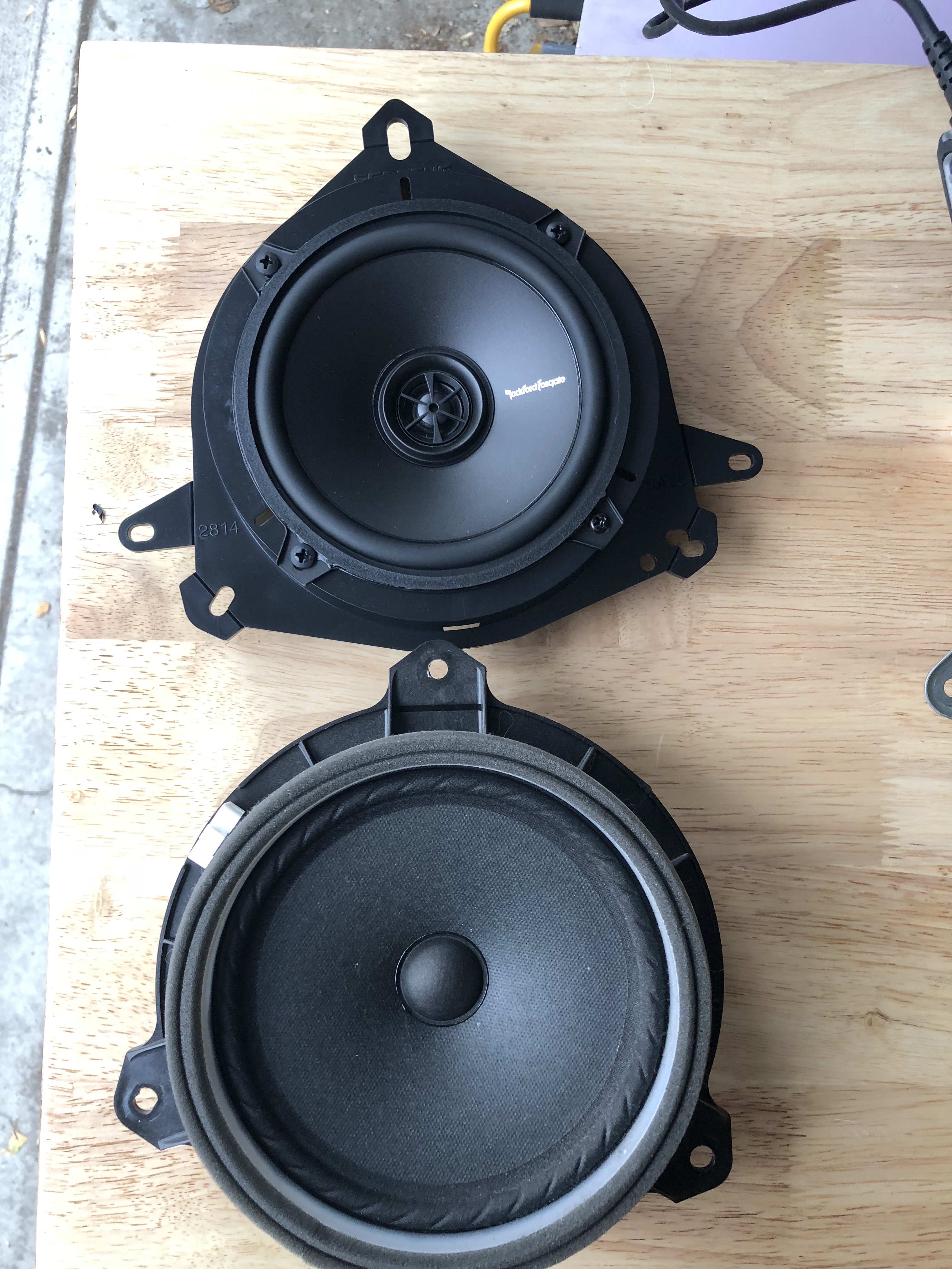

After installing the headunit I was amazed at how much the sound quality increased with the stock speakers. It was 10x better and actually had some control. Going another step further I purchased some inexpensive speakers from Crutchfield (front power and tweet and rear speakers). I went with the Rockford Fosgate R165-S Component Speakers for the front. Rockford Fosgate R1525X2 for the rear. The speakers were on sale and had good reviews so I figured why not. Didn't want to spend $500+ yet.

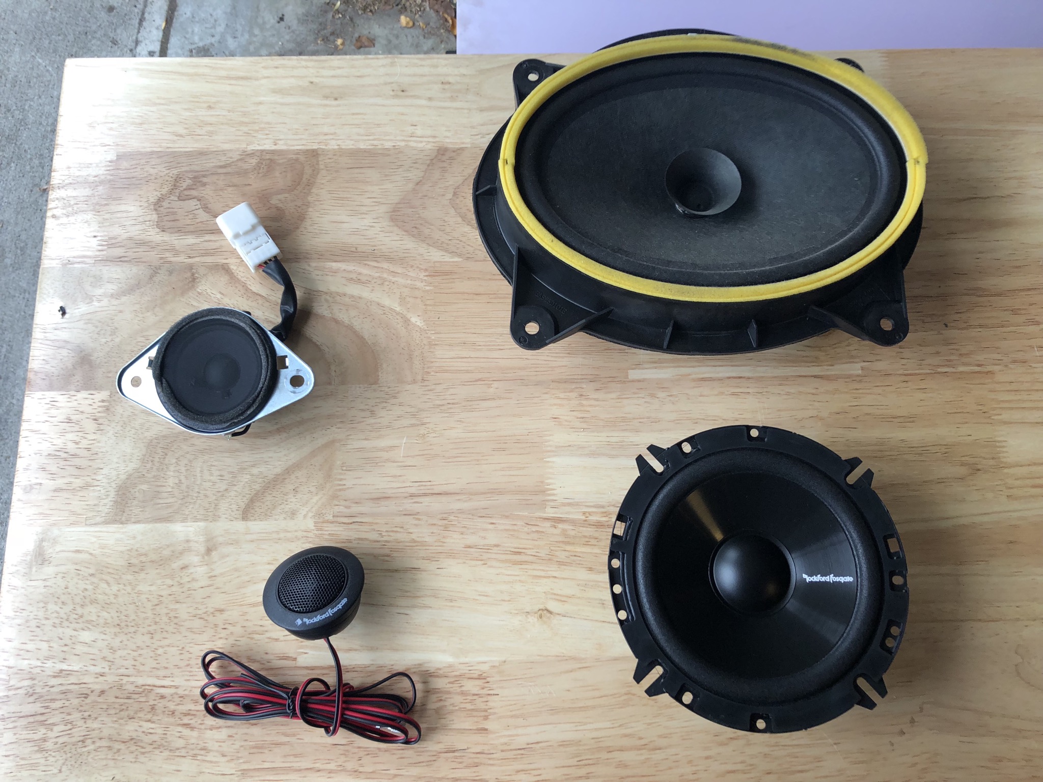

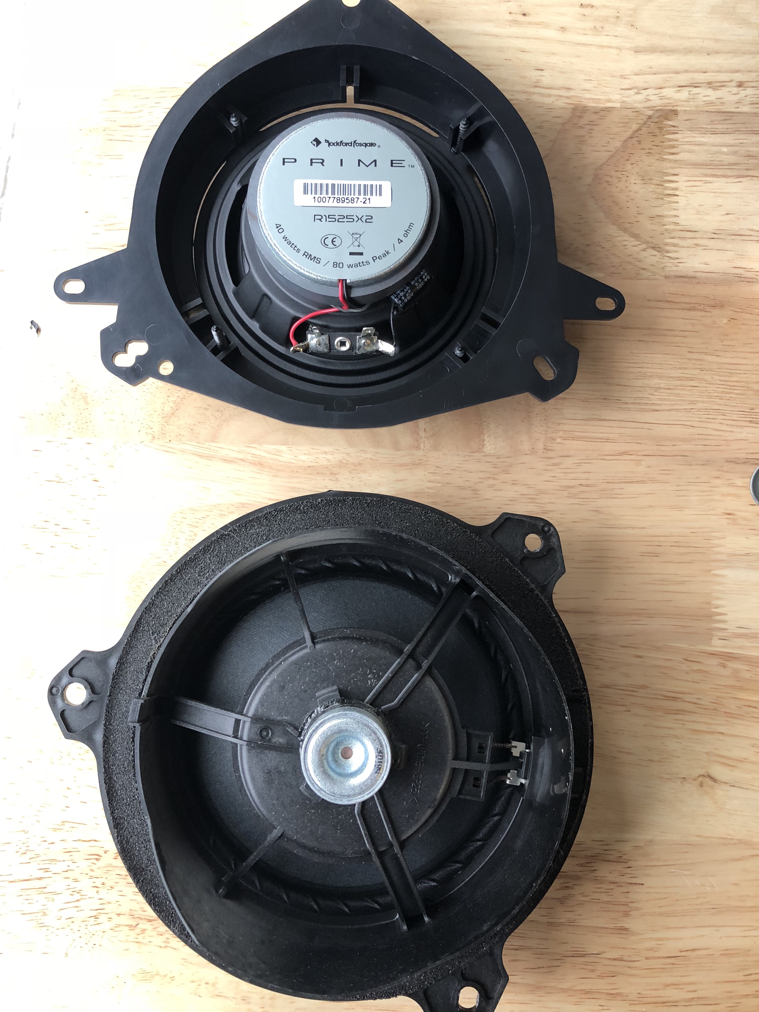

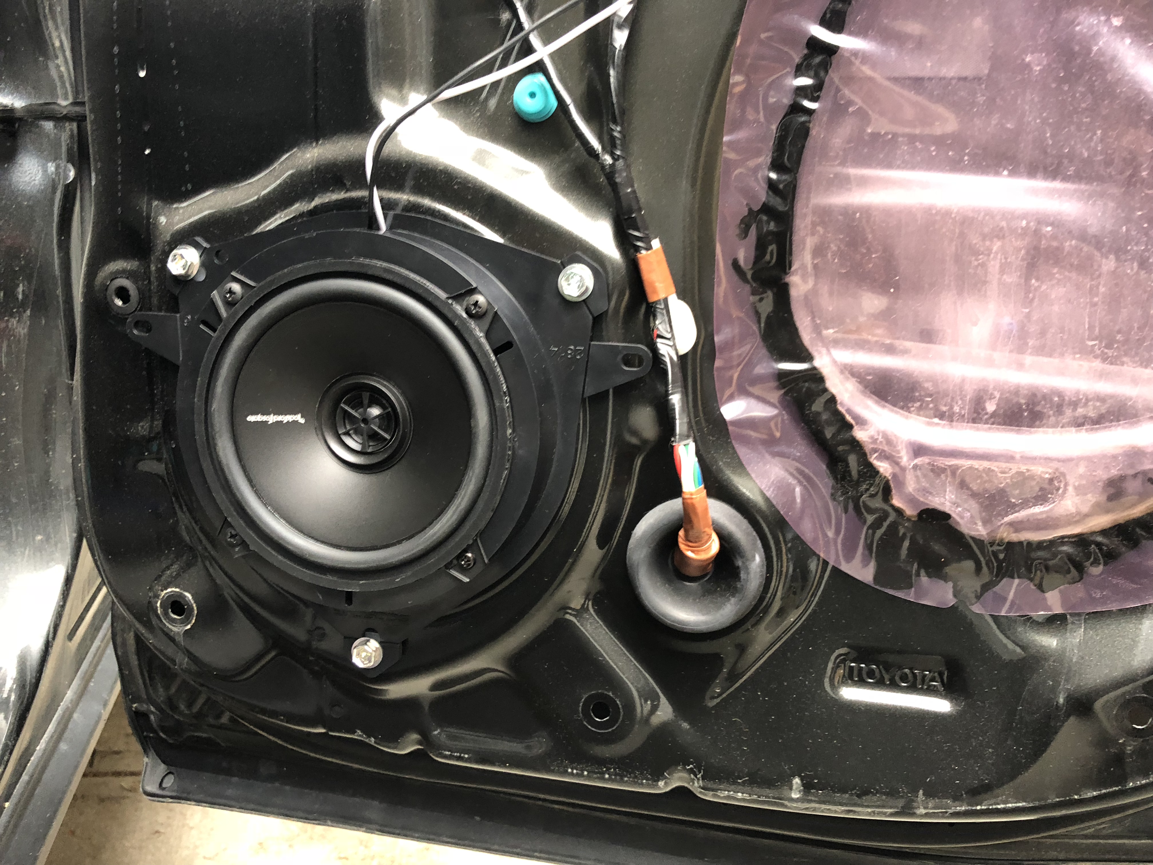

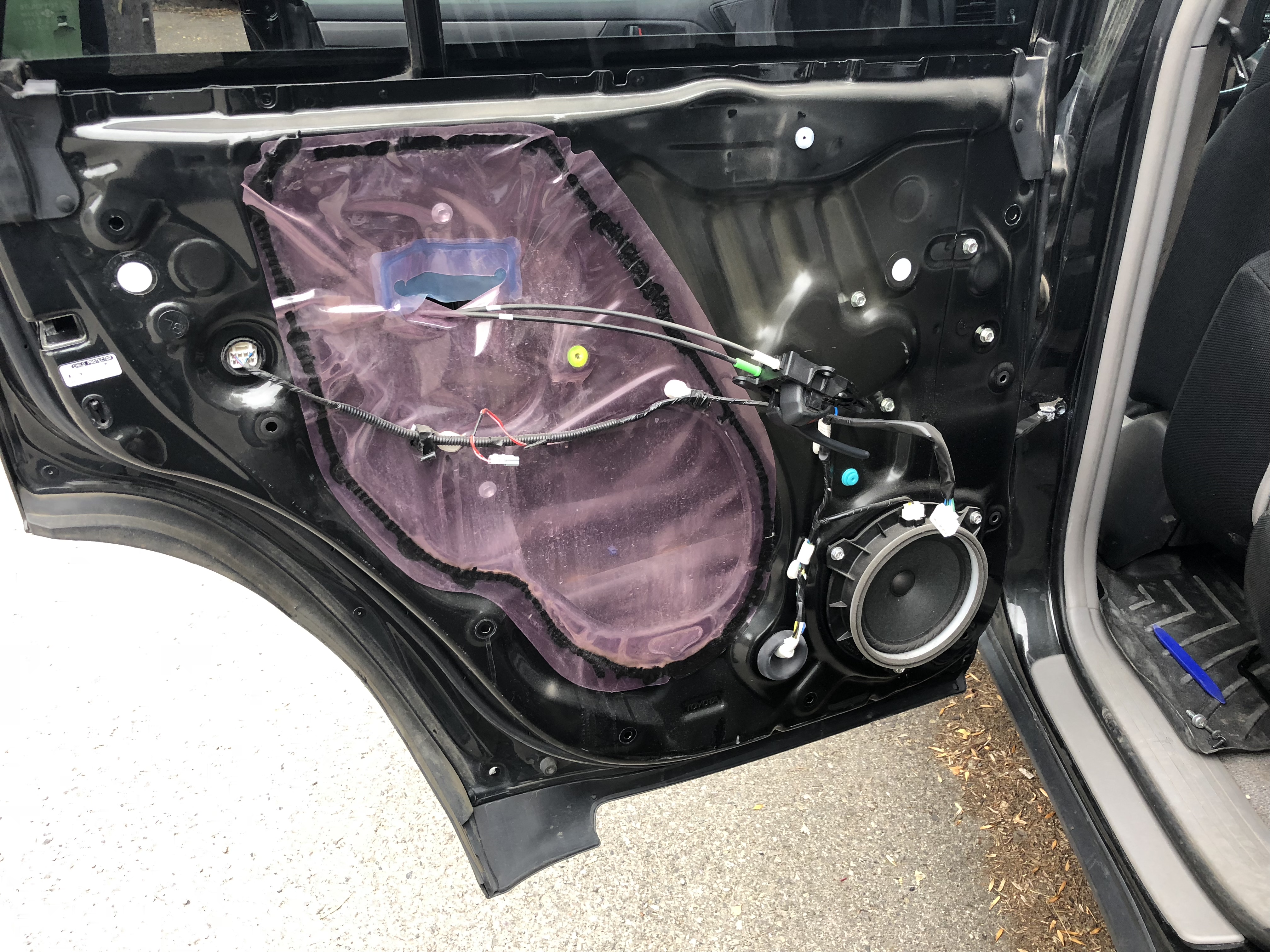

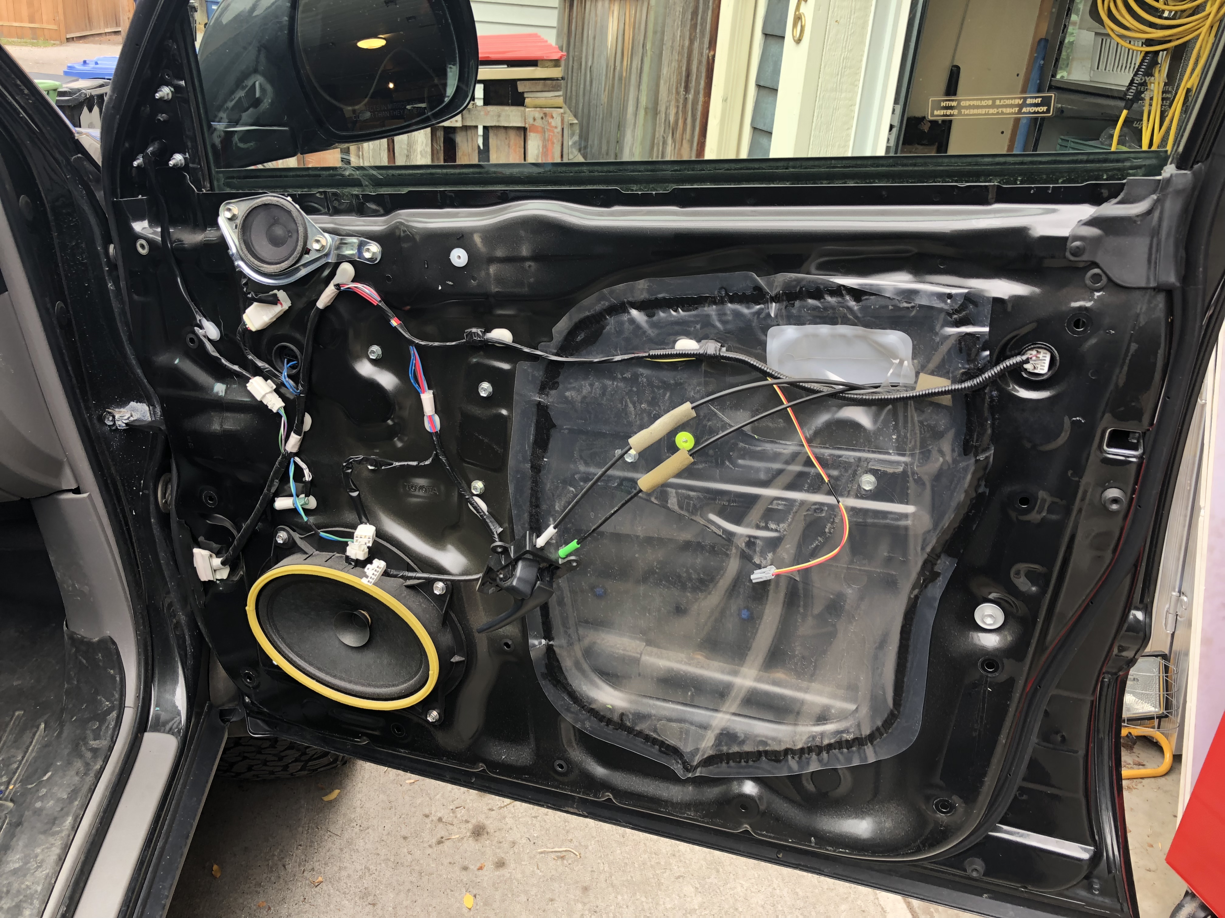

Yesterday I got around to installing the speakers all around. Went fairly easy, realized I did not purchased Crutchfields universal backstrap for the tweeters so a quick stop at the hardware store and some plumbers strap seemed to work just fine. Looks a little diy but nobody will be seeing that.
Instructions were pretty straight forward and only got stumped at one spot.
But all in and they work. In hindsight I probably would have left the stock speakers or spent more on the aftermarket ones. The new ones sound a bit better but not a lot. Usually I'm the type of person to spend extra money and get something that much better so this just reinforces that notion.
Overall happy with the full set up though and learned some more stuff about this truck.

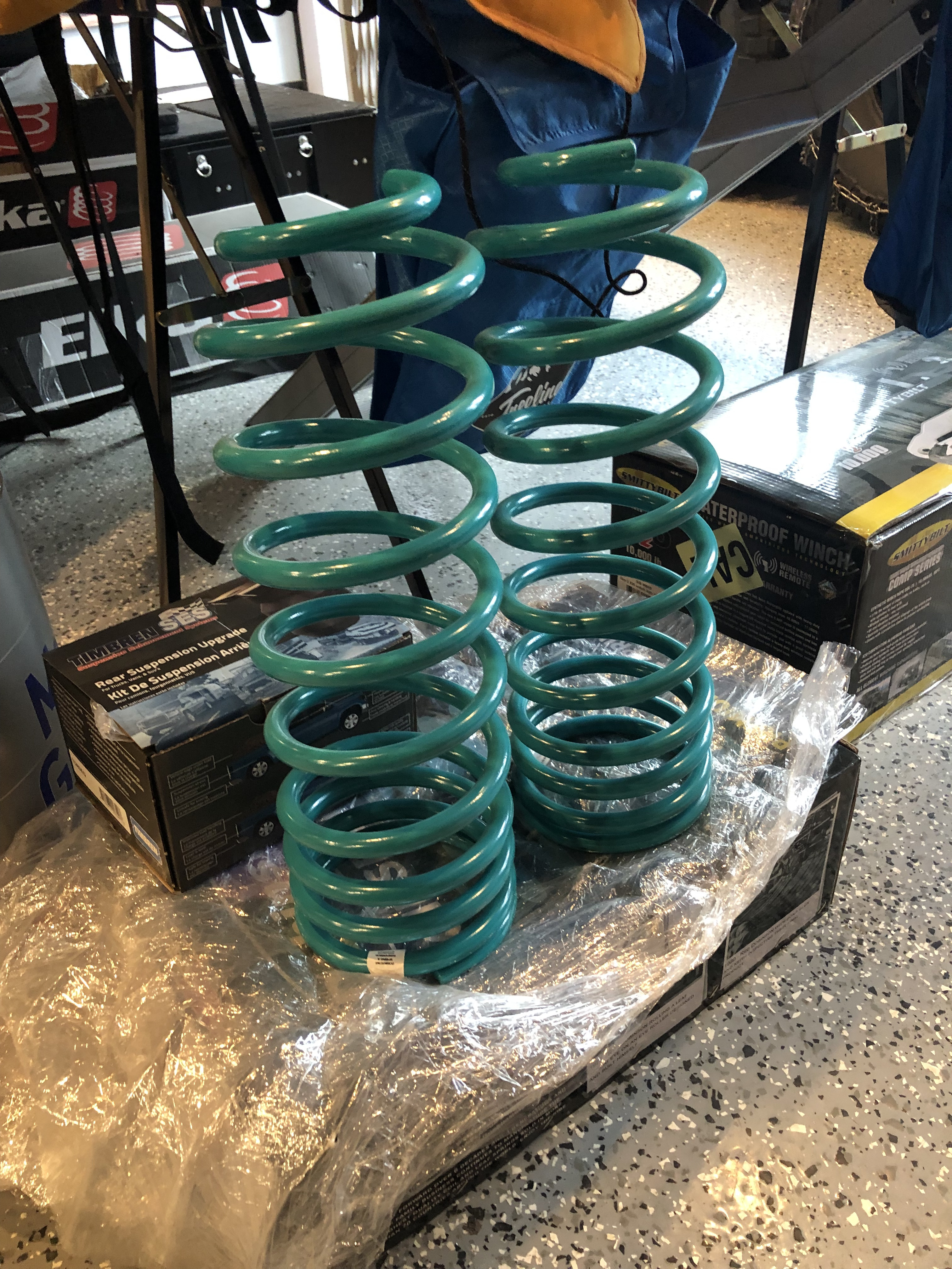

I am finally getting around to piecing together my proper lift kit to replace my Daystar 2.5/1.5. I've been researching this stuff for a couple years for my rig and think I've got it pretty dialed in. Looking for 2"-2.5" up front and 2-3" rear.
Here is what I've got planned:
Front:
Fox 2.5 Coilover non res
Total Chaos UCA
Extended SS Brake Lines (installed)
DuroBumps front Bump Stops OR Wheelers Superbumps (to be purchased)
SwayBar Relocation Bracket (to be purchased)
Rear:
Fox 2.0 w/ Res. & Adjuster
Dobinsons C59-675V Coils (to be purchased)
DuroBumps rear Bump Stops or Wheelers Superbumps(to be purchased)
Pro Forged Extended Rear End Links
Wondering if I've missed anything?

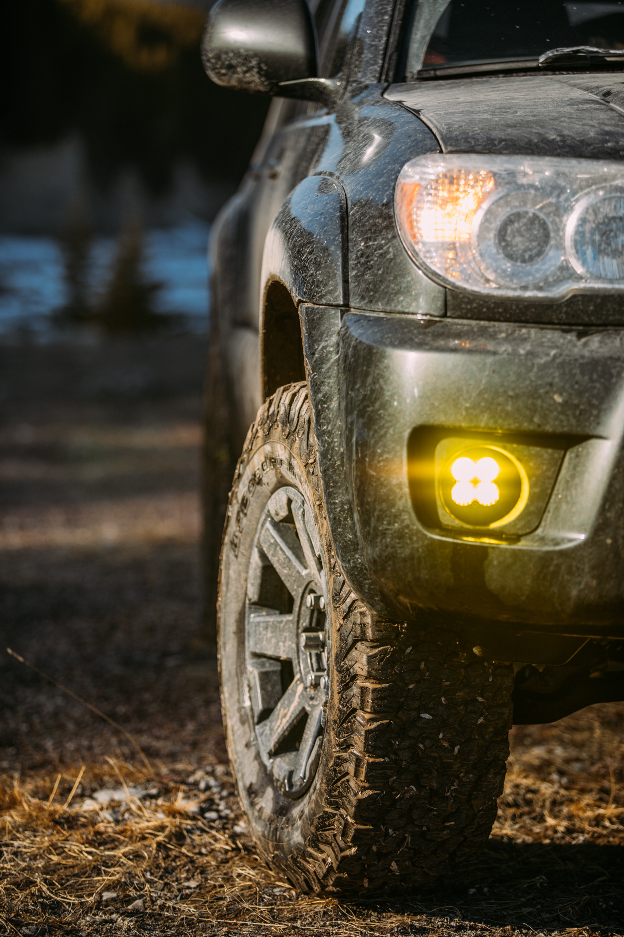

I have never been impressed with stock fog lights on any vehicle and this one is no different. I even put LED's in them to see if that would help but it still really only lit up the 3 feet in front of me.
So these lights have been on my list for a while and finally just pulled the trigger and installed them. It was unbelievably easy!
I followed YETIX Instructions and they fit like a glove. I did have to reverse the polarity on the connectors but that was it. Luckily I had one of the tools laying around that was designed for this cause before I found it I could not get the pins out for the life of me. Here is his build page with that info:
YETIX Build and Adventure Thread aka Travels with Savanna
I opted for the Squadron Sports over the Squadron Pro's because I wanted to be able to use them on the road in snowy or foggy conditions. I've heard the Pro's are just too damn bright.
The Sports seem to be a perfect level and love that I now have functional fog lights.

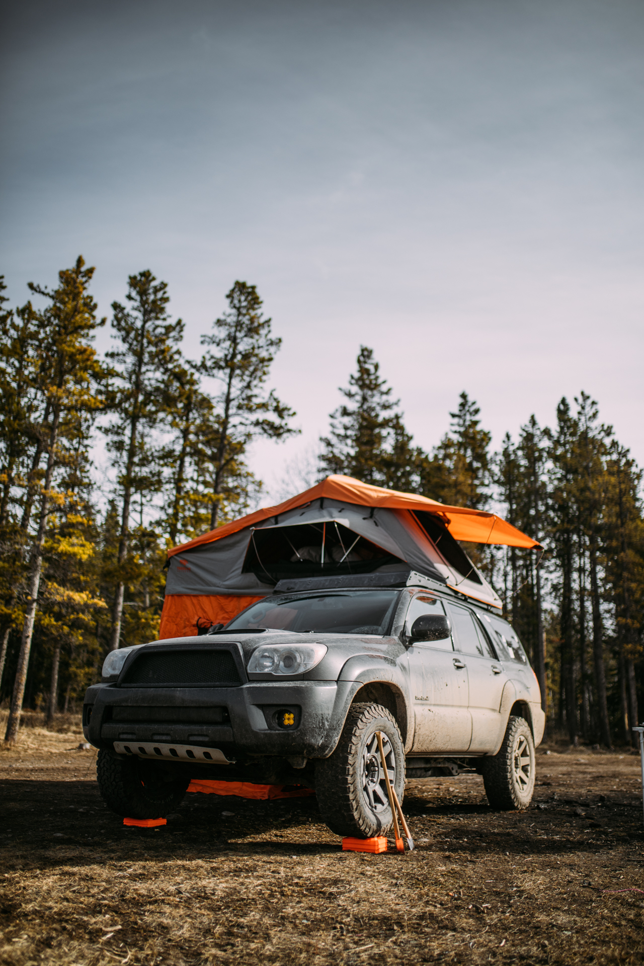

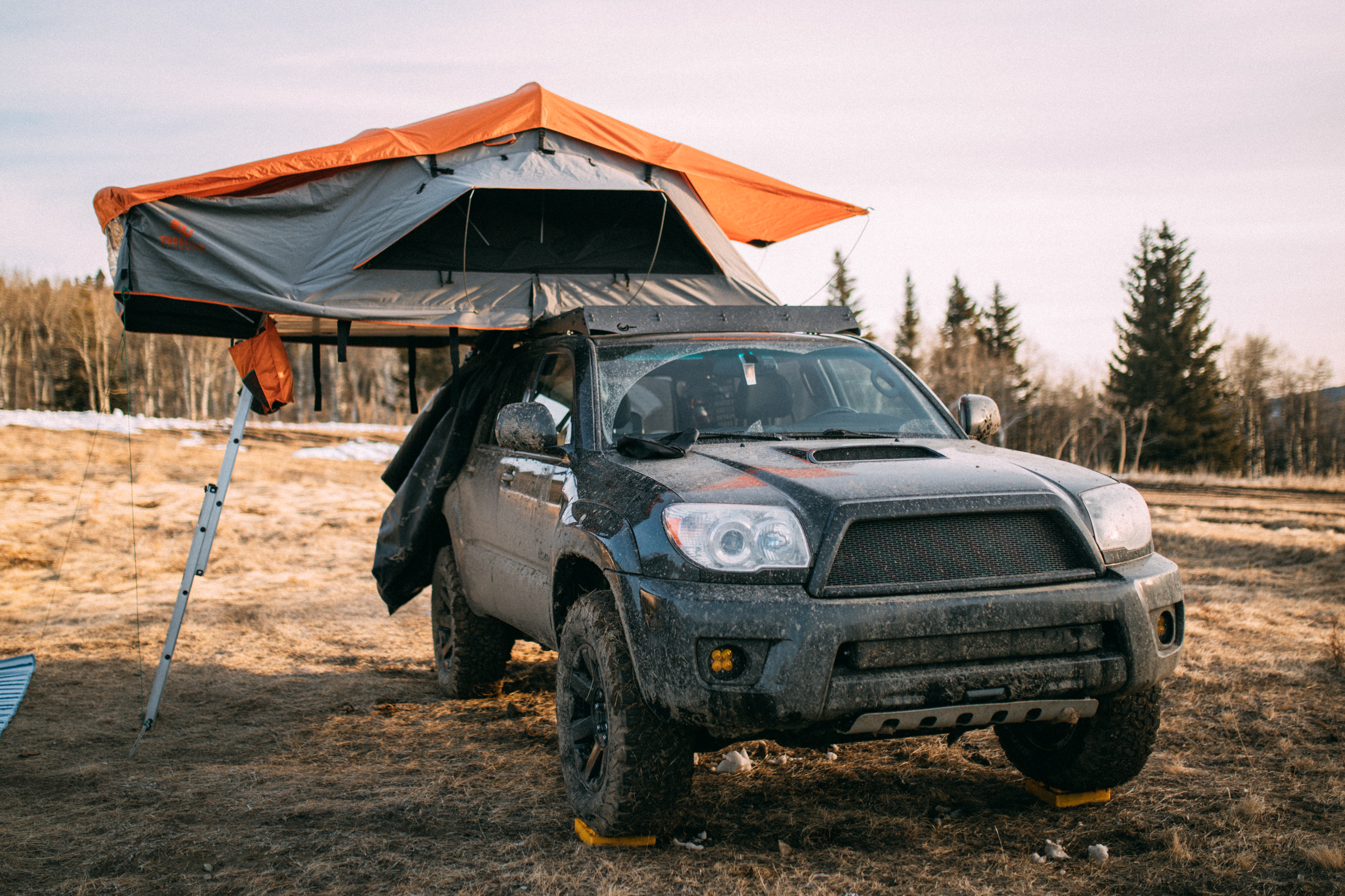

We've been blessed with some unreal weather here the last few weeks (about damn time, that was a long winter...)

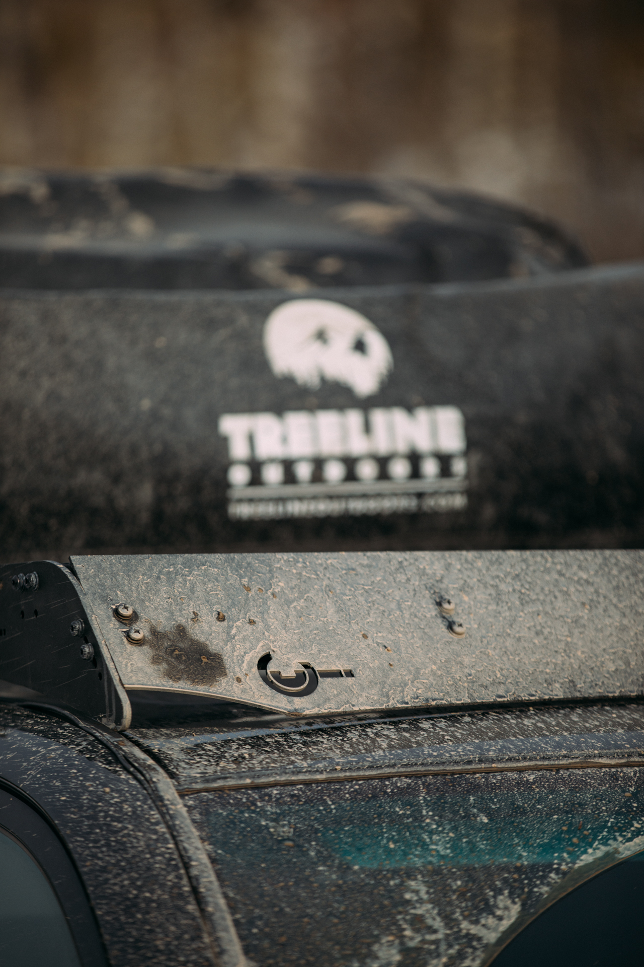

Finally got to test out the new-to-me Treeline Outdoors Rooftop Tent I bought at the end of last summer. These tents are amazing, plus local to where i'm from (Alberta.) Plus got to give my "mostly stock" 4runner a good testing before I put the new goodies in. I didn't get many shots of my own 4runner but got some actions shots of the other guys.
Loving the Prinsu Rack and the RTT. NOT loving the mounting system. Really limits where I can put the tent as I can barely reach my hand underneath to tighten the thing down. Good thing is it'll slow anyone down trying to steal it.
Anybody using any of the tent risers or RTT quick mounts?

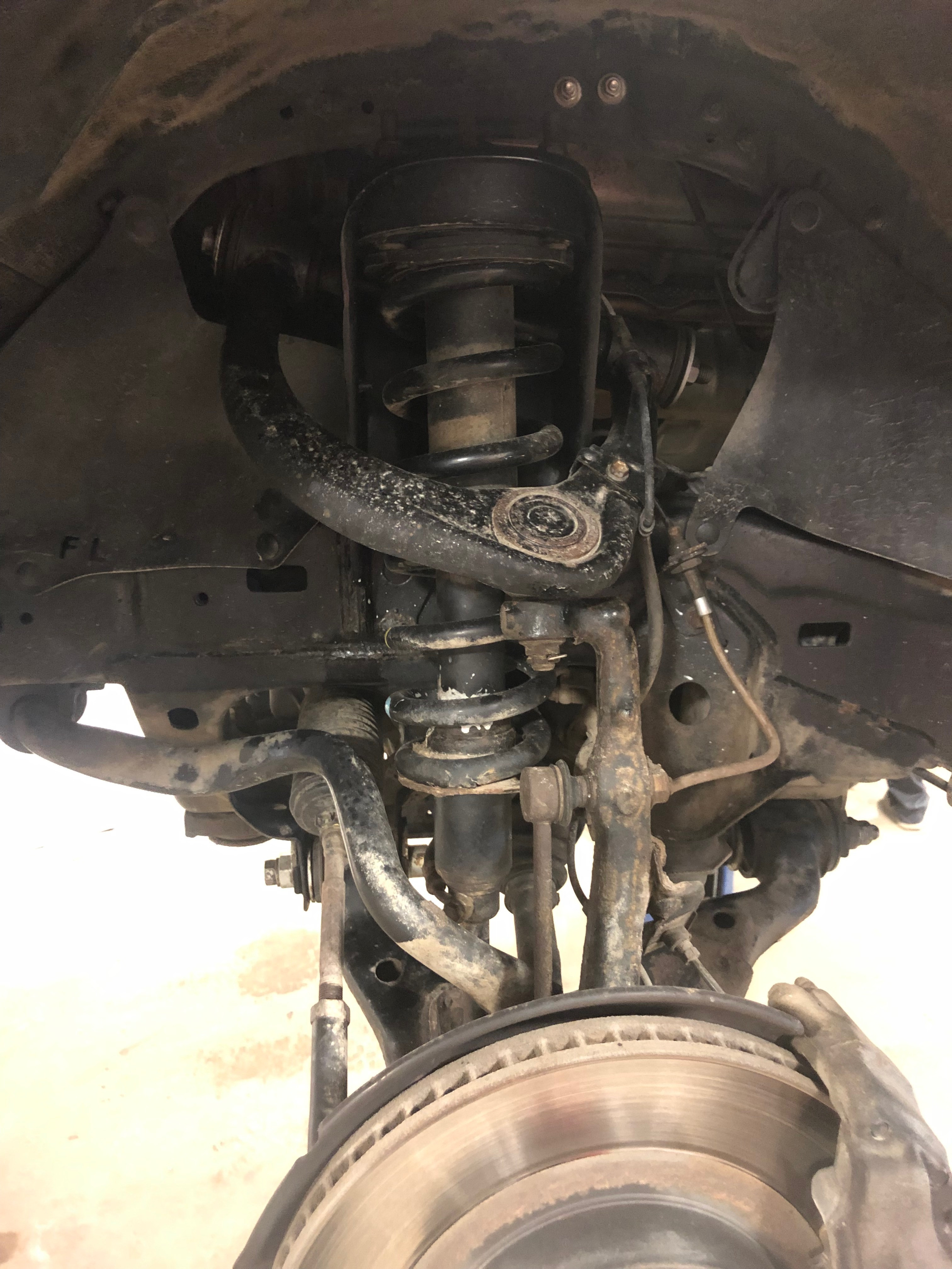

The local shop to me told me about a Canadian company; Elka Suspension, that was getting into the truck market. They come from a world of UTV's, ATV's and snowmobiles. I figured I'd give it a try and support a Canadian company at the same time. Currently at this time they do not offer these shocks for a 4th gen 4runner so Krave Automotive (my local shop) worked with Elka to get the correct bushings installed from the factory. These shocks come with 13" x 700lb coils (I believe) so I have a set of 14"x650lb Eibach coils installed as well. This provides me with a bit more lift and a softer spring rate (no front bumper as of yet.)
I paired these shocks with Total Chaos UCA' with a delta Joint pressed in (apparently better suited for our climate up here.) I put 2nd gen 4runner rear end links on (longer) and went with a pair of Dobinsons C59-677V rear coils. Timbren Bumpstops in the rear and I've got front ones on the way.
I've had this kit on the vehicle for about two weeks now and absolutely love it. I don't have much experience with aftermarket shocks so my comparison is coming from a spacer lifted stock XREAS suspension but these feel amazing. The shocks front and back have dual speed compression adjusters as well so I've been playing with that and tweaking to my liking.
Before:
After:

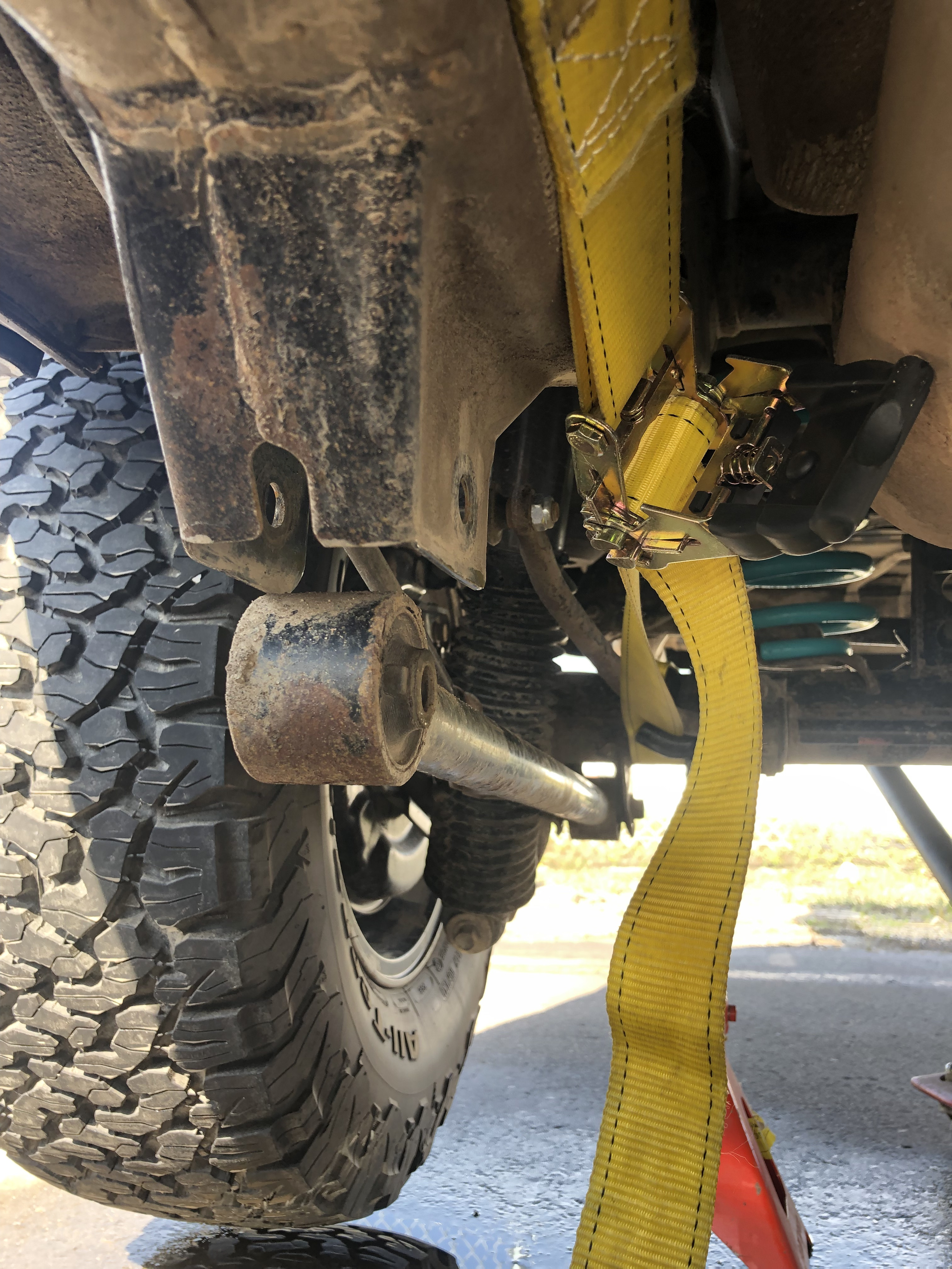

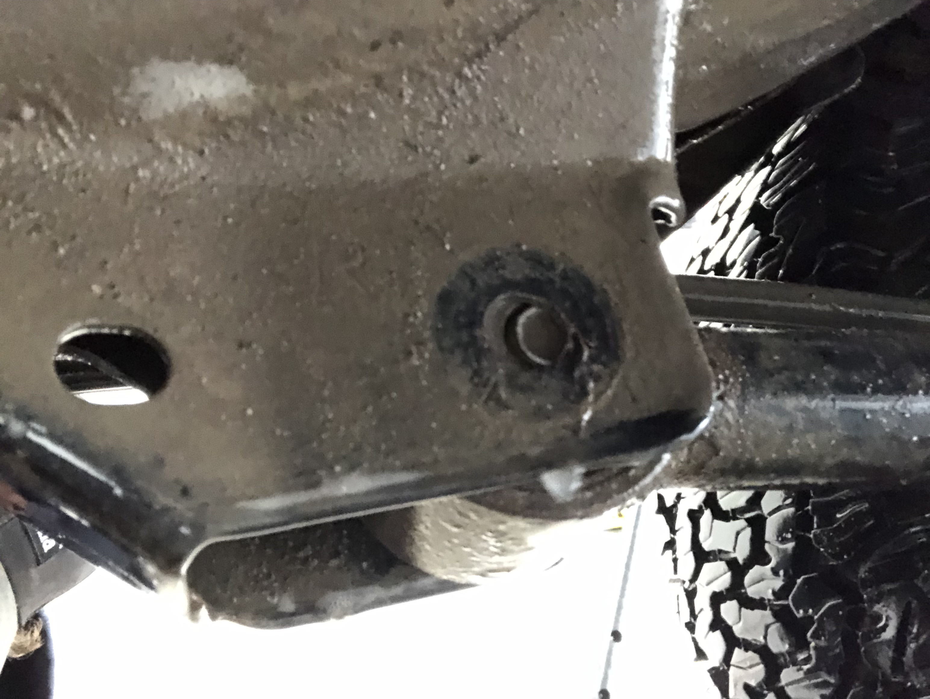

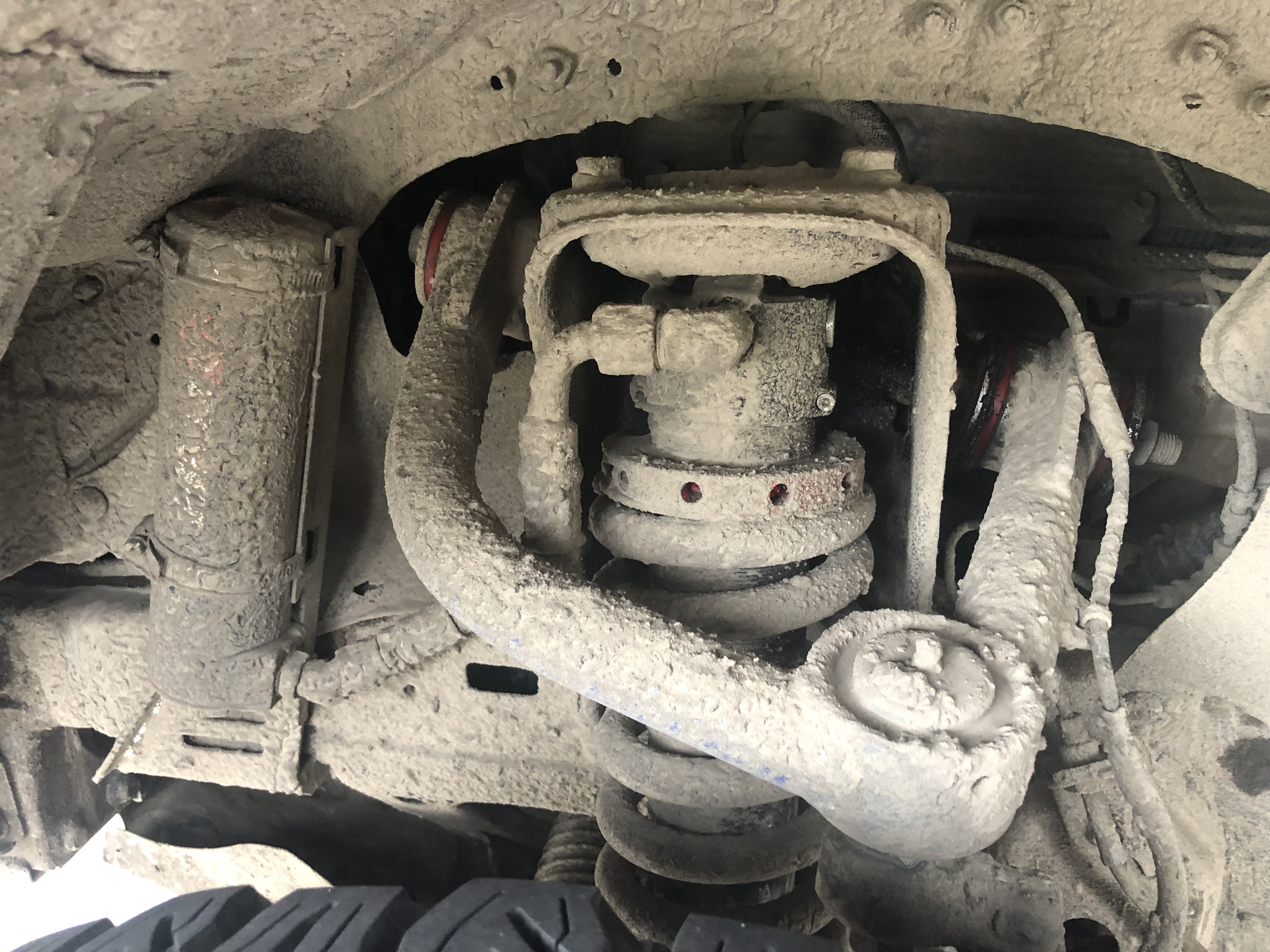

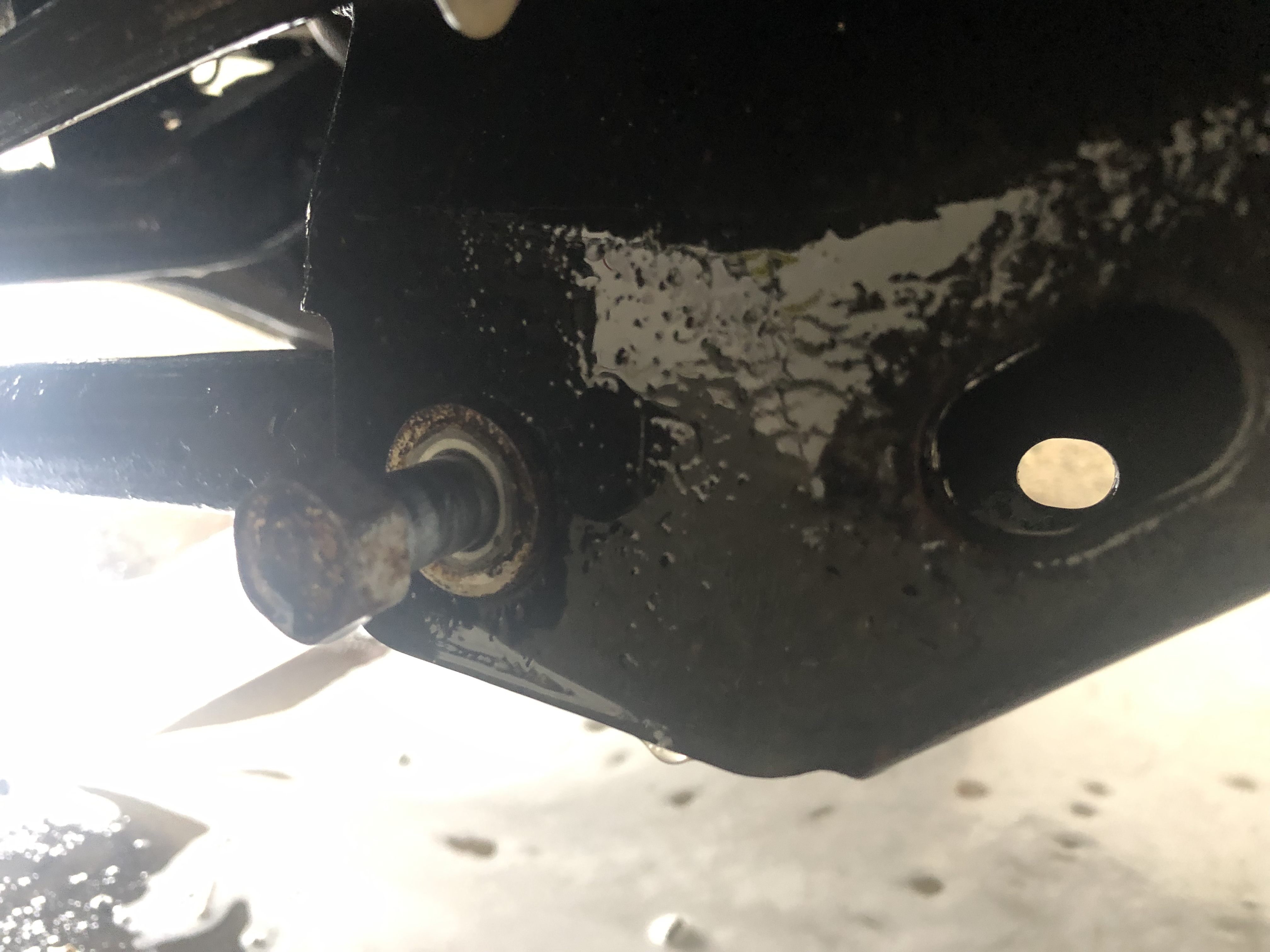

I Got back from a 700km trip and while I was getting the mud off as thoroughly as I could I noticed this:
Rear Lower Control Arm nut fell off somewhere and the bolt almost backed itself out completely. I did not feel anything strange but I'm pretty happy I caught it when I did. Can't imagine what would have happened if that arm dropped while on the highway.
Managed to get a new nut on in the parking lot of work. I had to use a ratchet straps to get the bolt all the way back through.
