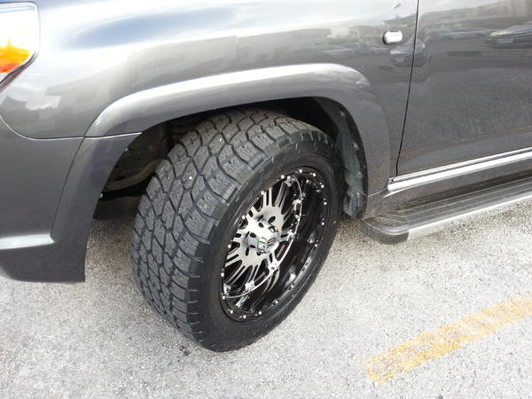

I'm running KMC Hoss XD795 20x9 wheels with BS of 4.5 and offset of -12 and Nitto Terra Grapplers 285/50R20.
I too would like to see some pictures of a Limited with lifts/ wheels/ tires. I had no idea when I bought the Limited that I was so limited in tires. Had I known, I might have got the SR5, many of which have more options than my Limited anyways, but that's another story.
