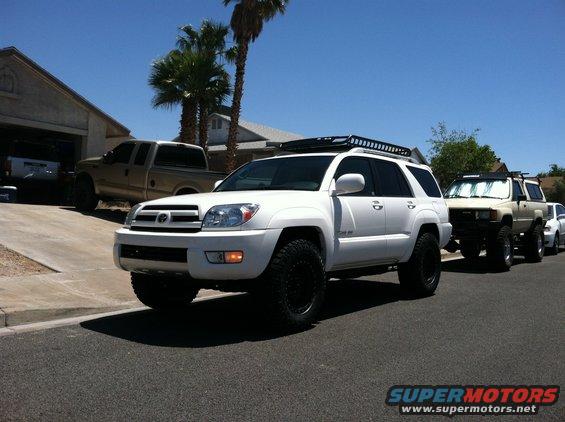

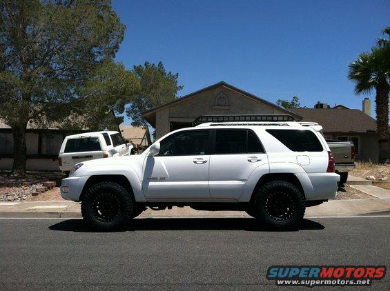

I am currently in the same situation with my 05'. I am running 285/70/17 stick rims, I tried mounting without the spider trax and they wouldn't even clear the UCAs. You need the wheel spacers for sure. I have 2.5 inch too spacer and fj coils. The height works just fine. You will also need to push in the fender wells and trim about an inch or so off the corner of your bumper where the liner used to attach.
