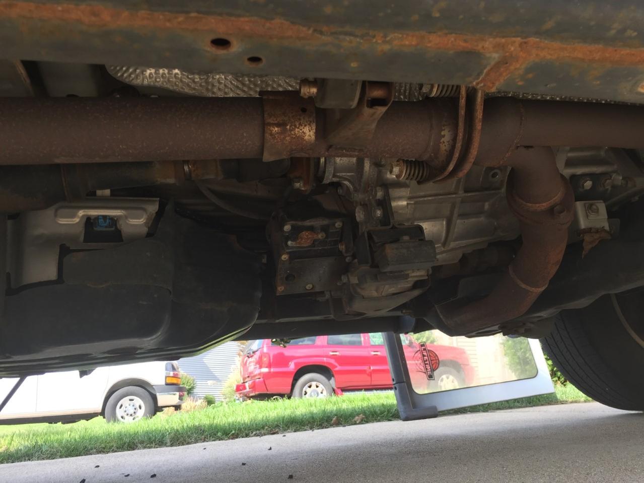

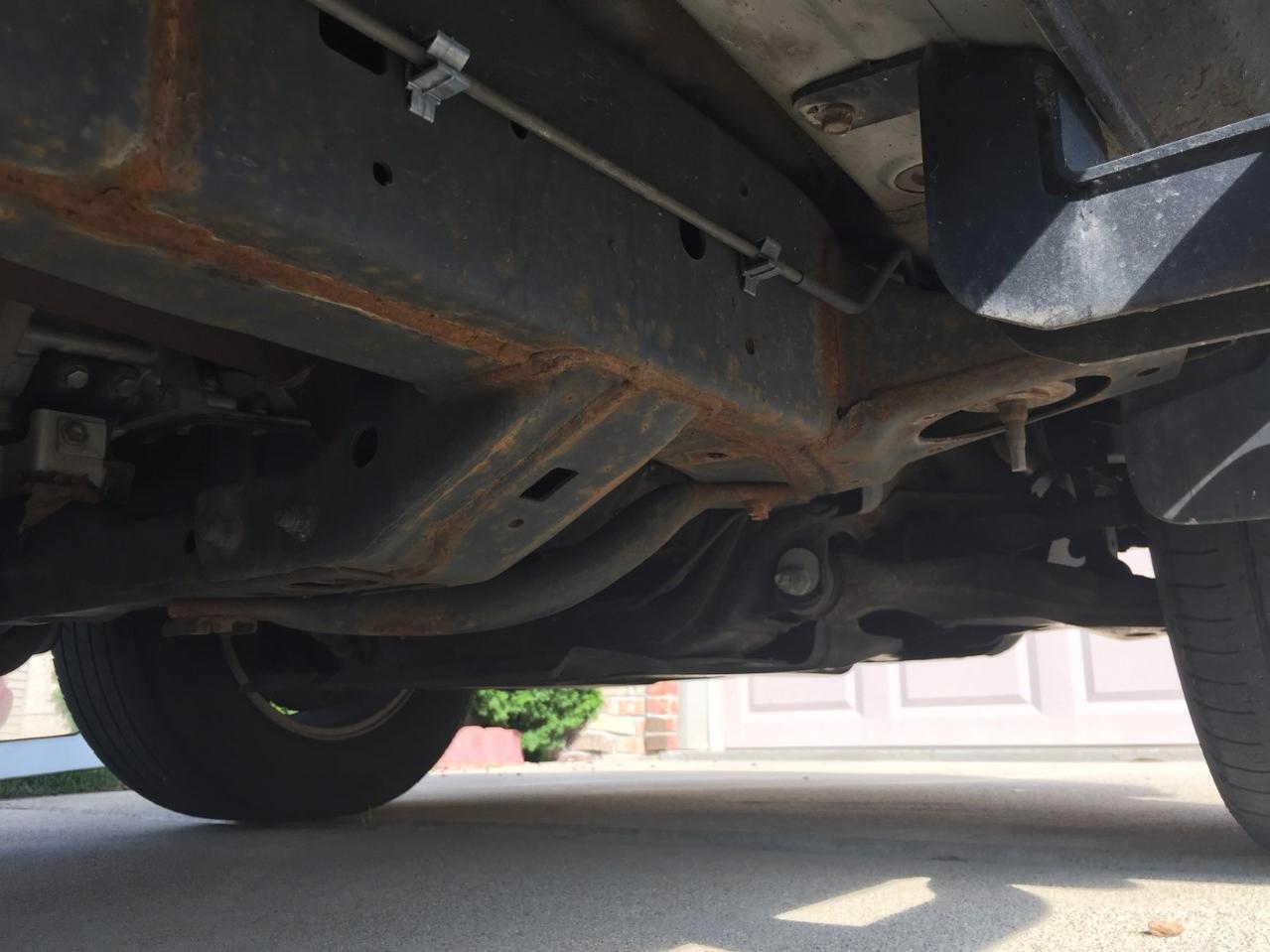

i got some pics from the seller of parts of the frame. this looks to be surface rust on the weld seams, rest of the frame is still factory black & looks solid in these areas. i will inspect it fully when i go see it but does this look "normal" or acceptable? it is an 07 with 120k miles.
if the frame is still solid is it a good idea to wire brush the rust & paint or undercoat it?

I am no expert, but to me from what I see, that frame looks acceptable..:hungry:
I use this 3M stuff on rust. https://www.3m.com/3M/en_US/company...p-Rust-Converter/?N=5002385+3293083284&rt=rud
POR is another brand.

Looks good to me. Not too late for it, just wire brush or buff it off and spray paint or coat over top. Might want to check the front radiator support/crossmember as that is another problem area but it probably isn't bad.

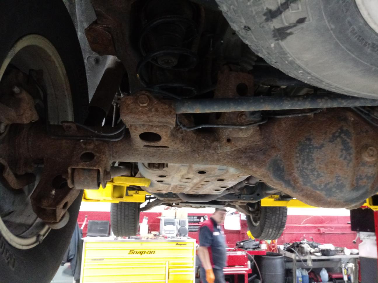

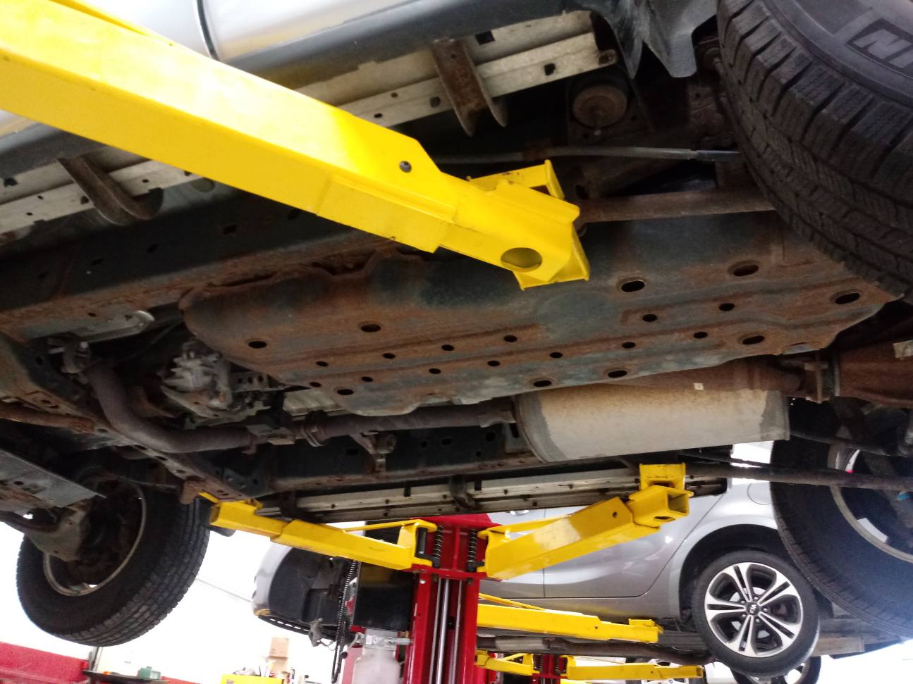

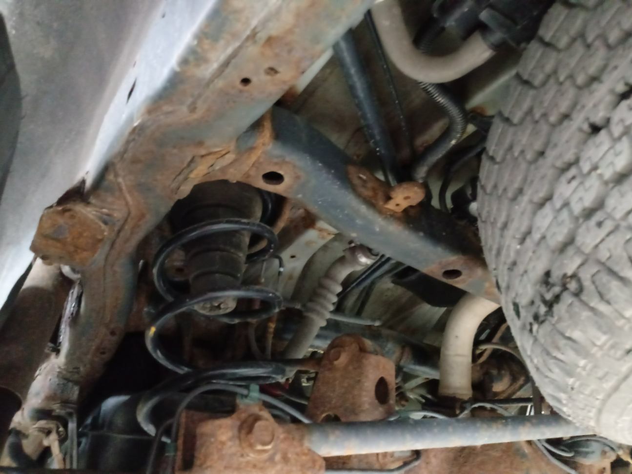

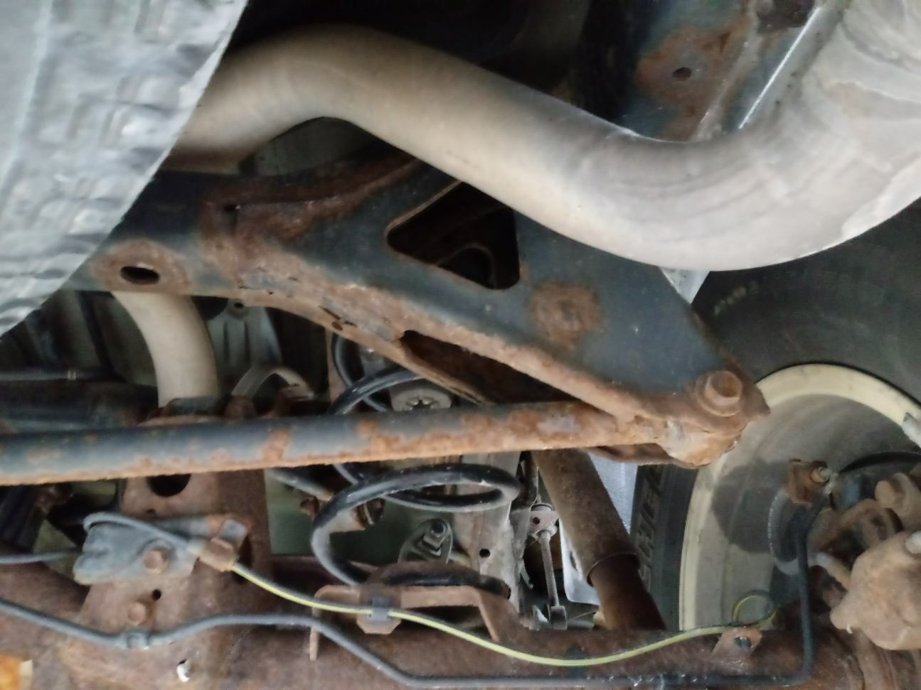

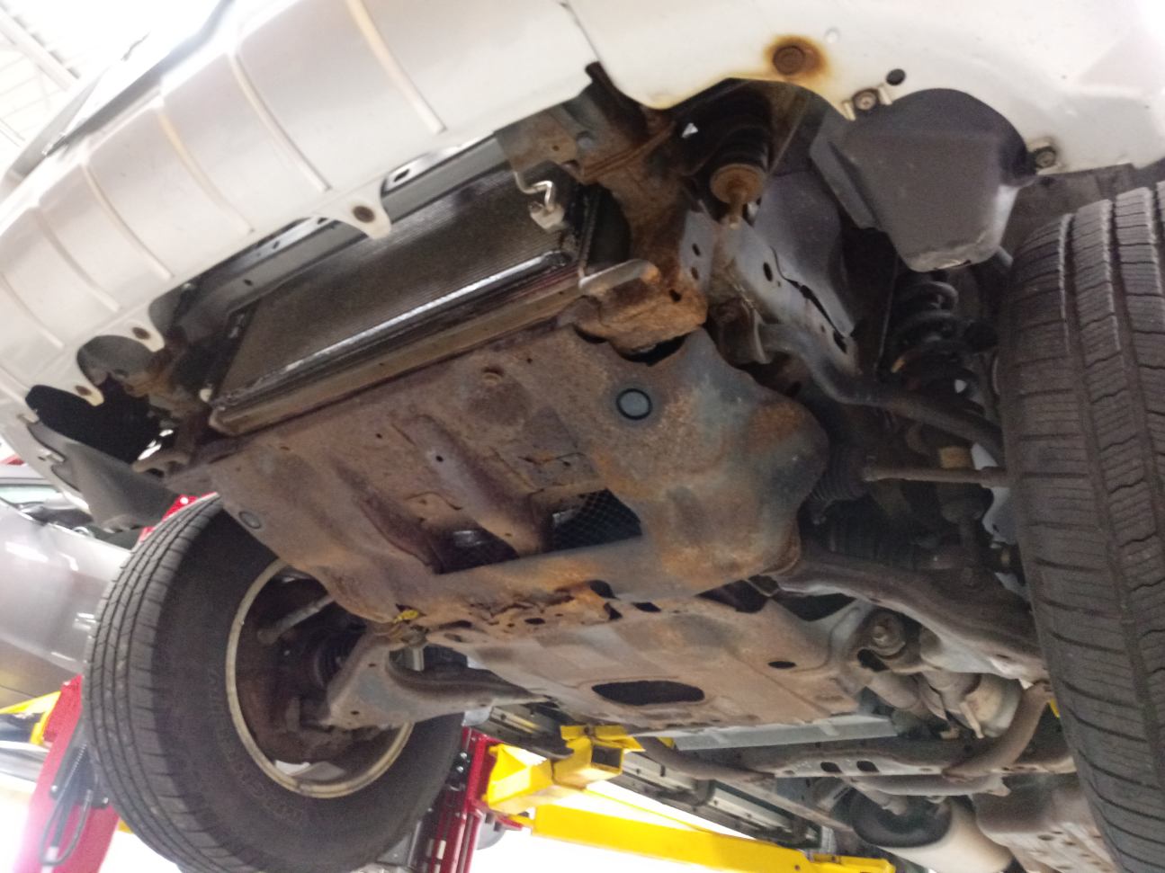

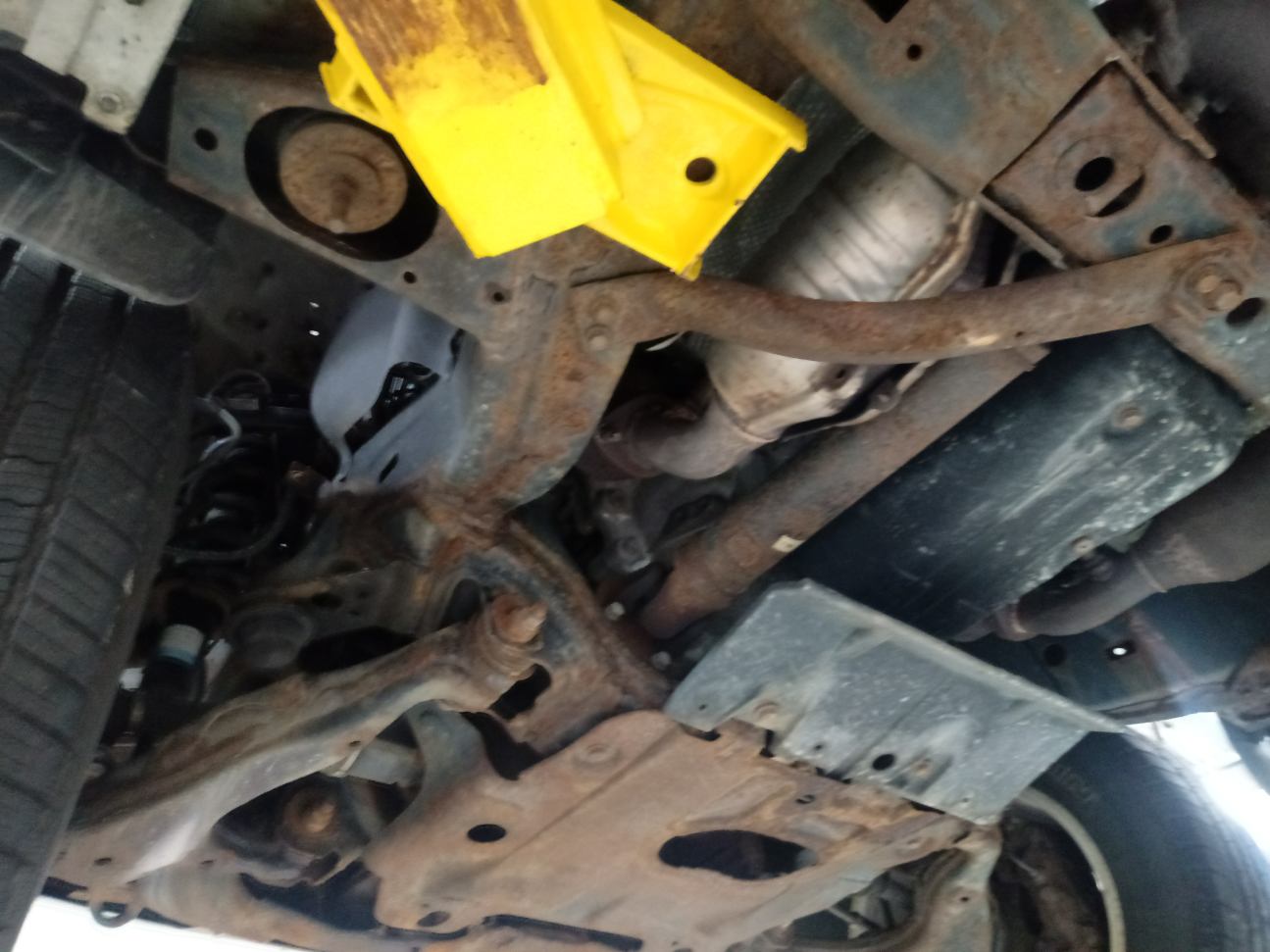

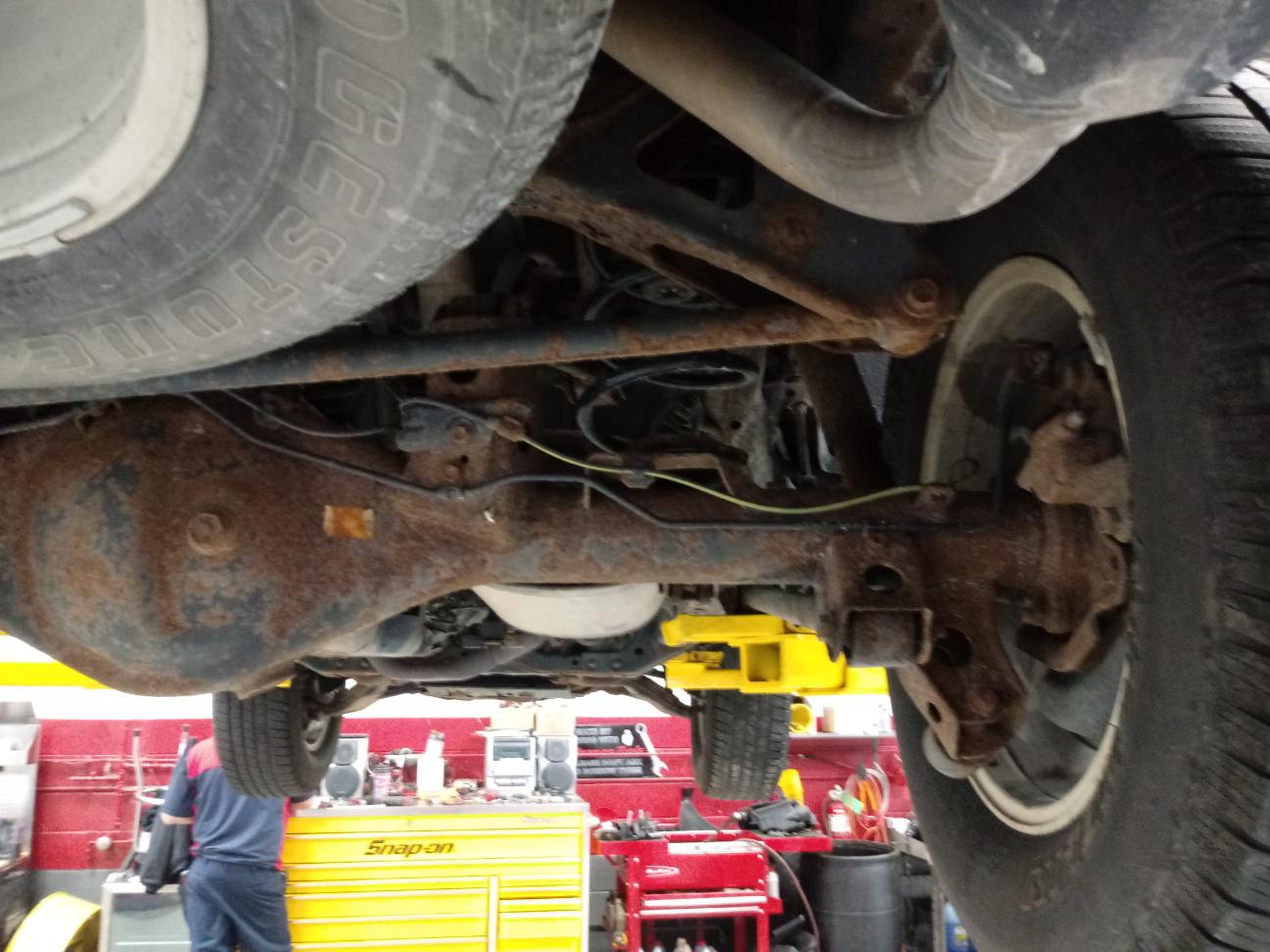

so im looking at a 06 sr5 with 150k now, its from the upper midwest so am concerned with frame/rust issues. its a couple hours away so seller sent me pics on a lift. has a little more visible rust than the 07 pics, lots of surface rust on the skid plates that could be deceiving, lots of what looks to be surface rust in nooks & crannys, one side of the radiator support looks pretty rusty but he says the metal is all solid. & the rear axle is very rusty, but these werent painted or protected were they?
i can wire brush the frame & coat with something like POR-15 or other heavy paint. its priced below book value & seems to be a decent deal based on prices ive been seeing for 06-08 4runners with 150k or less miles. any opinions on this one?

That's looking pretty bad, though not as bad as some I've seen on here. It might be structurally ok but if you have to fix anything dealing with all those rusty bolts will be a giant PITA. I'd keep looking.
Definitely better than mine, but I'd keep looking (I should have). Rust isn't anything you want to deal with, it's so much more work than it seems like.
The 04 I just bought with ~120k on the clock looked just like the one above with 150k and ended up having a shitty spot at the passenger trailing arm mount area. Still kicking my ass about that because I know better but getting it fixed this weekend. Regardless, if it’s got significant rust, run the hell away. Like people said, even if the frame is still solid it will make maintenance a pain, especially dealing with potential broken bolts, etc.

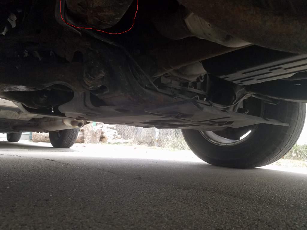

this one is a 08 sport with 143k miles, rest of the 4runner looks to be in nice shape & the underside is much cleaner than the one shown above, but i am concerned with 1 area shown in this pic... if you look towards to top left of the pic there is a square'ish area that i assume is the frame rail with rust & what looks like scaling or a loose layer of something that is coming off showing rust color underneath. is that just the paint/coating coming off? the seller says the metal is still solid but im curious/concerned what that area is & what could cause that type of rust. its the driver side front area of the frame near the crossmember.
i have other pics i can post if needed but mainly want to see what you guys think of that area i mentioned.

Can't really see it very well in the pic, overall the pic hardly shows frame at all. I can't really say if it looks good or bad, but given the condition of the components I can see fairly well I'd say this one looks pretty good. I'd check specifically on the passenger side top of the frame rail in the front wheel well behind the shock mount where the AC drain drips and all around the rear lower trailing arm mounts; they tend to be hot spots for rust.
yeah the pic isnt the best, but depending on your monitor & brightness it shows the rusted area & what looks like a layer of something flaking off. hard to tell what this area is in the pics but seems to be the main frame rail as it comes down from the engine bay area. but i could be wrong which is part of my questions... what is this area & what do you think the rust is?
i will definitely check the other areas you mention when i go to look at it, but im a few hours away so just trying to get some opinions from members/experts here before driving all that way to see it.
any opinions on that area pictured? hard to tell in pics & im not too familiar with these frames... is that just a coating flaking off or deeper rust issues?
