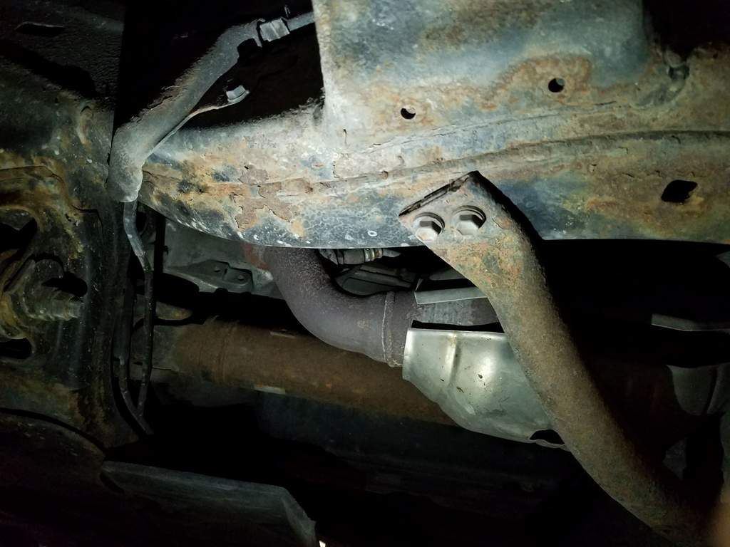

will be buying my 1st 4runner, what to look for?
any opinions on that area pictured? hard to tell in pics & im not too familiar with these frames... is that just a coating flaking off or deeper rust issues?
It does appear to be the main frame but it's impossible to tell the actual condition from that photo, I would request the seller to send you a good photo of that area.

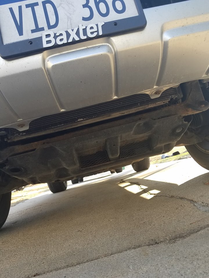

heres a better pic of that area & showing more. its in the dark with a flash being used which shows a lot of rust staining or discoloration, looks to be solid though metal though. & a pic of the front rad support area looks pretty good too compared to some ive seen. hoping its all solid when i go see it.

Defintely looks better in these photos but still has a lot of visible rust, hopefully it now to bad but still looks like it's worth checking out, I would take a big screwdriver and hammer with me to do some solid tapping on the more rusty areas to see how solid it truely is, also these frame tend to also rust badly on the inside of the frame, if you could pick up an inexpensive camera snake/borescope,endoscope to run inside the frame to really get a good idea of the frame's condition would be money well spent, IMHO, they have some that can work with most smart phone now, make sure you get on that has a light source to see better, these are also a good tools to have for maintenance and troubleshooting on any vehicle.

yes i agree it has some visible rust, but it looks to hopefully just be "surface rust" under the flaking paint areas. i dint see any real pitting or severe rust scaling etc like in the other pics of the 2nd one i was asking about, that one was terrible & enough to scare me away.
still cant believe toyota had such a problem coating these frames properly this late into the 4th generation. but if this one is still solid & mostly just surface rust i think i will seriously consider it if all else checks out ok. going to look at it tomorrow with my fingers crossed!
update on #3 4runner. i went to look at the 4runner & the frame looked much better in person than the pics posted, that area i was concerned with was just the factory coating flaking off with surface rust on the bare metal, no pitting or scaling at all, frame was still thick & intact everywhere beside surface rust on all the welds & other parts like the rear diff etc. & the rims had numerous big spots of the paint flaked off & heavy pitting/corrosion in those spots, never seen that on 4th gen sport rims, thought they were a polished aluminum & clear coated.
