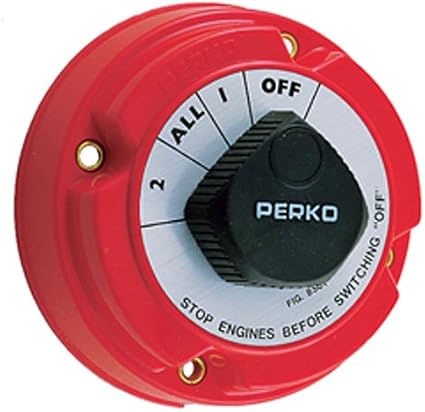

You can always do as they do in boats and add a battery selector switch.
When driving and using/charging it is in the both position and when camping or whatever it is in the 2 position.
That way the #1 battery is always charged for starting purposes etc.
If running low charge on the #2 house battery, just switch to both and charge it up with the alternator.
