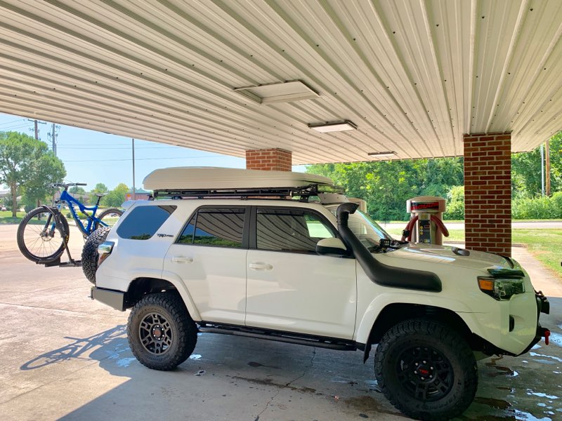

Really wanna see a pic of 285/75/17 KO2's! I know they prob run small, so even better, easier to fit!
See my sig, this was 2.25 of lift. Just had to trim a small amount of liner because of rub at full revers lock.
attached photo is 2.5 lift
Very nice! More pics please?! Very curious how the stance is with TRD pro wheels
I was thinking of getting some 8.5” -10 offset wheels to go with 285/75 but then that would make it rub more obviously. I currently also have the TRD pro wheels.
