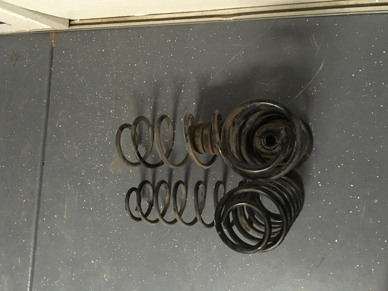

I searched to no avail. I'm going to answer this question, but don't need to invent the wheel if not have to. So will gen1 sequoia sr5 v8 rear springs fit a gen3 4Runner and will it do anything(raise, lower, help, or suck)?? I'm planning on getting 5100's for the back. Anyone with any knowledge, experience or ideas? I'm going to bring some stock 98 oem rear springs to compare with an 02 sr5 v8 2wd rear springs. Also will an 07 taco Trd off road 4wd cv axle fit a gen3? They both have 27 splines and look close. Again I'm going to compare and I will post what I find. Thanks
So the cv's I didn't bother with. The sequoia springs are bigger, 3/8's larger diameter than my rough country springs at the upper perch. I haven't fit them in yet, but I'm hopeful.
The sequoias are about the same height as the rough country. I put a pair of 99 rears on after removing the rough country and my rear has dropped an inch an a half. Hope to try tonight
Well I learned a lot from this experiment. I learned how to fully remove all the suspension from a 4Runner and that sequoia rear springs won't fit the upper perch at 6&7/8's wide it was about 3/8 to wide. All in all I'm $20 and 7hours down, so not that bad. My wife will disagree, but I think it was awesomeness and I cleaned/painted some people rust while in the area. Then changed a sway bar link.

I tried to squeeze those sequoia coils in, but the spring was wider than the upper perch by like an inch. The yard I frequent let me buy knowing I was putting texas into Rhode Island, so I was able to return no issue. The rate and height of the sequoia coils would be great for our rigs, but not worth the mod, because of availability of better coils that fit.
