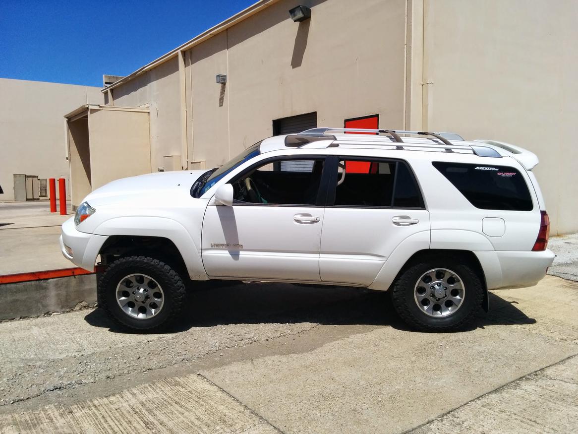

i run the trail teams/early 5th gen trail wheels and dont require spacers. The only time i rub is full up travel combined with full left lock in a forward direction on the frame.

I think these are by far my favorite, so how much more to they push out from the stock ones. Just an estimate if you can. My goal is really to get rid of the spacers, I make sure to keep them torqued but hate having that in the back of my mind. Your truck is sweet btw...

i want to say its about the same as the six spokes others are running, i actually couldn't run these wheels and spacers at the same time. the tires just rubbed the inside of the fender flare to much in just simple partial lock turns, so now the spacers are sitting in my garage. and the added benefit of no spacers is significantly less bump steer. and thanks, im considering a build thread but right now not much is happening and probably wont till after taxes.

Like mentioned above all fj cruiser toyota wheels are either .5" or .6" more than the 4th gen wheels. I really think its closer to .6".
