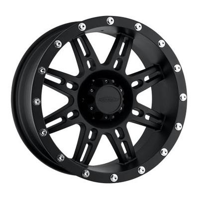

Anyone knows if this would clear a 231caliper? 16x8 procomp 7031 got a 4.5 backspace with a 0 offset I'm also running 1.5 wheel spacers.

Theres nothing wrong with spacers, as long as you don't mind the extra track width. When I had the stock split spokes, I used spacers to clear my 231mm calipers and have had no regrets
