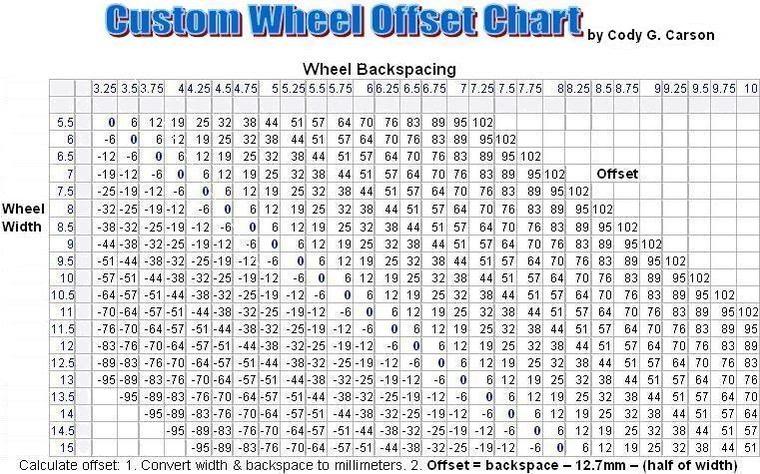

DannyLlama Elite Member Oct 27, 2012 #2 FloridaFeMan said: 17x8, 6x5.5, +12mm offset? Thanks in advance. Click to expand... Per this diagram you should be fine. Stock backspacing is at 4.5. This will put you at 5, which should be Ok. Attachments image.jpg 112.3 KB · Views: 504
