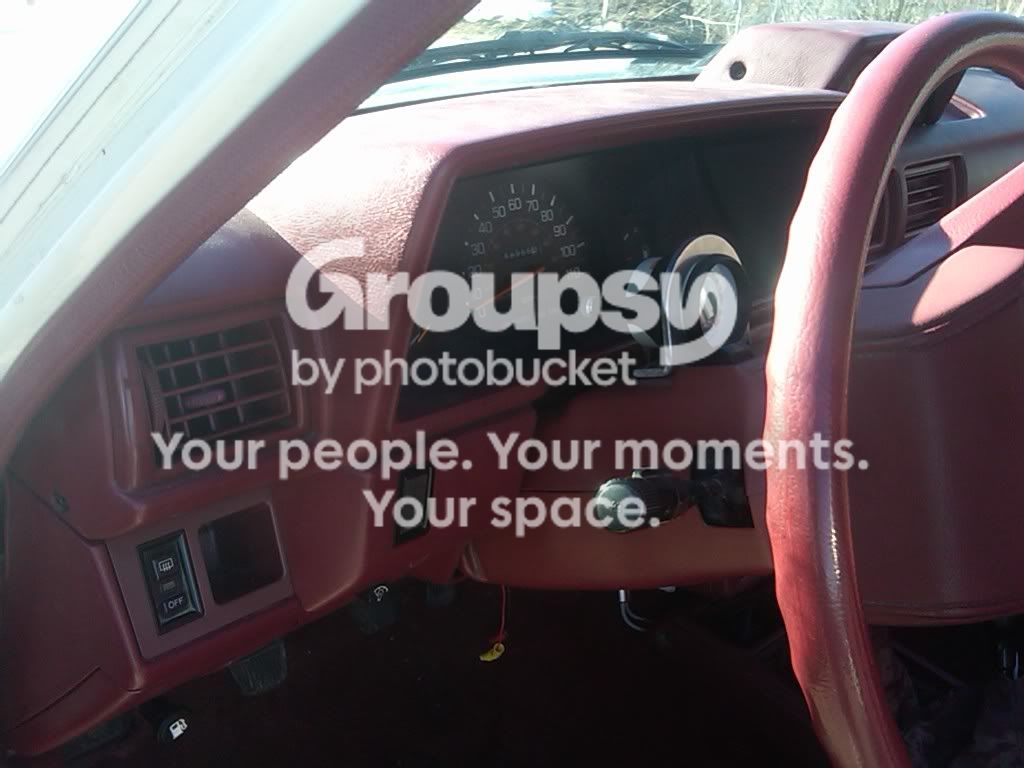

Will this cluster work???
Doubt that will even come close to fitting. Just find a cluster from a SR5 1st gen 4runner; that way it'll be a direct bolt in.
Tanner is 100% correct the 2nd gen cluster will NOT work in a 1st gen. not only are they shaped different the slope is also way different.
if you cant find a 1st gen sr5 gauge cluster another option is to do a mini tach next to the key release. i made a AFM pod for this location and it was super simple.
