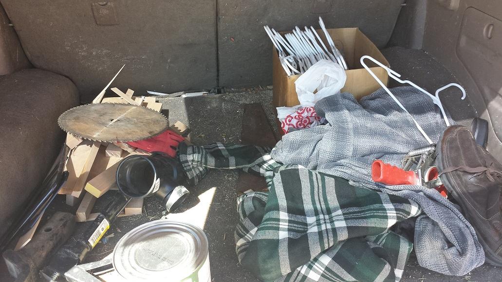

In the afternoon, I spent two hours dumping the trash out of the back. I had to be careful, because on the first load, I discovered that some of my missing tools were in the mess. Just a little pissed.

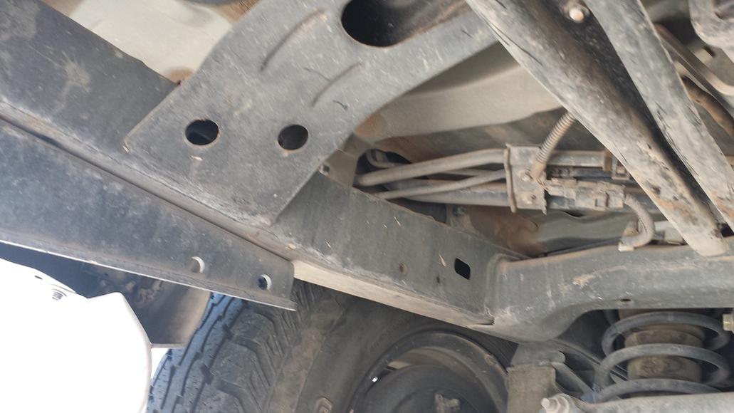

The front the end check indicated today that the work necessary is less than I thought and appears to be just the passenger side lower. I will do both sides, and it should be ready for the lift.

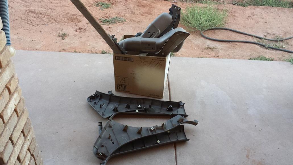

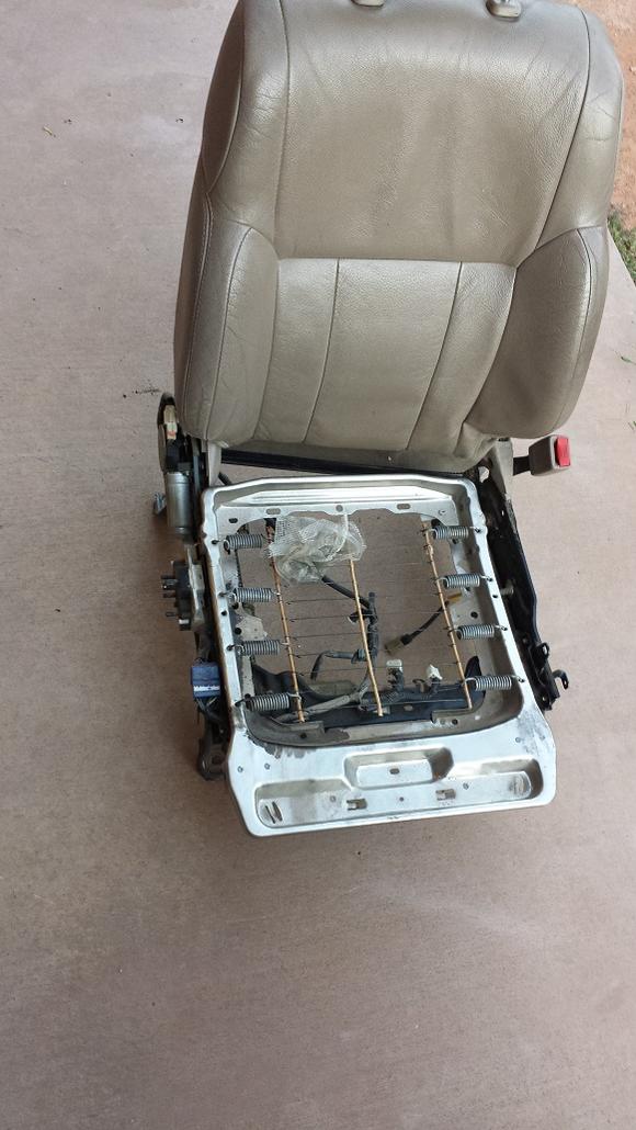

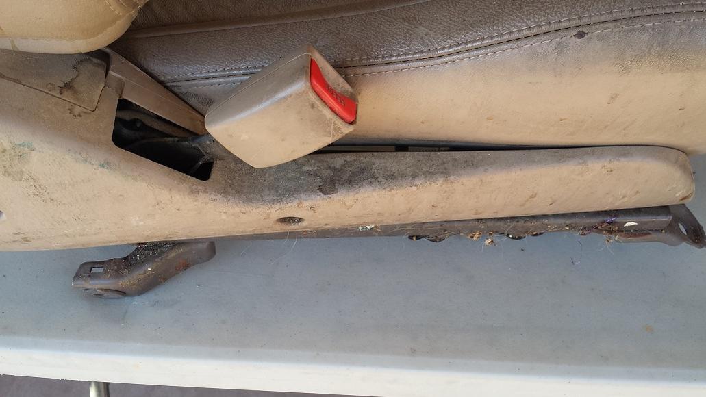

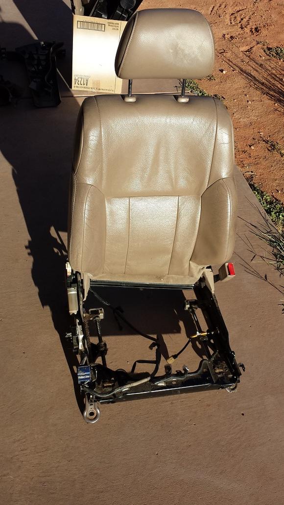

Today I pulled the seats, replaced the electronic control tumbler and keys...OUCh, do loose your keys, and if your tumbler start yo give you trouble, it is probably the Key, spend the 40 bucks for a new key, and save about 500.
The back story is instead of going and getting a new key, the kid removed the tumbler, threw it away and hot wired the truck, using the memory port of the key to fool the ECM. So new keys, new tumbler, and Toyota labour charges.

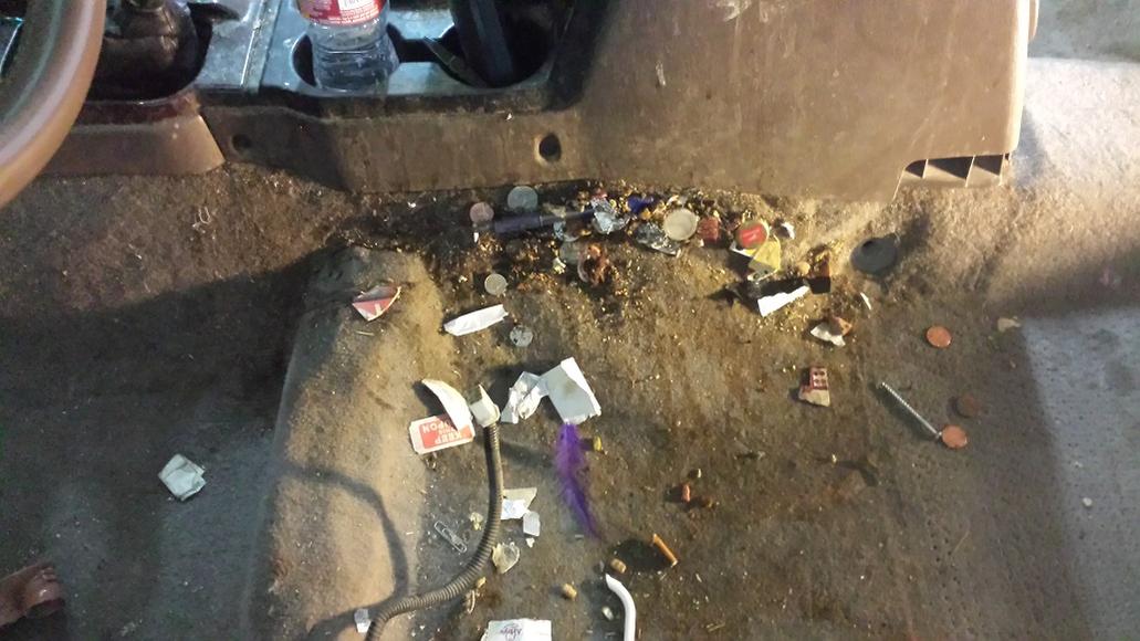

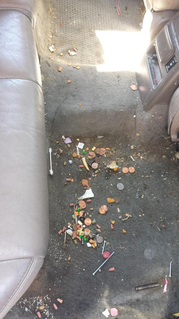

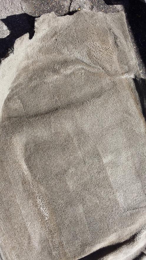

Well the seats are out and I am going after cleaning the carpet with a rug doctor and various chemicals I bought...it does not work, I will recover the headline and put in a carpet kit.
Here are a few crummy pics with more to follow later when my phone is charged and I have shower for an hour to get the that biker bar bathroom,(the women's, they are worst,) smell out of my pores...
Can someone tell me how I can size my pictures here with HTML, or is it required that size them before uploading? Can I delete them?

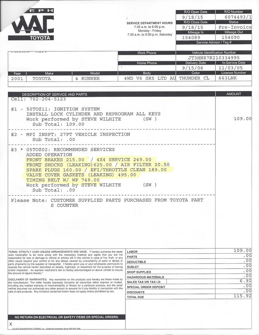

When I went to Toyota today, I talked to my parts man and told me he would match Dallas Parts pricing on anything I needed plus shipping. He also told me that same goes for Toytec for my lift, except no shipping...life is good, things are looking up.
As well, while the toiy was there, they ran a full diagnostics, and gave me a list of to dos on it. I knew every that needed to be done, but now I know for sure, minus the timing belt which I did already...this is a good tip if you are going to buy one, some dealers will do this for free according to my Toyota guy, check before you buy. See the list below, minus address and phone, as well as more pics.
The pics show the good bad, and the ugly.

Here are more Pics, it will be a good rig to rework...Tomorrow I will post some pics of the cleaning process. Not normally how I would tstart, but even standing next to this rig with the windows open makes me want to puke...I have been trying to figure out a description of the smell...it is familiar, and has been really bothering me...then it hit me...its O De refugee camp...otherwise known as an inter city grey hound bus stop.
By the way, the pics are after a few ours of cleaning...4 shop vacs full...

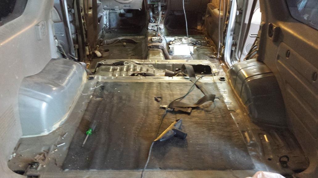

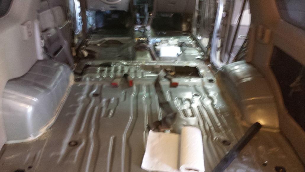

I rented a rug doctor and attacked the mess today. I have experience remodeling and flipping houses that have been treated poorly, or had cats abandon in them so I grabbed my favorite tool, and my chemicals and went to work today.
12 hour day, and I am almost done. I need to rinse the inside one more time, and replace the carpet, and do some minor detailing.

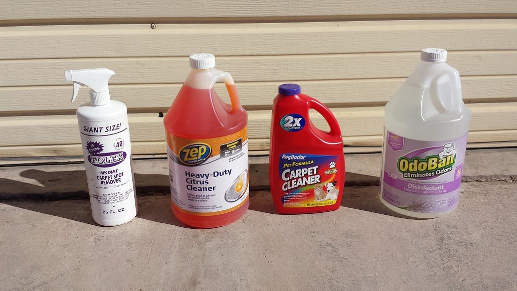

I used the same odor chemicals I used on the carpet with the rug doctor hand attachment on the headliner and the in whole interior...no more smell and clean as it can ever be.

Took the old seat covers off and cleaned interior plastic parts. Tedious but necessary work.
Will have to wait for the new seat covers to be made, and I have to wait for the lifting parts as well. Haven't decided whether to do the lower ball joints and brakes now, or wait until I get the suspension parts and do it all at the same time.

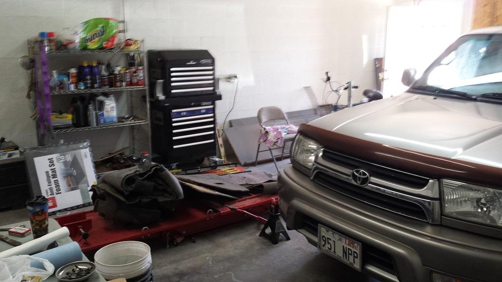

I also cleaned my shop and figured out how I going to place my counters, and shelves. I have a neighboring shop that does granite countertops and they gave me about 25 feet of like new Formica countertop. I have been putting off installing them, but decided while I wait for parts, I would get that done as well as some shelving.
I sold my 2 nd gen to the neighbors kid for what I have in it. I bought it for 1200, with a rebuilt engine, and trany that won't shift electronically. All it needs is sensors, I have done the trouble shooting. He is also getting a hybrid bumper, and for extra doors as well as all my stock of 2nd gen parts. His dad is a cabinet maker and her is building my storage system in trade for the bumper...He got a great deal, as the interior of this rig all works and is clean as a whistle.
Tomorrow I finish the counters and shelves and then take the toy to the car wash, rinse the inside, and wash thoroughly the under carriage and suspension. Will do this on a creeper in shorts to ensure I get it really clean and also will look for any detail underneath I missed. The best part is since I have the interior removed, I will drive it sitting on a folding chair...I miss my pressure washer and lift...
Day 9

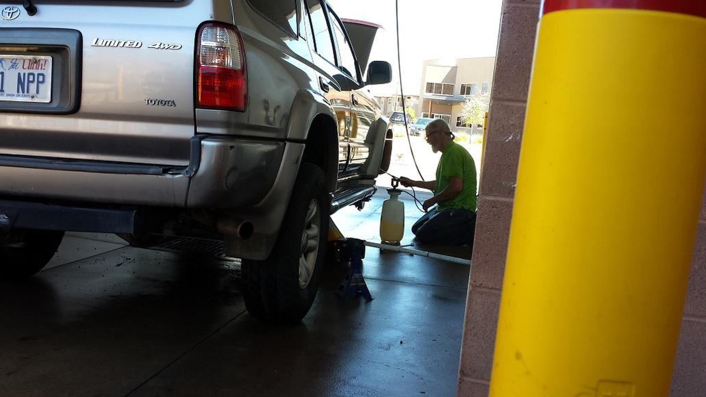

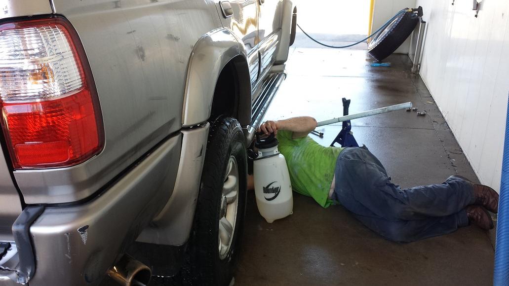

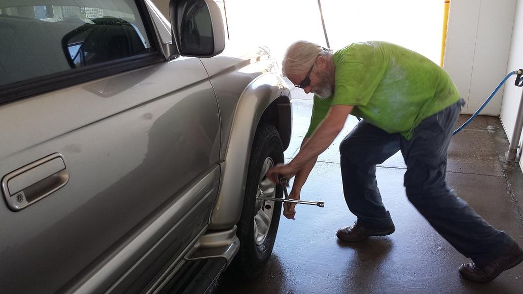

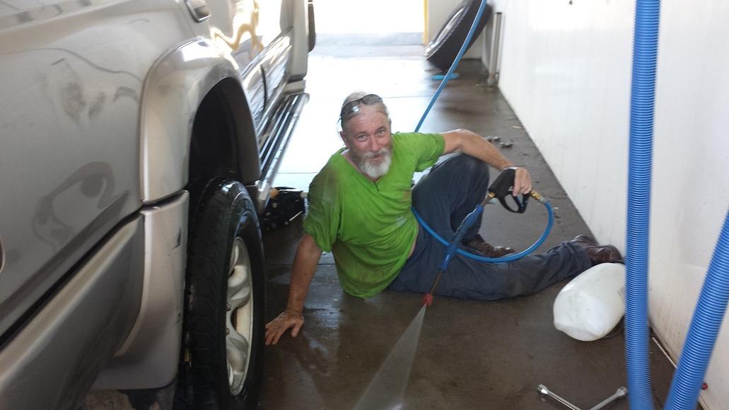

Drove the toy to the local car wash sitting on a tackle box. I lifter it one side at time and removed the wheels. I used a mix of detergent and degreaser to pretreat the suspension and underneath. I then used the engine cleaning solution to clean the engine. I do not know what they are using at this car wash, but it is about the best stuff I ever used. Used the same solution underneath while laying on my back. Retreated the suspensions with it as well. On the low pressure setting the grease was falling off...really good stuff.
I then did the other side. Finally I rinsed thoroughly. In all I spent about 4 hours and 50 bucks, but I can now see everything, and its clean...
Any leaks will reveal themselves and I save time, by having a very clean rig to work with.

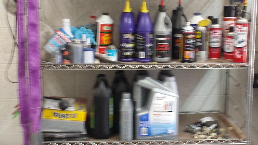

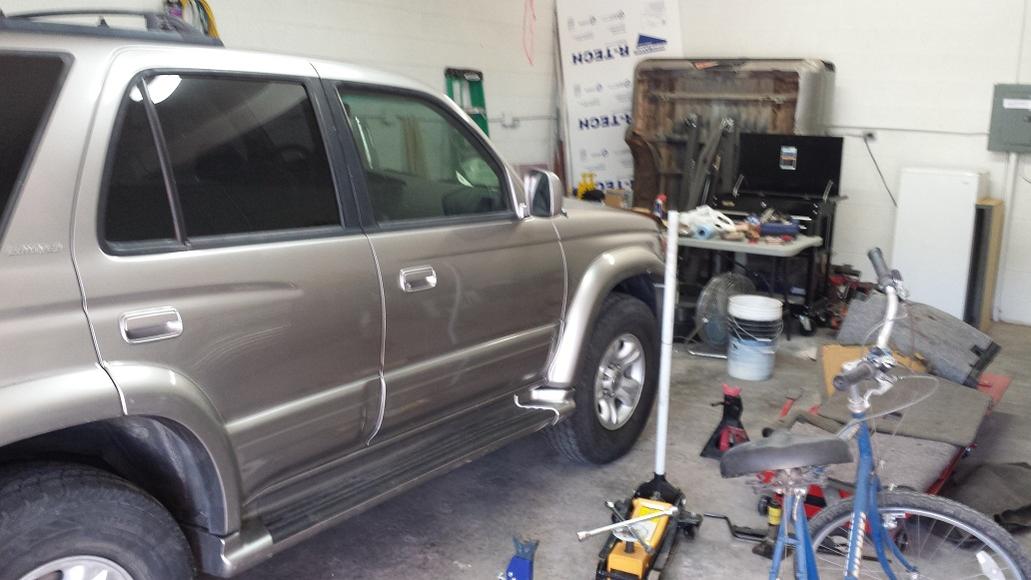

I threw in a few pictures of my messy shop.

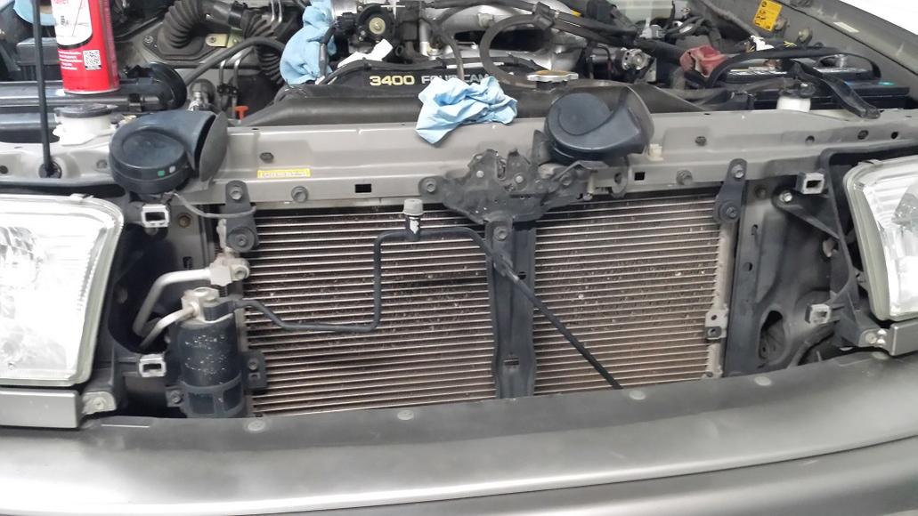

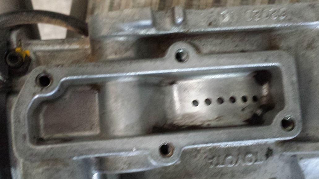

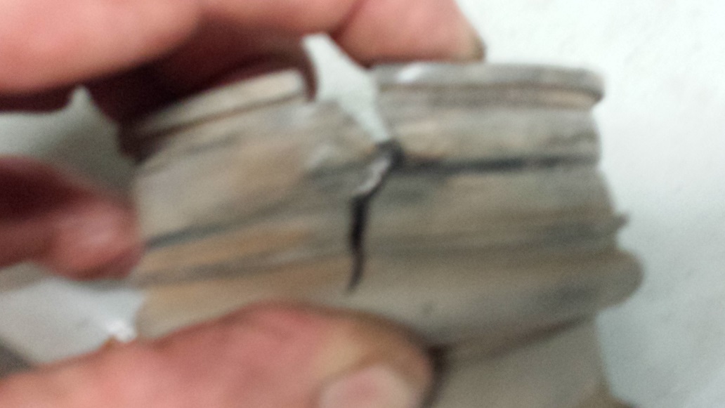

Spent the day prepping the toy for transmission cooler install and flush, cleaned the throttle body, and PB'd the all the front suspension, and inspected the brakes.
Decided to put new rotors and pads on the brakes, while they are serviceable, I figured I might as well put new rotors and pads on while I do the Toyec Boss install, so I will.

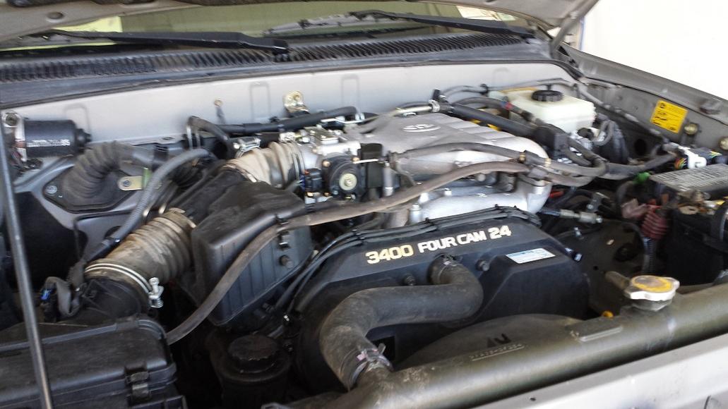

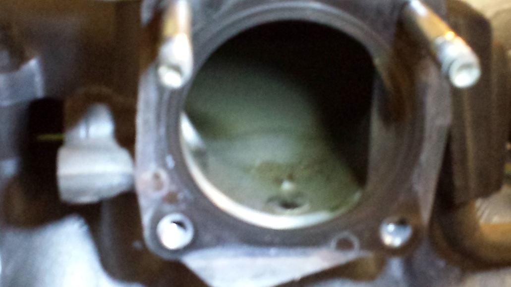

The throttle body was filthy, but the intake manifold did not look so bad, so I did not pull it. I will use royal purple fuel treatment and I think I will be ok. I noticed the intake parts were dry and cracking so I will replace them. I did not think of taking pictures until the throttle body was almost clean, but the two I added will give you an idea of how bad it was.
Removed the grill and cogitated on the cooler install. Going with the B&M 70264 SuperCooler, but have not decided on whether to use a fan or not. Will place Magnafine filter in the hot side of the trans lines. I plan on using the pump method that is in this youtube video <a href="https://youtu.be/WngXE_7vg-Q">PUMP flush</a>

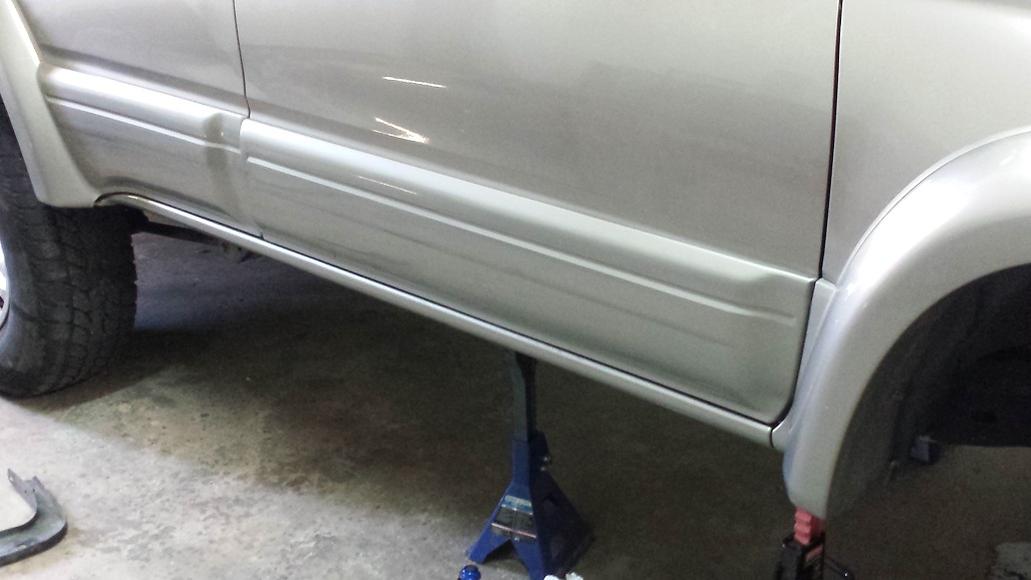

I removed the limited running boards to make way for sliders, when I ran out of things to do as I wait for parts.

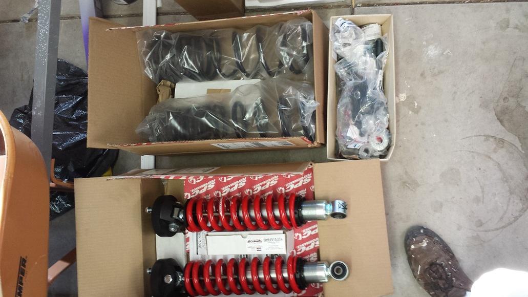

Day 10 Addenda
My lift and suspension parts came in today, at about 5 pm, so tomorrow I start on the front end lift.
