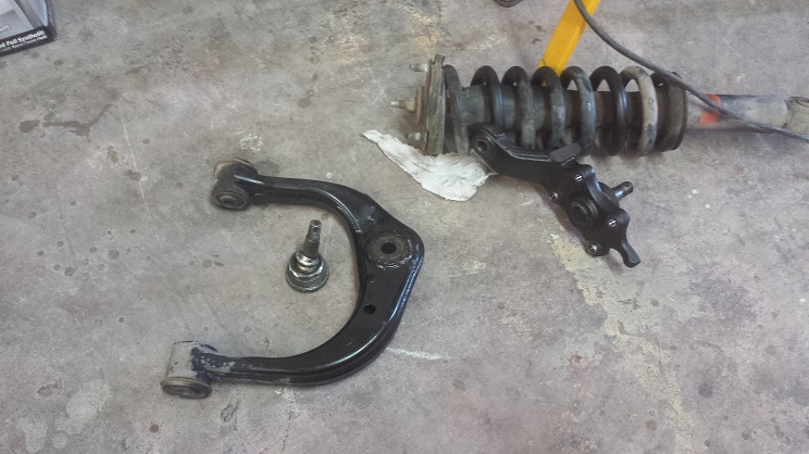

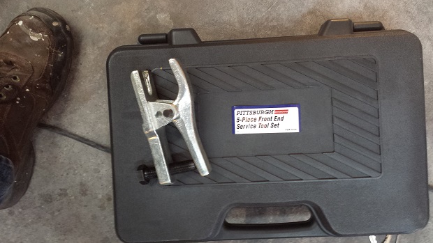

Frustrating day. I had an upper ball joint that simply did not want to come out. Heated it beat it, bought a Pittsburgh puller set form Harbor freight, heated and beat it some more and finally after hours of using every trick I know, it came free.
I was using a the ball joint puller in the photos and it lets loose with explosive force and puller hit my hand. I had safety gloves on, but it still hurt, and it left a mark.
Tomorrow is another day. Here are some phots of my set up and the guilty puller.

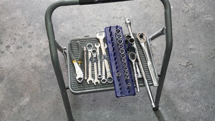

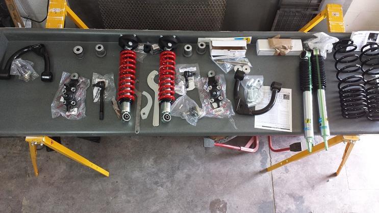

All the parts are laid out left and right side. (Who can catch the mistake?) One of these days I am going to get the 30 feet or so of salvage countertop mounted on the walls with supporting legs for my vise and anvil.

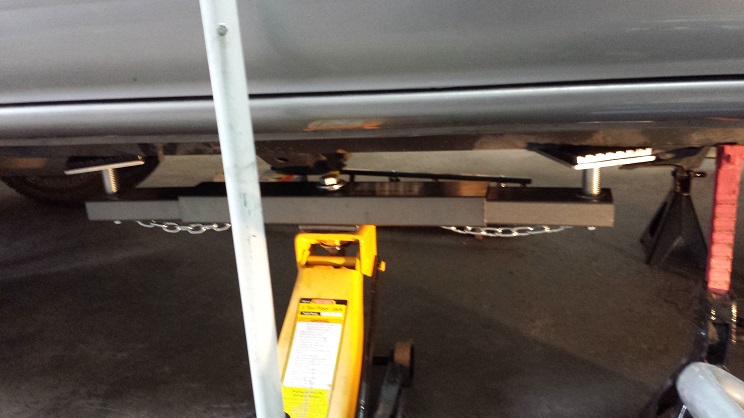

The truck is supported both on my beam jack and multiple stands. Safety is paramount, if you expect to go wheeling when the job is done.
Safety glasses, safety gloves, are part of the necessary tools.

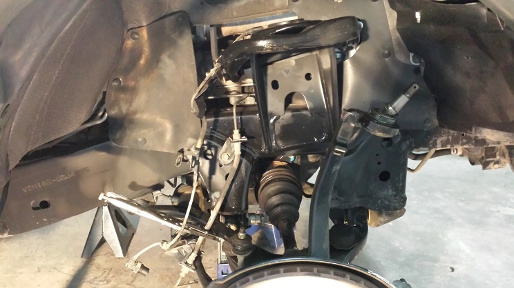

Day 13

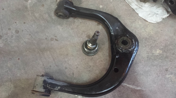

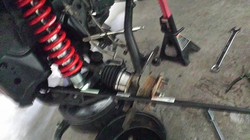

Today I finally got the upper ball joint to let loose, I used a portable ball joint and an impact hammer. Not the way to do it, but my only choice at the moment. I made my wife take shelter in case it exploded and threw pieces everywhere. Sometimes I do things that I would beat my sons for doing...After I got it out, I made up my mind that I will find floor press as soon as I can.
The press is going back to harbor freight. To date it is the first harbor freight tool I have bought that I was completely unhappy with. The tolerances were so far out that nothing fit, increasing the chances of failure under load.

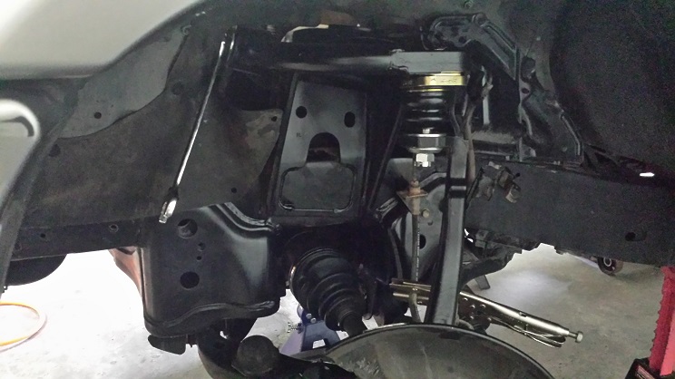

The pictures below show several things. One, I made headway in spite of my clear mistake. Can you see it?
Another mistake I made was not dropping the differential first, it my the job more difficult, as I had to use a pry bar and major force to get the shock attached to the lower. When I got it in and looked, I could see my mistake.
The set is in, but I have to do my propeller shafts before I button up that side. I picked up a set of NAPA new for 76 bucks and set up an account...they deliver daily to my neighbor and now to me.
As well, my land lord is moving me in to a new shop with an expoxy floor and fresh paint, it is slightly larger. She is keeping my rent the same, which is $275, plus 120 for my yard storage with is about the space of three buses. Getting this place during the recession and being faithful and on time has paid off!
When I do the other side, I am thinking of doing a video, (since I have made all my major mistakes, and I post it if I do.

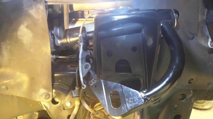

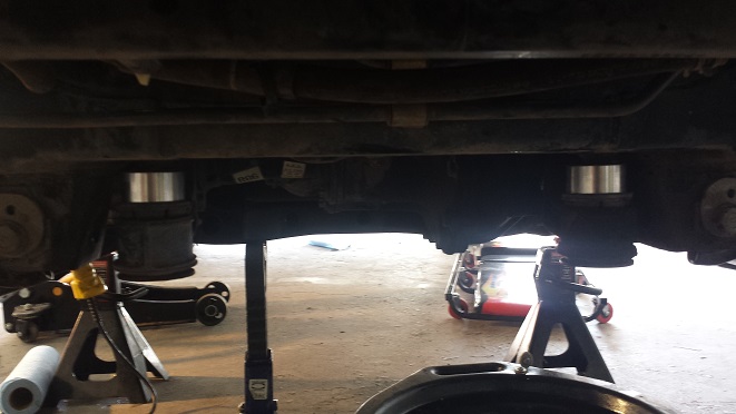

Day 13
I dropped the diff, and installed new shafts today. Then I did a brake job, sans vacuum bleed. I will do a vacuum bleed flush when I get all the brakes done. One side, up front, complete. All bushings, and tie rods replaced and lift installed, roughly aligned. I am waiting for the links to be made and mailed I will do bushing for stabilizer then.
I love the Boss lift so far. There is a bit of a learning curve for my on this third gen, but I am confident I have learned a few tricks and the other side will go faster.
I was pleased to see a very little metal shavings on the diff drain plug, and the oil was fair.
I cleaned the shop and started getting ready for the shop move Thursday. Its going to be nice to have an epoxy floors, a sealed garage door, and new countertops. Not to mention getting everyone else's shit out of my shop. My new rule is you can leave your stuff for a day, but then it gets stored on my storage yard in the weather, that's heat for you easterners...

Day 14

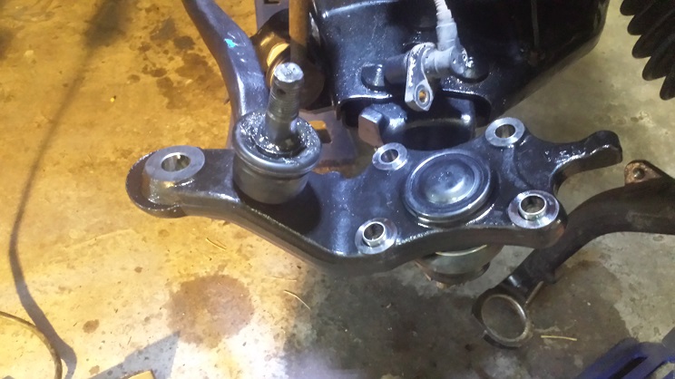

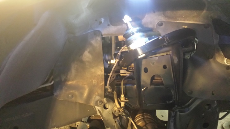

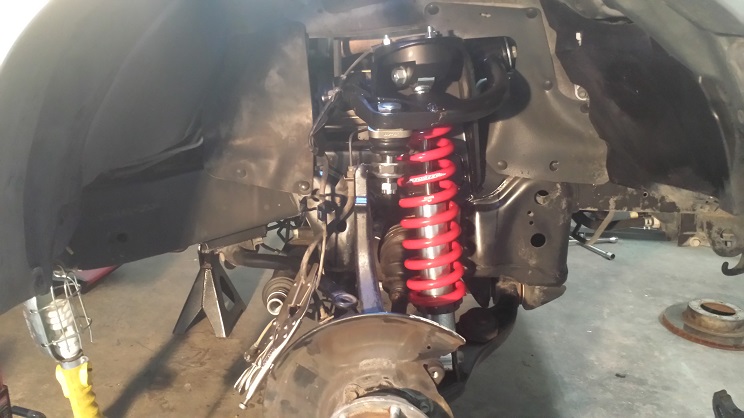

Today went very well, the gains based upon the learning curve on the right side, help me immensely on the left.
Some of the learning curve you simply cannot document as it is happening, you take things off, only to discover it might be better to remove them in a different order, or you bust a knuckle, and like a hot stove you say "shit that hurts, I ain't doing it that way again". Mostly though its order of operations and on the first side I experimented to figure out quicker methods based on the order of operations.
Of course on the first side I had a ball joint from hell. I am sure the sst would have made the process a little easier, but as well I know it still would have fought my like a 500 pound Tuna.
I did come up with a way to remove the upper ball joint today that went relatively quick. First off while dissembling, I took the knuckle completely off, I did this last after everything else was disconnected and removed. I then replaced the propeller shaft. and took the knuckle to my bench.
I then used a standard ball joint puller to remove the upper, but I did it with a twist. Instead of sleeving the bolt end, I removed the driver from the clamp screw mechanism, which leaves a hollow void, placed a round flat base,(the one that has the lagest hole,) over the bolt, and inserted the end of bolt in the hollow end of the driver. The base plate fits over the sleeve of the joint and is very stable, no trying to hold all parts while you begin to tighten the clamp. I then sleeved the other side of the joint and used an impact hammer, set on a low setting, to drive out the joint.
It all took about 20 minutes.
Everything is basically back together, minus the front strut. I will have to install it in the morning and go back over and check all my torque settings ensuring I have it right. I found and printed a copy the torque settings sheet in the third gen information and it is in my ring binder along with the sections of the FSM I need. I have decided that I am going to buy a paper copy of the FSM to carry in one of my seat pocket. For a 132 busk, you can't go wrong...its a steal.
I did make one major mistake yesterday, which I discovered today. The left tie rod is on the right side. Five minute swap, but a possible disaster if I did not catch it.

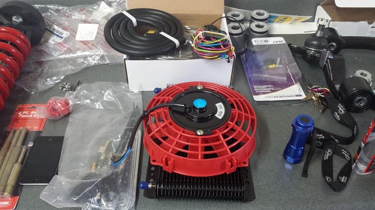

Finally, end of the day, I laid out my transmission cooler fan, and thermostat set up and spent a few moments cogitating how I will install it.
Photos follow.

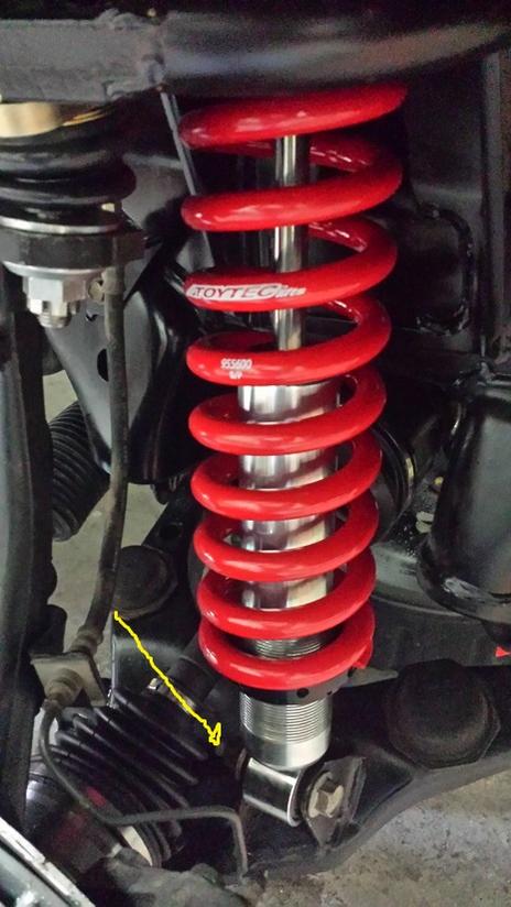

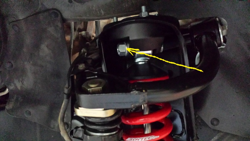

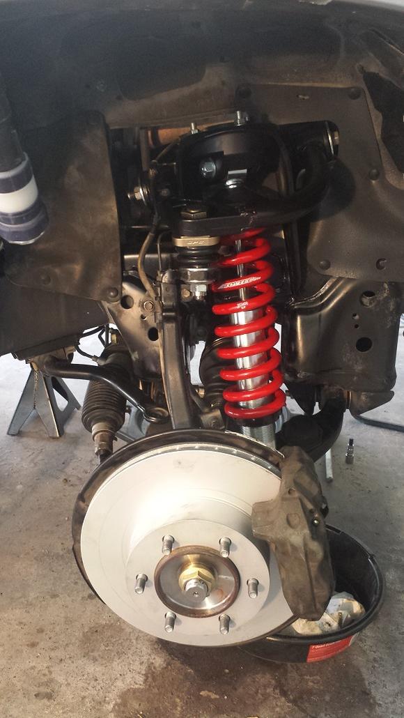

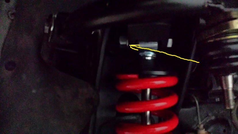

I did install the strut on the drivers side. I was not happy with the appearance and called ToyTec for advice. They are very proactive about giving assistance and advice, I think they are a good company. In fact the tech invited me for a visit, and I will visit next time through there.
My problem was that the bolt on one side faces forward, and on the other back. I attached photos. I was not sure if I was doing something wrong or not. Apparently it does not matter, but can be either direction. I will swap it so bolt heads face forward.
As well I was told the lower bold head should be on the shaft side so that the there is not chance of the bolt contacting the shaft boot. I will change mine tomorrow. I have a pic of that as well.
I also included my method of forcing the lower down to install the strut without help. I think a bolt fid, would come in handy as well and I will have one the next time.
