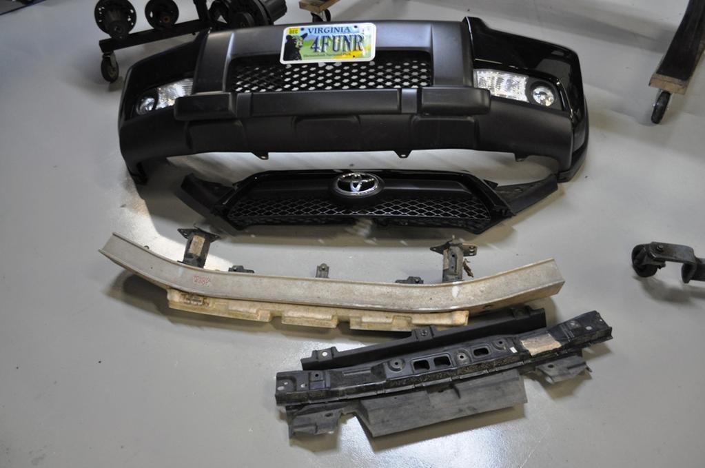

...replaces the aluminum bumper, so not a huge weight increase.
This is what I don't like about this design. You lose a good 8-10" of front end protection on both outside ends of the frame rails without the aluminum bumper in place.
This is what I don't like about this design. You lose a good 8-10" of front end protection on both outside ends of the frame rails.

Most, if not all, depend on the mounting location for the factory front crash bar to mount the bumper, winch mount, or whatsoever.
I have yet seen one that keep that in place. (Your imagination stays as imagination. :yield:)
the 14-15 bumper is smaller and doesn't look like you loose much coverage compared to the undercover. The Tacoma bumper pretty much ends at the mounts too, so they didn't lose anything with the winch mount. Hoping we get enough for the discount, It's about $700 without it.
